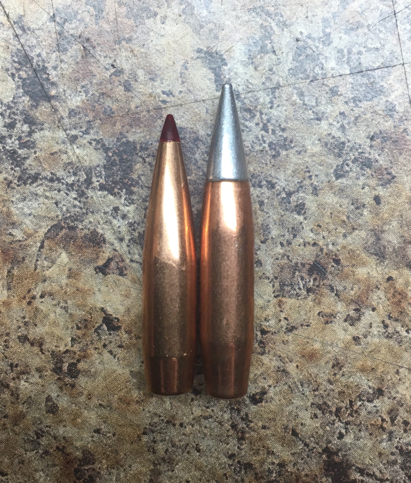

I’ve been running the Sierra 160 TMK through my 7-08. Haven’t had a chance to play with the 180’s. The TMKs are running around 2810 fps with Varget. There’s more room for speed but that’s just where I settled at. I have some old Hornady 162 Amax with the aluminum tips I want to play with. The BC is around .710, should be fun but they are super long.
Chanlynn barrel @ 26”
L-162 ELDM, R-162 Amax
