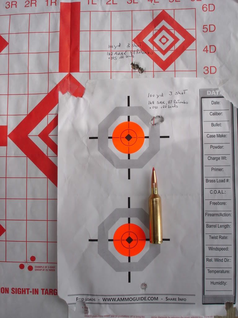

I have a 338 Lapua 35 deg imp with a .366 neck that does very well in a 7mm that would be a .312 neck I just built a 7mmX338 35 deg Norma with a .314 neck that is looking very promising and will be back at the range tomorrow for more testing.My 338 Lapua case holds 121 gr h2o to top of neck,(7mm would be less) and the 7X338 Norma 35 deg imp. holds 110 gr. h20 and the 7RUM holds 114.Hope this helps.
Ken
Clearwater Precision
NRA Life Endowment Member [img:center]http://i220.photobucket.com/albums/dd181/krlemas/7mm338%20Norma%20Imp/DSC01307.jpg?t=1266436333[/img]
