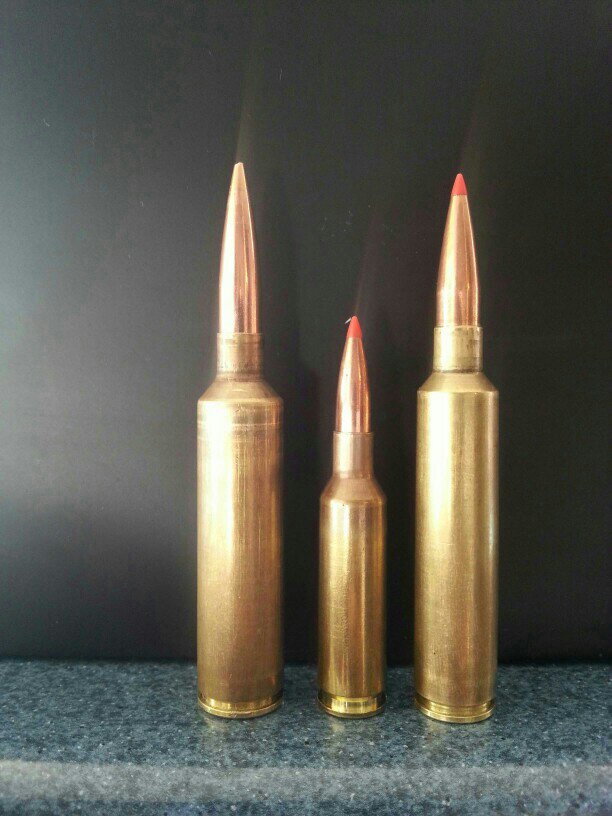

Have done a few on the Norma case in 7mm all same design as shown.
3300 with 180 hybrids from a 26 inch barrel for a hunting rifle going to shoot a lot of animals/trophies so what's barrel life matter they are still making them.
7mm screamer (Norma imp)
6x47 lapua for size
7mm gonzo (based off the 300 Blaser mag case) will push the 180s mid 3150 out 26inch
