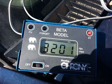

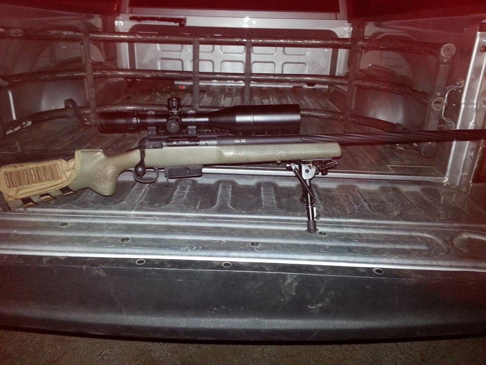

greggrissom: I hit 3201 with the 150 ablr today with 55 grains of IMR 4350. I use a 28" 9 twist krieger 5r with brake. The overall length was mag length 2.956". Pressure signs showed up at 56 grains. I did manage 3257 with the 56 though. the 54 grain load at 3100 ish was the most accurate with 1/4" group at 100 yards. I'm gonna load 100 rounds now of 54.5 IMR 4350 to finish breaking in the barrel. The barrel is new so I expect some things to change and possibly the velocity to rise. I believe I've stumbled onto a good combination of powder and bullets. I used winchester 284 brass and wlr primers. I haven't found a single soul on the internet that uses IMR 4350 with a 150-175 gr bullet in 284. I wonder why that is. It's turning out to be a hell of a performer for this application. I wonder why more folks haven't tried this more often.
