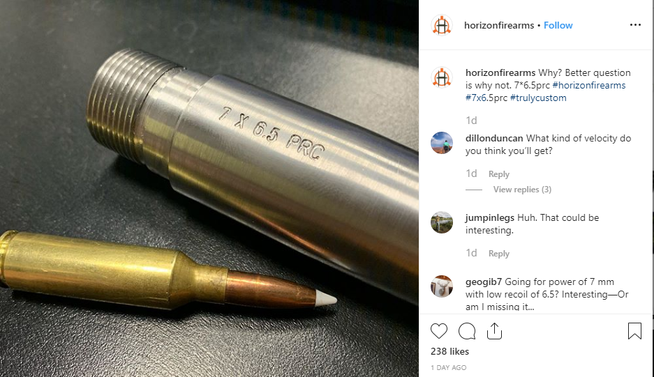

I'd like to see how this is going to run
