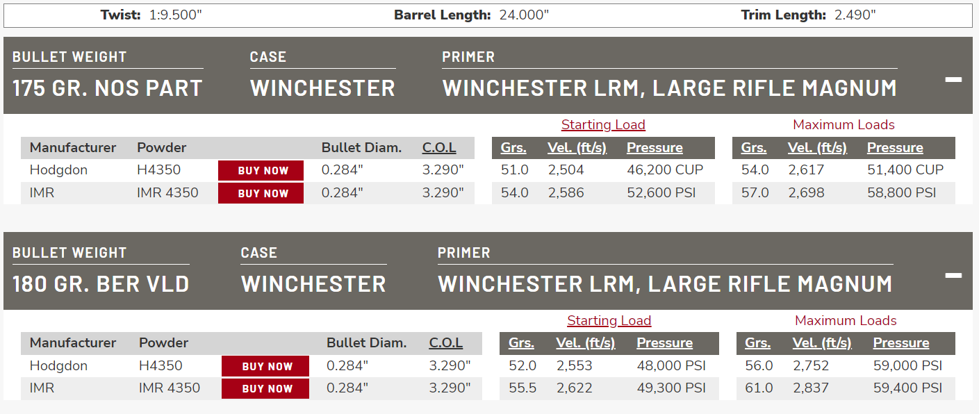

These will give you a rough idea.
Try not to assume IMR 4350 and H4350 are identical, you can see below they are close but not identical.
The specific bullets are shown, but Hornady 10th doesn't show IMR or H4350 for the 175.
Reactions: AbeS
