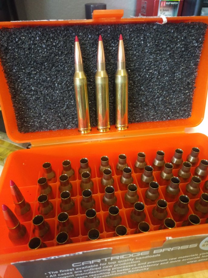

I use R-P brass and ADG brass with 215m primers. I shoot 168 MKs, 168 Berger VLD Targets, 175 ELD-x's, and even 183 Matchkings... yeah my 9.5 twist doesn't fully stabilize them to take best advantage of the BC, but, hey, it's still accurate and fun enough. I have about 1500 of the 183 Matchkings taunting me to get a new barrel.
How is the new ADG brass?
Badass. You need it.
