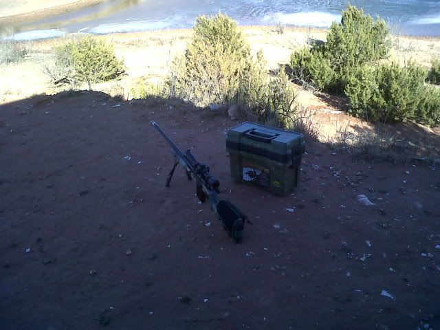

Welp went out today and put a few rounds through it. Didn't really get to shoot groups much, but fired quite a few rounds. Zero'd at 100 with terrible shooting Remington ammo. Didn't have many handloads so didn't get to really test 'er. I did get some steel hits at 850 with the Remington loads! Pretty damn fun! Here's some pics of our farm...
