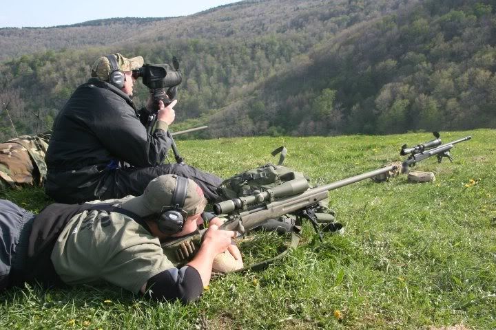

If you are going to do a 7mm on a long action, go with the WSM. That way you can seat the bullet way out in the neck, and you will get better speeds. Just make sure you have your gunsmith use the right reamer for the bullet you will shoot.
I got my first gun with a Mcmillan A3-5 stock and love it. I have held a few A5's but like the A3's. I would talk to the guy that your going to get the barrel from on fluting. I think you can flute any barrel.
Here is a picture of my gun. Hope this helps.
