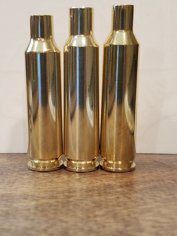

As mentioned above it is essentially a 7SLR, simple pass through the die and your loading SAW ammo. I will look through my odds and ends brass bucket from comps and see if I have a piece of SLR brass to take a side by side pic.
Left to Right
6.5 Creed, 7mm SAW, 6 SLR

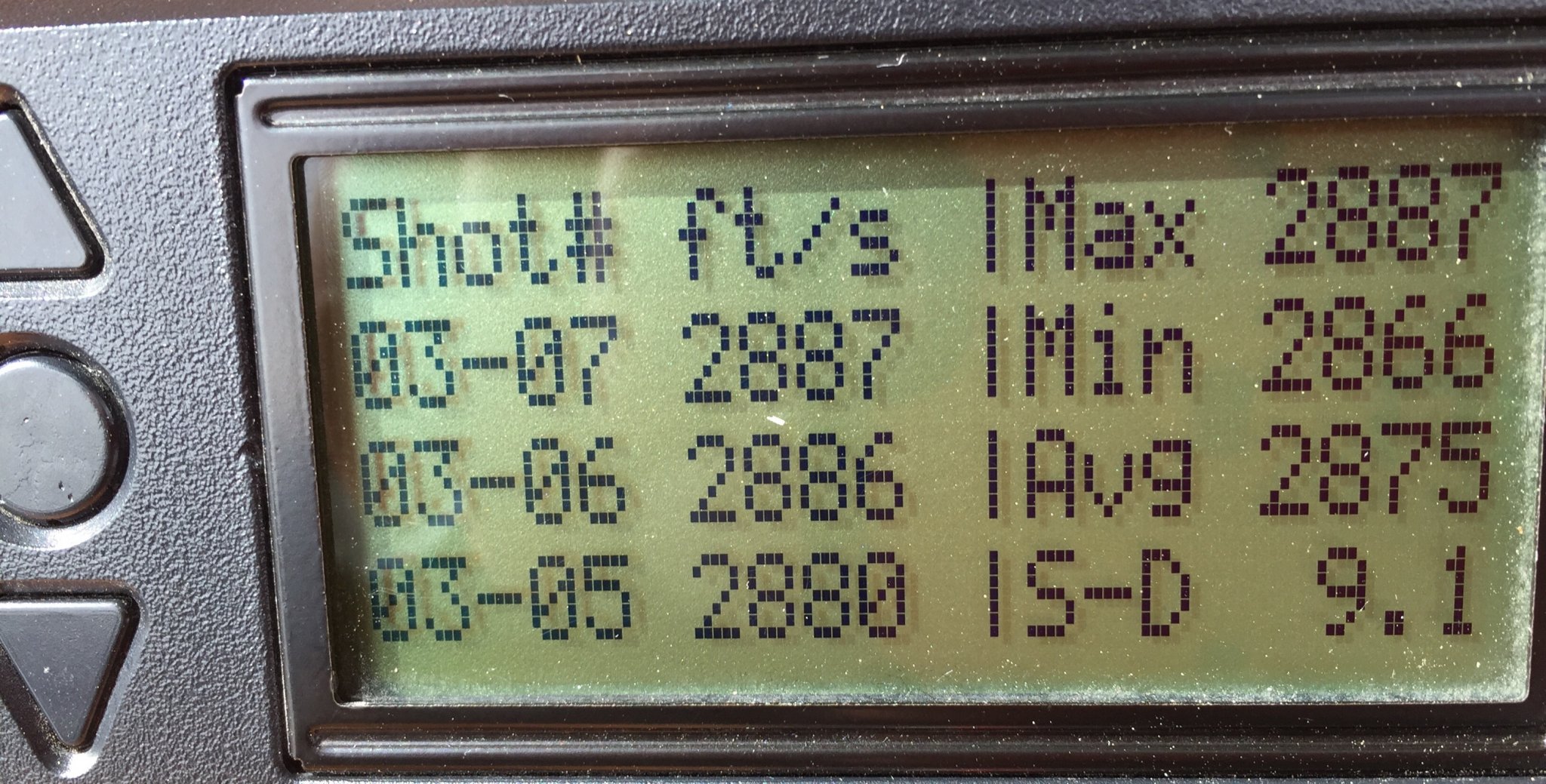

Did my first work up after a bit of break in with h4350, 162gr ELD-Ms and CCI 400 primers. 24" barrel with a silencer. I could have gone up another half grain but things were already getting pretty compressed. Nice little node at 46.3 though, need to try some varget or maybe reloder 16 soon and see if I can't get the velocities up a bit. 2800s not too shabby though.

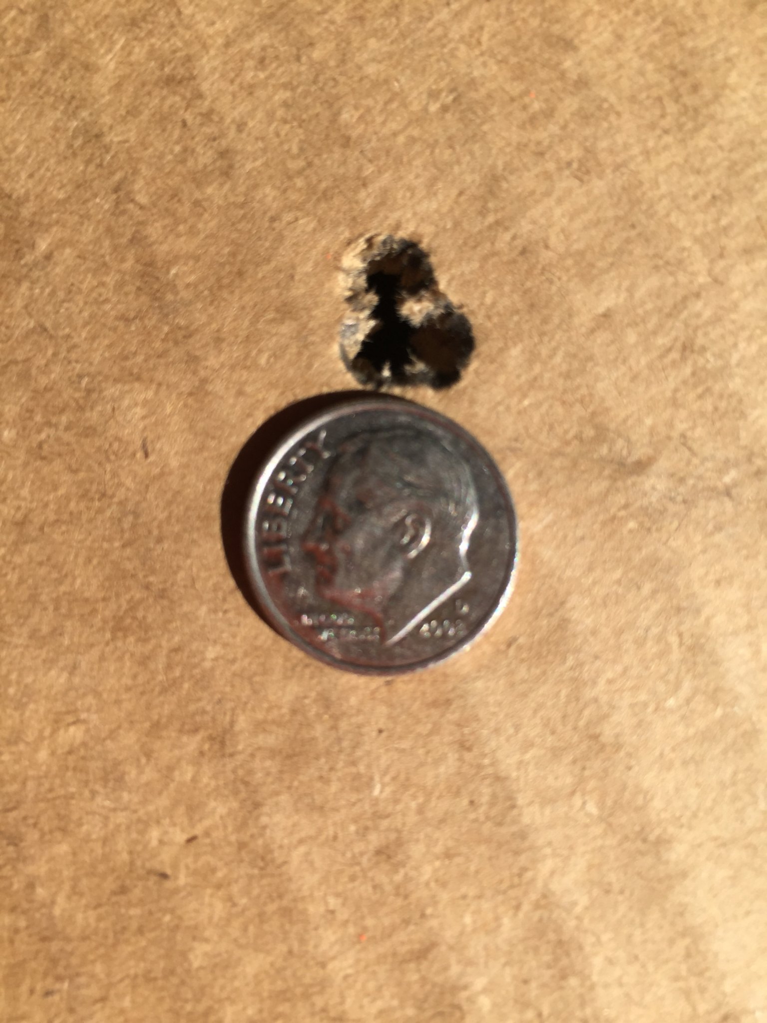

123 scenar 20” Proof 1:8 44.4 H4350 Peterson SRP brass CCI450 (no pressure signs at all)
One 3 shot group at 100 yards after an ocw

That feel when you realize you put the wrong set of data in the spreadsheet, edited with the CORRECT velocities from the H4350 test. I need to test a few more hopefully this weekend, over the chrono and see what they do at longer range but 46.6gr of H4350 and a CCI400 average velocity of 2816 SD of 6 seems very promising.
