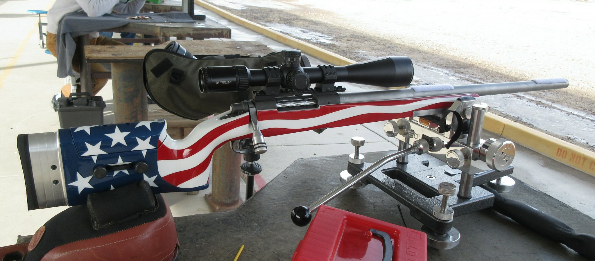

I have an odd problem here (MAYBE an opportunity for all I know!), so here it is---I shot out my 284 Win on an accurized by Long Rifles, Inc (LRI) long action Rem 700 that I use for a 1000 yard gun, so I bought a new barrel and sent barrel and action off to my smith who managed to not notice that the threads in the action had been opened out a tad by LRI when they accurised the first (Krieger) barrel. THEN he noticed it after threading it for standard Remington 700 threads and chambering it for 284 Win!. So he called me and confessed to his "oopsy" and has stopped for now and I need to figure out what to do as what I wanted was a barrel finished to 26 inches and the only way to put that barrel back on the LRI accurised action is to shorten it to 24" and proceed.....So, now I have (actually HE still has it) a perfectly good barrel chambered for 284 Win with a standard Rem 700 thread on it finished to 26" and I am wondering what to do....Order a new 7mm barrel and have him start all over in order to get what I originally wanted and do something else with the barrel that he "oopsied"? It is a perfectly nice (brand new)7mm/.284 Bartlein SS M24 contour w/8.7 twist ($370.00 shipped to my door, so I DO NOT want to just make it into a tomato stake!) OR maybe have it re-chambered for something else, shortened to 24" and use it on another action? I don't have a spare Rem 700 long action and/or extra long action stock (could maybe buy a "donor" rifle, I guess), but I DO HAVE a couple of short actions (Rem 700) and stocks lying around. I also happen to have a Ruger round top in 30-06 that I haven't fired in years that I could maybe use, but I'm thinking the Bartlein just may be wasted on that action/rifle.
So, OK guys (and gals)---whaddaya think? Any ideas (wild or not so wild?) as to where I could/should go with this? I'm trying to stay away from MAGNUMS---especially BELTED magnums---, but am open to just about anything else? 7mm SLR? 7mm Credmoor? 7mm X 64 Brenneke? 7mm WST? SUGGESTIONS, PLEASE!!! Pretty much it will have to be a .284 or 7mm of some sort and the M24 contour, but WHAT??
Attached PIC is how it looked before all this...and it shot pretty decent, but not actually a HAMMER!
HELP!!

Have your gunsmith order you a new barrel and build you exactly what you want. He is liable for his “oopsie” and should bare the costs to correct it. He will be able to sell the “oopsied” barrel to someone else to recover his costs if he chooses. He should have offered this option to you out the gate. You shouldn’t need to even ask. It’s called accountability.
Good thoughts, but...Yeah..I get all that and if the guy was not a friend and fellow shooter/competitor (and a DAMNED GOOD SHOT, BTW) whom I've known for years that would be my "go to" solution. But as it is, I am trying to do something other than that if I can....and I DO kinda enjoy playing around and "experimenting" and I DO have some other decent "candidate actions/stocks" lying around the shop....could maybe even buy something else to "play with". Yeah..I AM kinda waffling here!
Reactions: wade2big
Agree with the first 2 posts, it's really your smith's job to take care of his customer even if he is a buddy. It's one thing if he's doing the work for free, but if you're a paying customer then he should get you a new one. If he cuts 2" off it will have to be cut off the back of the barrel right? That's no bueno in my view. If you want to help him out you could help him sell it, or as you pointed out put it in a different action, but then he obviously can't open up the action to accurize it, haha, tough spot.
Yep...there is just NO WAY to change the threads to the right ones for the action other than re-doing the whole chamber end of the barrel. That would all be OK with me, but what I wanted for its intended use was 26" finished. 24" as opposed to 26" doesn't really make much difference except for somewhat of a loss in velocity... wouldn't be a huge deal at only 1000 yards, but then.....:rolleyes:
It wouldnt be a huge deal, but like I said above, he doesn’t need to chop 2” off. The whole threaded portion plus the recoil lug is about .950. That’s all that needs to go.

Yeah, there's a reason most PRS/NRL shooters (who shoot within 1k almost exclusively) use 26" and not 24" barrels. Not to mention, you'd effectively change your contour pretty substantially. It would be very different than a 24" barrel in the contour you have (where the end of the barrel is cut off).
Just have him cut off the one inch and do it as a 25" barrel. Ask him how much of a discount he'll give you for this oopsie. If he is a friend this will help make him and you feel better. That one inch of barrel won't make any difference at all.
If it was just some gunsmith and not a friend I would ask to have it redone at the gunsmiths expense.

shorten it, run a straight 7-08 (or even AI) in a short action shooting the 162's.
OR
Put it up for sale, recoup all of your cost (a threaded, chambered bartlein barrel is worth more than 370), buy a new barrel and march on.
Problem solved.
Post it up in the for sale section here and on accurate shooter.
My guess is that it will move pretty quickly.

I know that he's responsible for the mistake and SHOULD remedy the situation if you request.
... but if I were you, for the sake of not having to wait for another barrel to come (looooong waits right now), I'd just chamber it, finish at 24", and enjoy getting your rifle back 3 months earlier than it would take to get another barrel. You're not going to miss the additional 2 inches, velocity-wise.

Yeah...recouping the bucks I have into it makes sense...I haven't checked around yet to see if there is another BARTLEIN 7mm M24 in the same twist (or maybe a Krieger, BRUX, Douglass or some other quality barrel is out there somewhere for sale. ("BAD ACCOUNTANT" above is right about the long wait problem I'd guess!)That COULD make a difference in the long run maybe......
I already have TWO 7mm-08s, which I like a lot, but they were my rifle silhouette guns....Don't really know what I'd do with another one!
This is a really good point. Waiting another 3 months (or more) might be rough. Could keep an eye on the sniper's hide classifieds, I see barrels there often.
As far as what to do with the existing barrel, you could set it back and punch it out to 7 SAUM/SS/Max and run it on one of the short actions you have laying around.

Well, after looking around at other barrels and seeing what is (alarmingly...actually NOT) available and what the wait times are , reading you guys' replies, talking to some shooting buddies and considering where things are at the moment with the Bartlein, I think I'm going to opt for shortening it as little as possible (which MAY be as little as another .685 of an inch or so when allowing for the 1/4" recoil lug and measuring the removed Krieger in .284 Win that I have upstairs), re-threading it and doing a chamber again in .284 Win. That MAY just be the simplest, more "user friendly" way to go for both myself and my gunsmith. And it seems that I may just wind up with an approximately 25" barrel, which shouldn't be a big whoop....So I get my rifle back a little shorter than what I wanted...doesn't look like there is any HUGE ballistic difference and the barrel might even like being a little stubbier---Who can tell until it is all said and done and some groups are printed once the barrel is broken in, huh? ANYWAY..what good does it do to own a 1/4 MOA rifle when the shooter is a shaky old 4 MOA stock nut? :p
How much was he going to charge you? If it was a friend price of $50-$100 work with him. Maybe have a muzzle brake added to get the length you wanted.
If he was charging the standard fee of several hundred dollars then that’s different. That’s business and treat it as such because he is. At present you won’t be getting the barrel you want so you’re suffering a loss. It’s only fair that he also loses. You aren’t going to get the barrel you wanted and he shouldn’t get the money he wanted. I could live with it being a inch or so short at a discount. A 50% discount is more than fair.
When it comes to business I’m pretty hard nosed about things. I’ve become that way after years of experience with service providers. They typically smile and are friendly as long as you are paying. They often get really ugly if you aren’t happy with their substandard service and refuse to pay.
There’s nothing wrong with being a nice guy if you’re okay with getting the short end of the stick.
