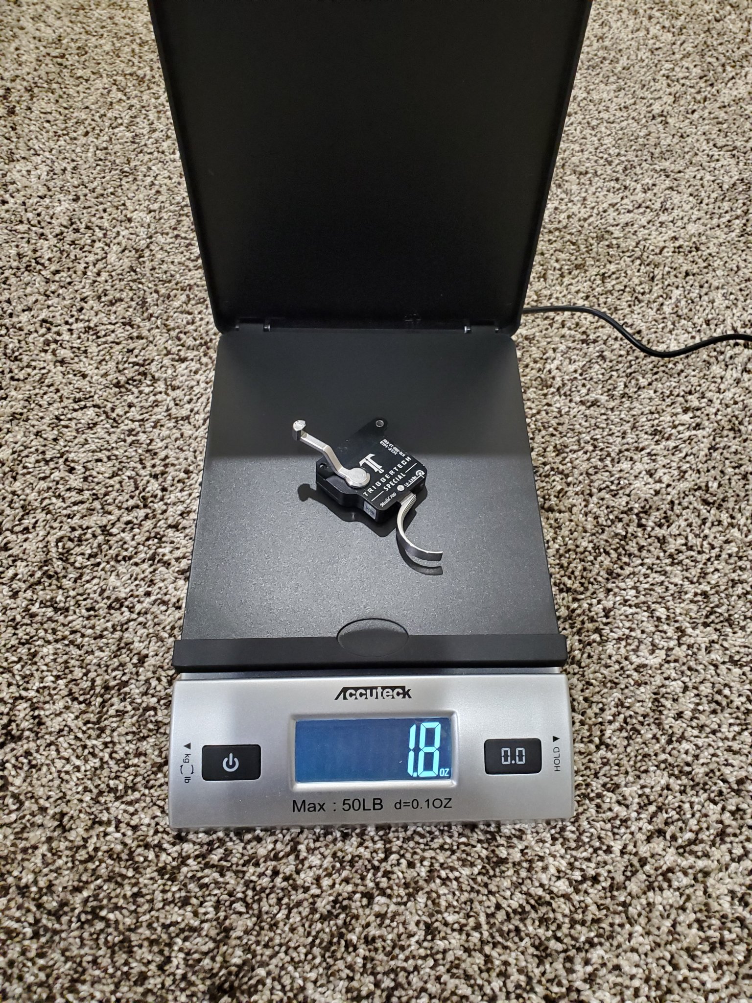

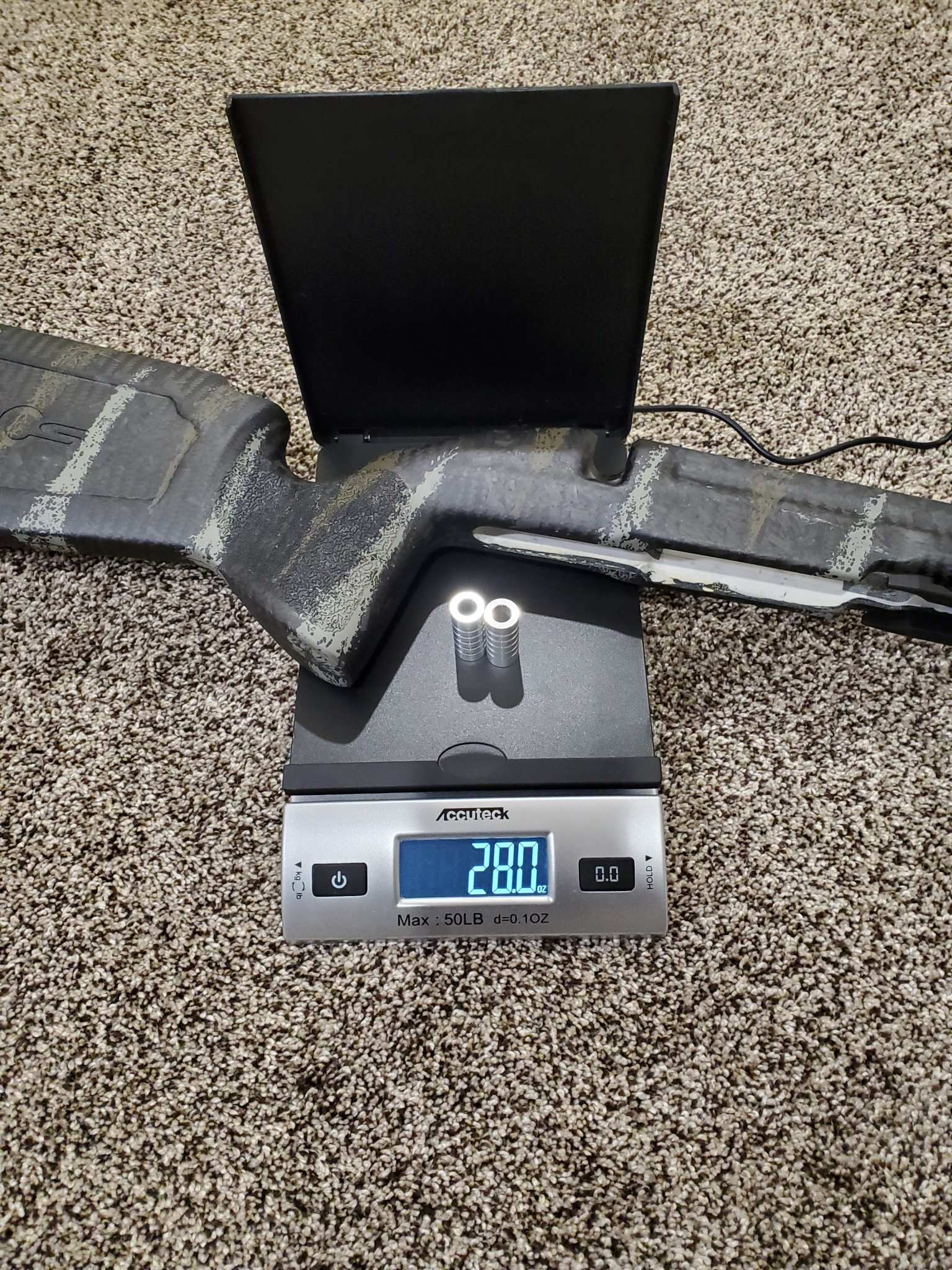

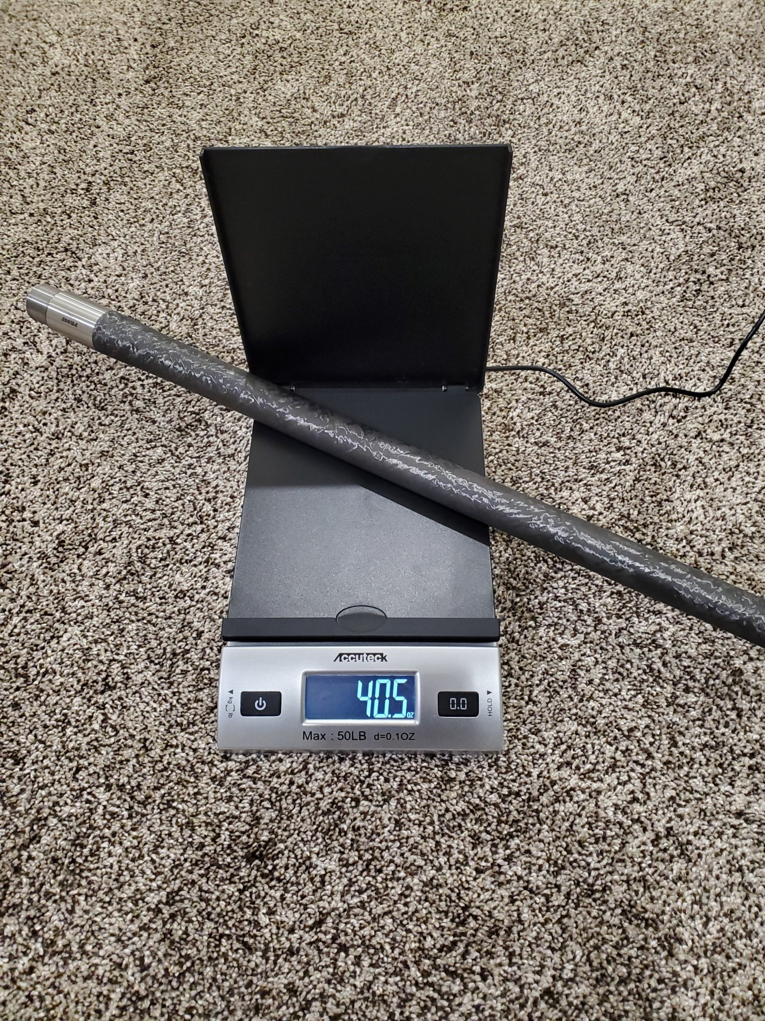

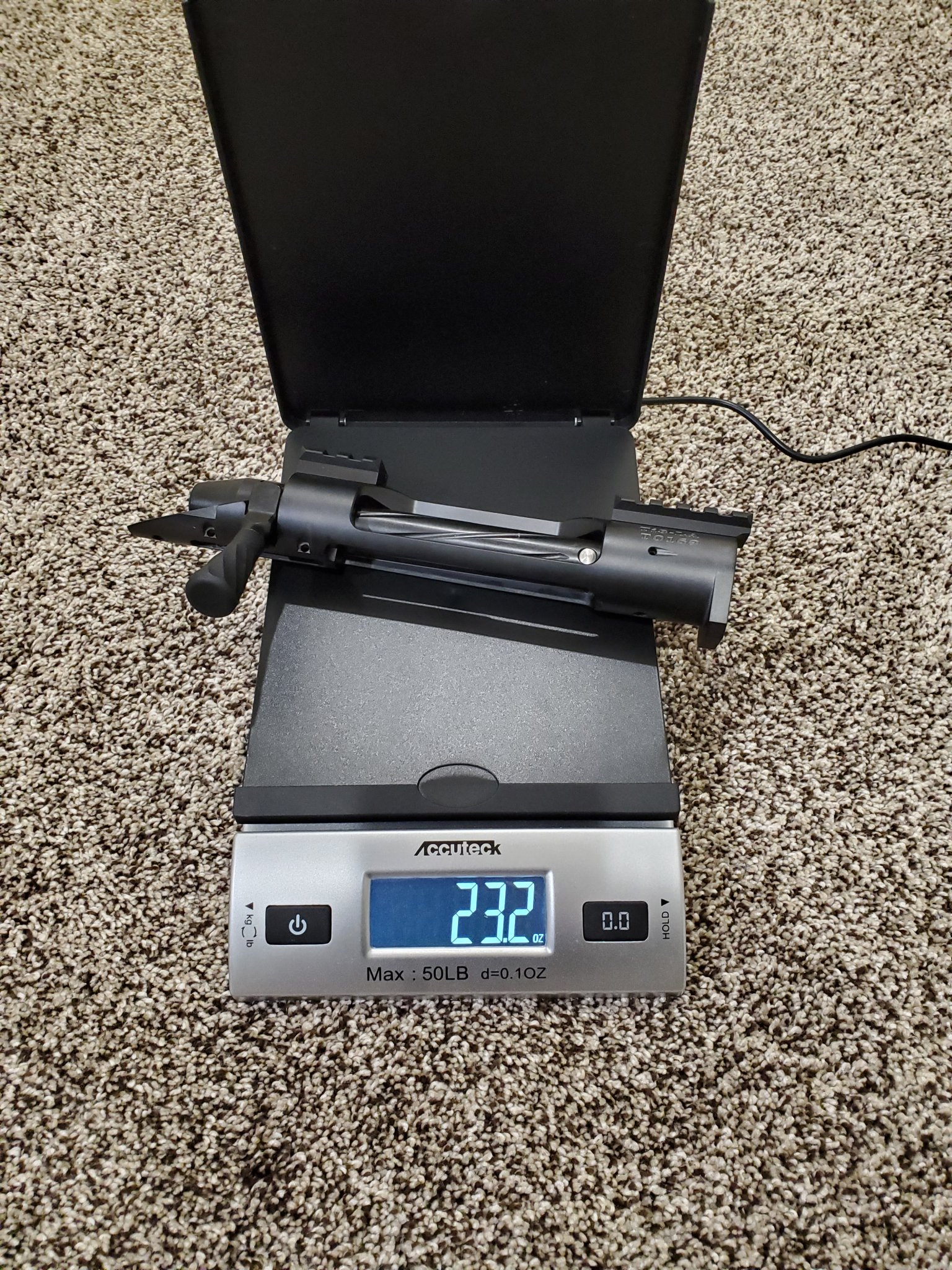

Manners Pro Hunter, no chassis, a little heavier than expected.
Ti-3 Long Action
Proof Sendaro 22", ideally would have gone 20" had one been available
Omega 36m and ASR brake
TT Special, still have not acquired bottom metal
Looking like I'll come close to 6 pounds before optics and suppressor.
