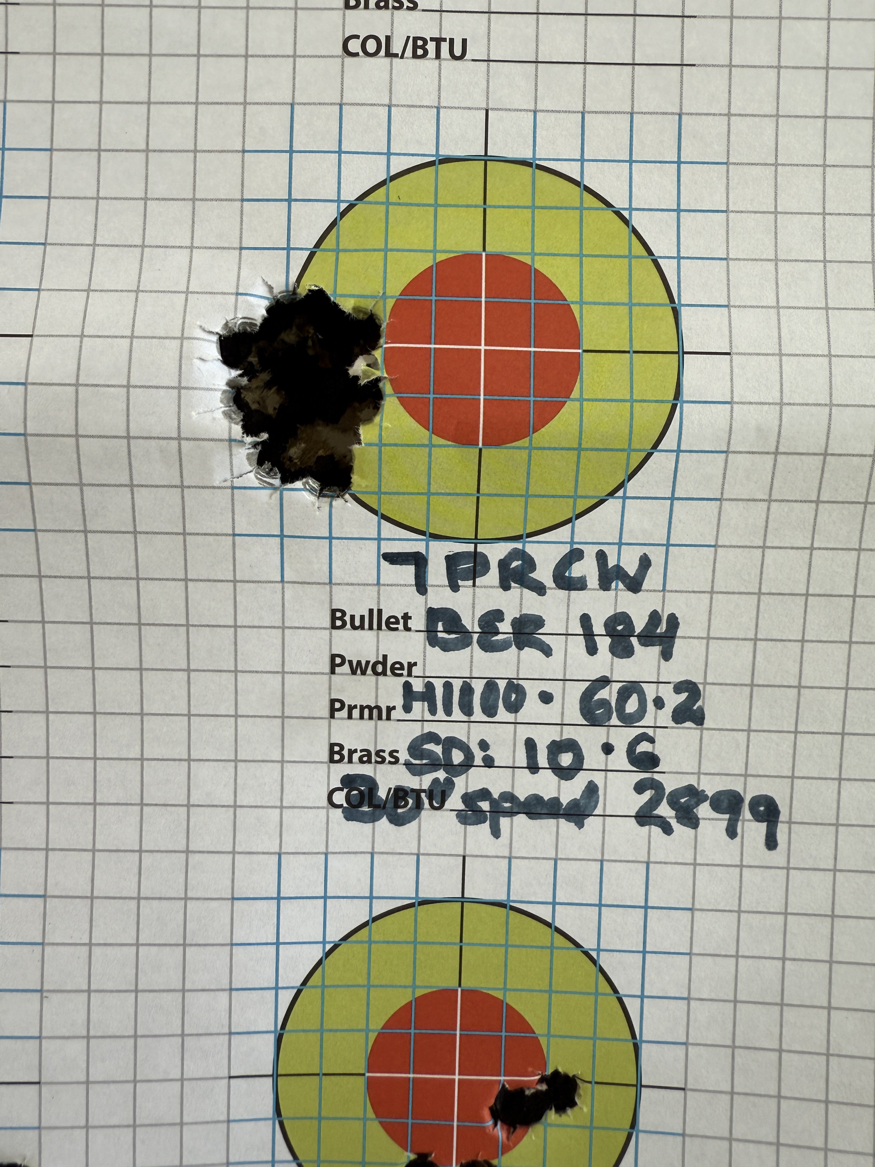

Accuracy.
SD and ES
Getting good nodes.
Must be rifle and Hornady brass. Waiting for a better rifle and will get premium brass. But it seems much more tricky than say 6BR or 6GT to load.
Well crap. Just about everything is more tricky that 6BR and 6GT to load for. If that’s all you’ve experienced, you are about to find out. 6BR is the absolute easy button for loading.
Reactions: Evlshnngns
No. I load 25 cartridges plus.
In large calibers - I have 300NM (getting 5-6 SD), multiple 6.5PRC (getting 8-10 SD). I load loads of magnums. 7PRC was just not working for me. .
. Sent rifle to Howa. They said it’s fine and are returning it. 🤨. I might just sell it and -
I will just wait for the MPA 7PRC. I know it would be great. Issues should to away.
