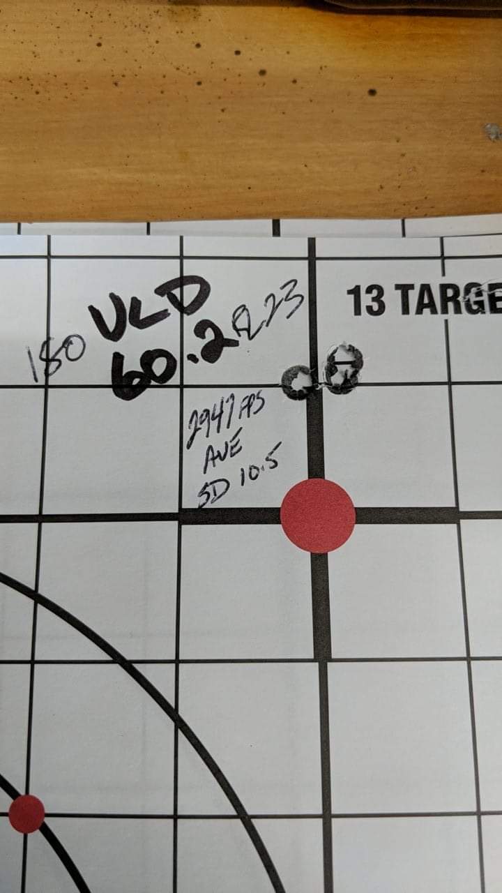

I guess I will drop down to 59.4 ish and see what happens. I don't have anymore time to really dial a load to the nats ass. Moose tag starts Oct 1st and I won't be in town all this weekend and leave for moose camp the following. So I gotta make something happen this week after work.
59.5-59.8 is generally a nice sweet spot in my barrel with ADG brass and 180-190 bullets.
Sounds good. Thanks man.
I did have a pretty good group with 180VLD's.
I also shot some 162 ELDM's I had from my old 7mm that hammered with H4350. .265 4shot group.
Reactions: Army First
