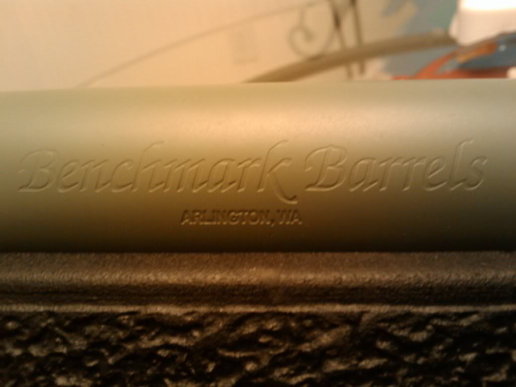

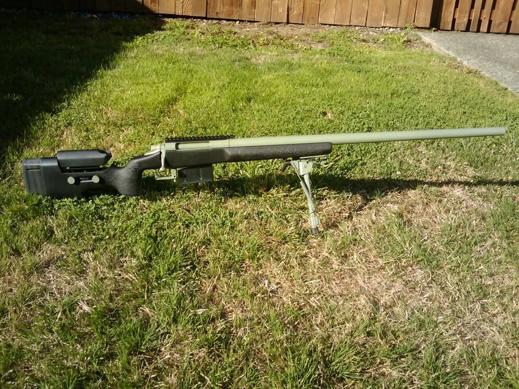

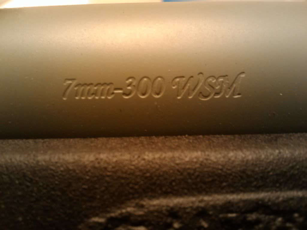

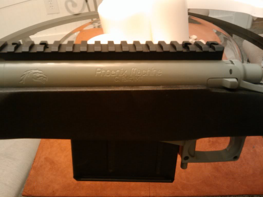

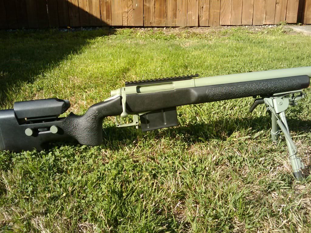

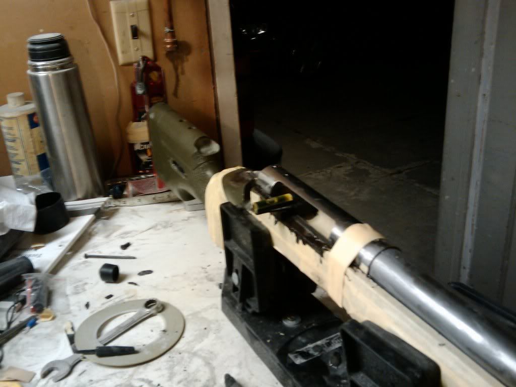

I have been collecting parts for this rifle for an entire year and finally have it complete.
Parts list:
McMillan A5 adjustable stock
Pheonix Reciever
Jewell Trigger
Benchmark 3-groove 9 twist barrel, 28 1/2"
V-Bull DBM

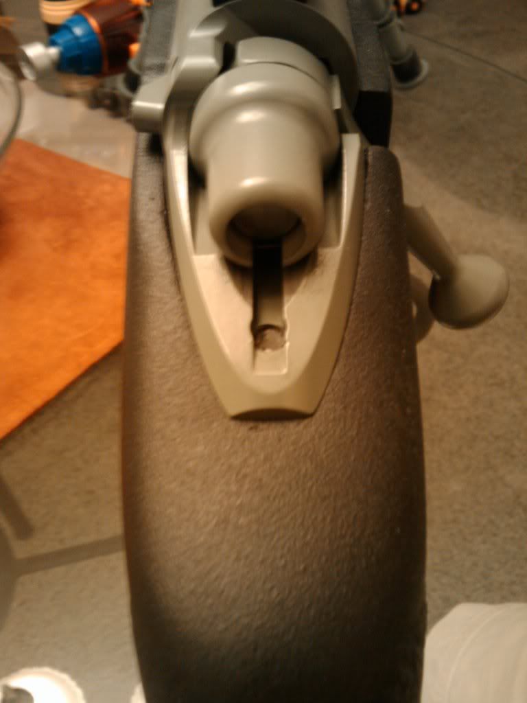

The reamer is Throated for the 180 Berger. The necks on my cases are turned to .014" for a complete clean up. I am doing max load testing for it now, range report soon. I love A5's! Sorry for the poor quality pictures, they were taken from my phone. I textured the stock with some automotive texturing, the pictures don't do it justice but the added 'grip' is real nice. I was also very careful to level the rifle in the stock so the reciever and stock are concentric. The barrel is extra heavy, 1.250" for the first 4" then straight taper to .900" at the muzzle. With the scope and bipod this sucker tips the scales at 17lbs.
