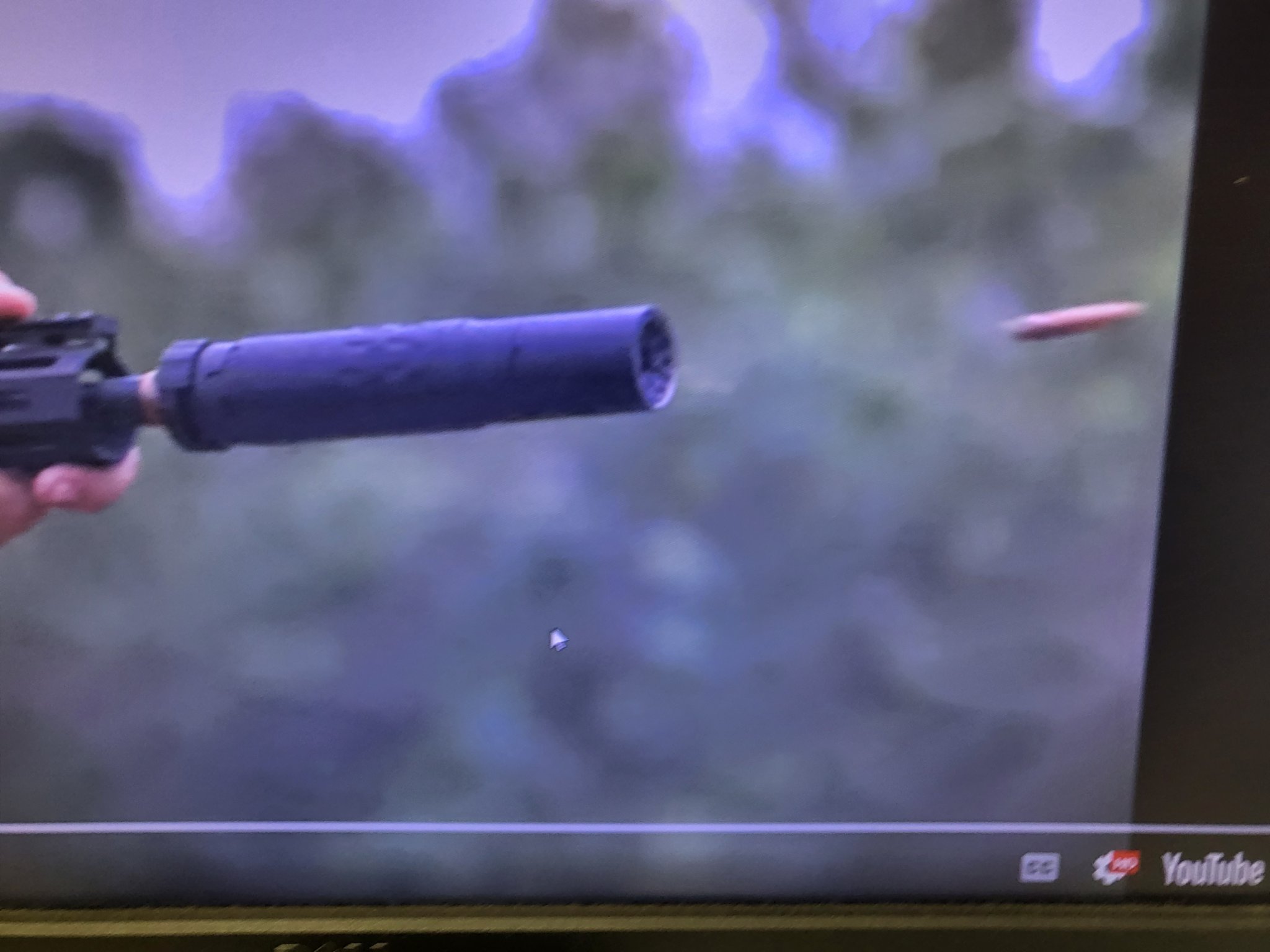

I have been searching the threads on the 8.6 Blackout, and saw some issues with the 1:3 twist over spinning and causing damage to suppressors, etc. I probably should have researched more before I put my rifle together, but I used the Faxon 16" barrel on my Aero AR-10 build. I was zeroing it in yesterday and had no consistency in my groups.
I have a Trijicon Credo 1-8x scope using a Griffin Bushwacker suppressor and Gorilla 285gr. fracturing ammo, the stuff for the 16" barrels. Confirming everything was tight, still had issues. I did inspect my suppressor for any baffle strikes, but everything looks good there.
So wondering if anyone has some thoughts on this? Would I be better off going to the Mos-Tek 1:6.5 twist barrel? Different ammo? What twist is best for that 285gr?

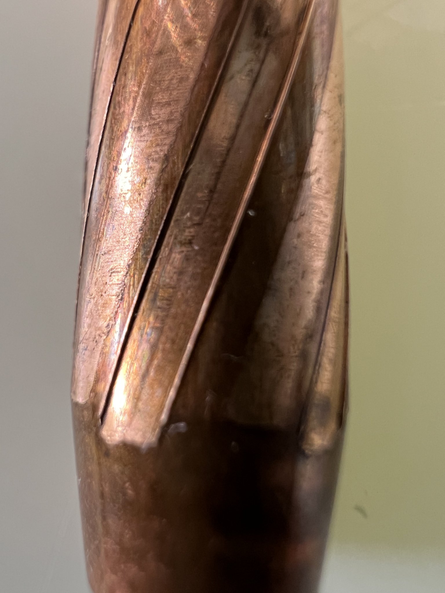

I have an ar10 11.5” Mos-Tex barrel 1:3 twist. Zeroed to 100yds. Gorilla 285gr expanding ammo. It doesn’t stack rounds. Probably 2moa rifle. But I am happy with that as it’s not meant for that level of accuracy. I also run a Hux-Wrx Magnum Ti suppressor with no issues on the system. But it only likes the gorrila ammo and has issues with other subs.
Yes the 8.6 Blackout has a lot of issues...and they are all true! So another suckered into this 3 twist propaganda ..at least I was skeptical...but I had to try it..."curiosity killed the cat" first the Faxon 3 twist barrel I got... ya could not see through it!..what the hell! Put a patch through it pieces of metal, small and long slivers came out ...borescope it was the worst barrel ever observed...torn, galled, pitted rifling ...really bad at the beginning as it not enough lube or not enough clearance ground on the button to make the 3 twist. So I lapped it with silicon carbide lapping compound and polished it...the beginning still some galling and torn areas, but the muzzle area was pretty fair. Problem is cartridge design too much capacity for subsonic too little capacity for supersonic.
Tried quite a few bullets did a fair amount of damage to muzzle devices and magneto speed bayonet destroyed.
What works, opened up the gas port to get bolt carrier lock back. 300 gr Berger bullets 15.8 gr imr4198, accurate low S/D capable. 300 gr SMK 15.8 gr AA 1680 accurate but higher S/D.
No other combinations were acceptable accuracy, except for close range hunting.
200 gr Speer will take 1600 fps
250 Sierra bt hunting fair keep velocity 1200 fps
285 gr eldm at 1400 fps will blow up before 50 yds.
So 1100 fps max for muzzle devices with these lead match bullets to be safe, all subsonic.
Copper bullets have not had acceptable accuracy so far...moved on to other projects.
But find the 300 match bullets from Berger and Sierra the only acceptable loads.

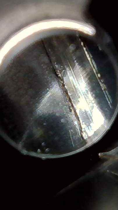

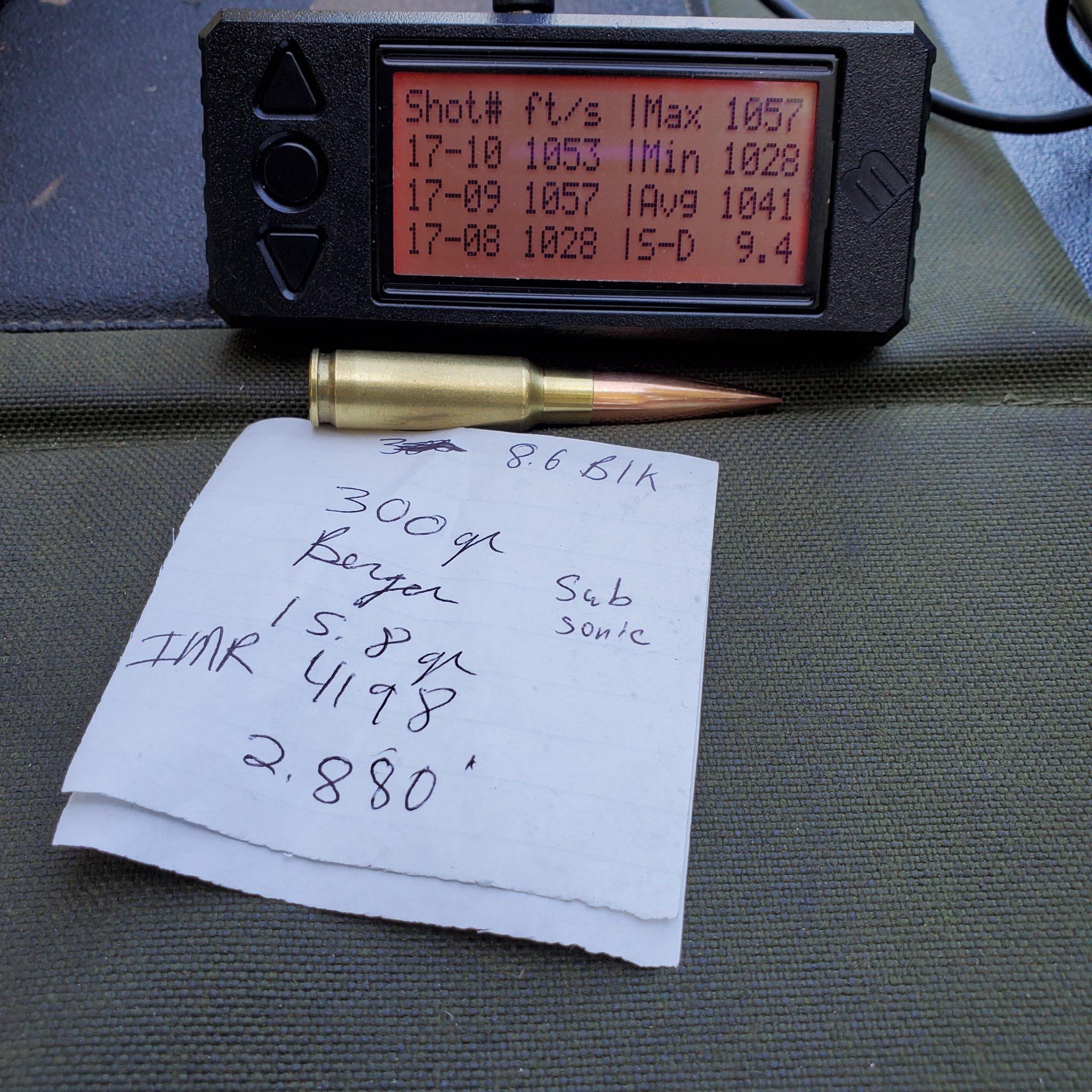

Here is my best acceptable load for the 8.6 blackout Faxon barrel after lapping& polishing...10 shots 9.4 S/D subsonic.
Why would you go through all that when you could’ve just sent the barrel back?

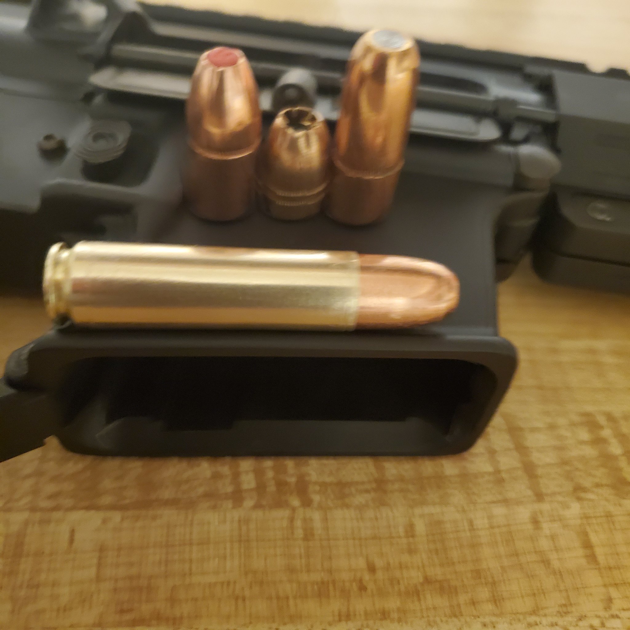

Here it is 16" barrel, 450 Bushmaster Fast 1-16" twist, AR 15 resize 458 500 gr Hornady bullet along with others...no issues. Any .452 or .458 bullet resized in cheap Lee sizing die, you can use any 45 caliber bullet on the planet. You can drill em out, & slit em, make your own...anyway you like...I haven't tried anything above 502 gr...no need really unless your going for elephants, or for fun...but this little AR 15 gets over 3000 ft-lbs of energy with lighter supers.
It beats the 458 SOCOM, with the fast twist, supers and subs...and you are not limited to just the light bullets. Hornady's 395 gr Sub is readily available and I shoot it at high velocity also, it's accurate either way...could be interesting on hogs with an extra 500 to 600 fps, on a sub sonic designed bullet...

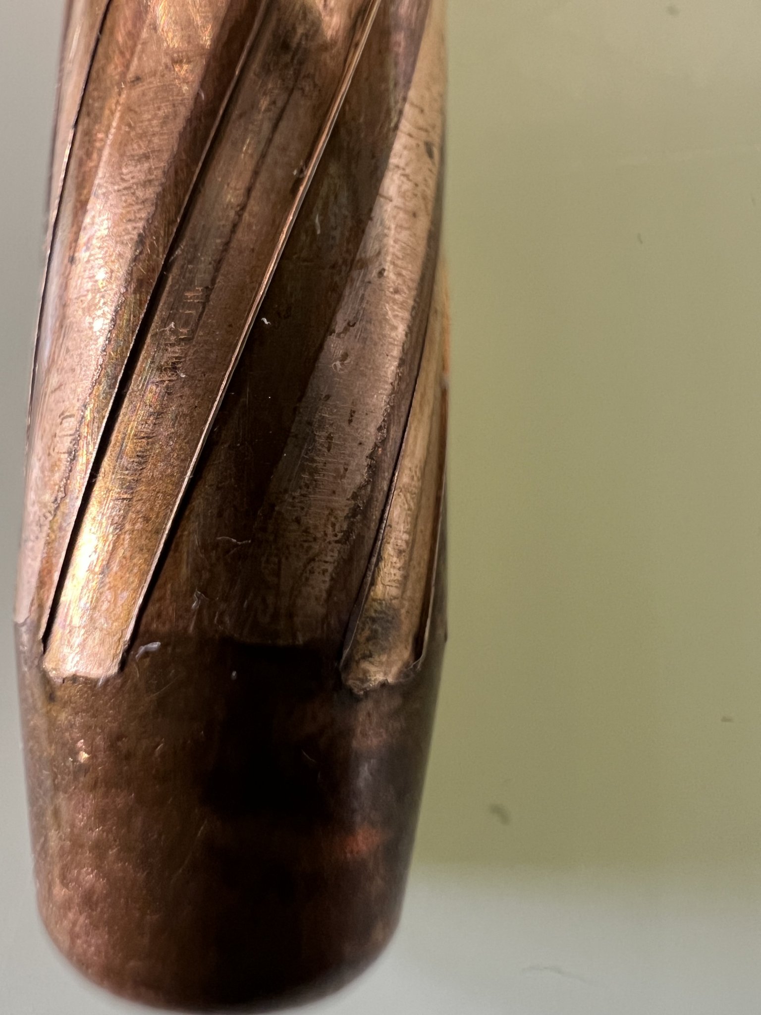

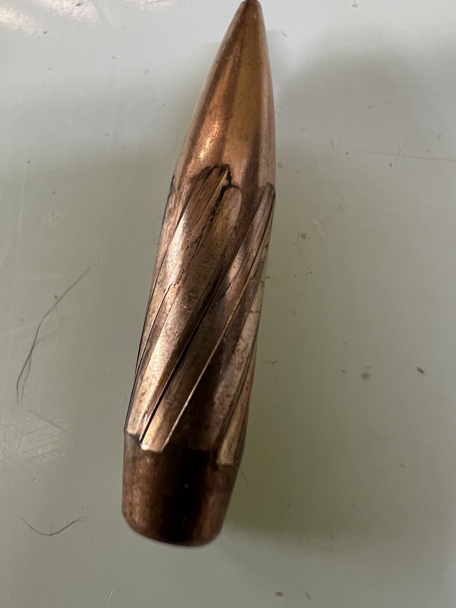

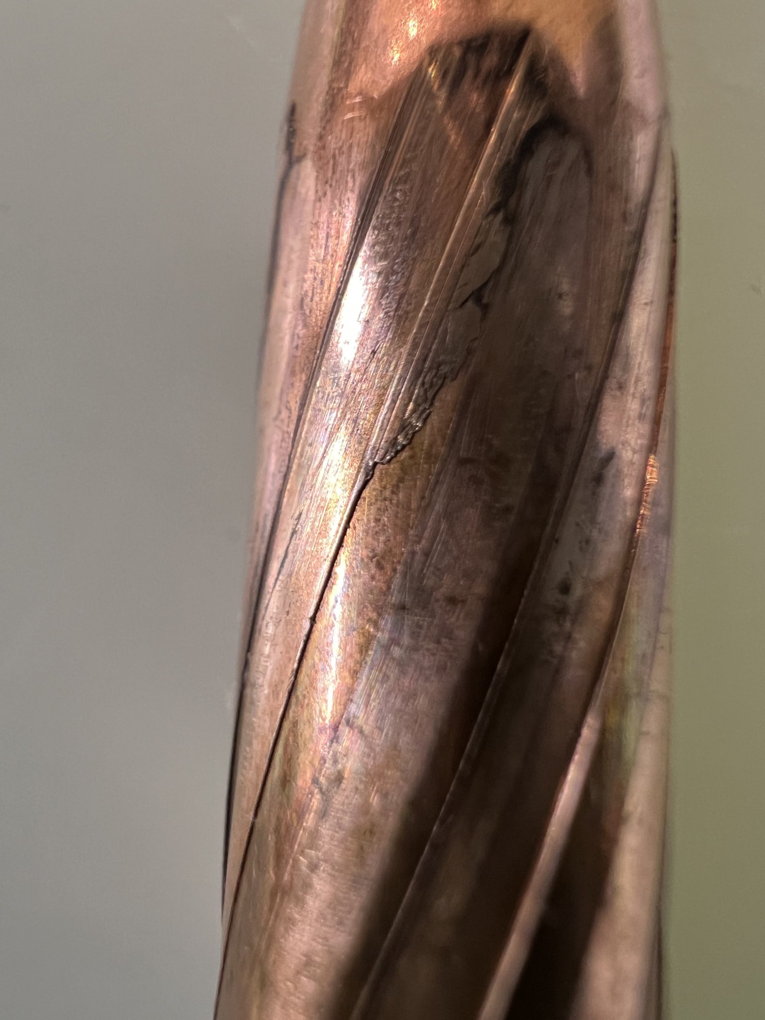

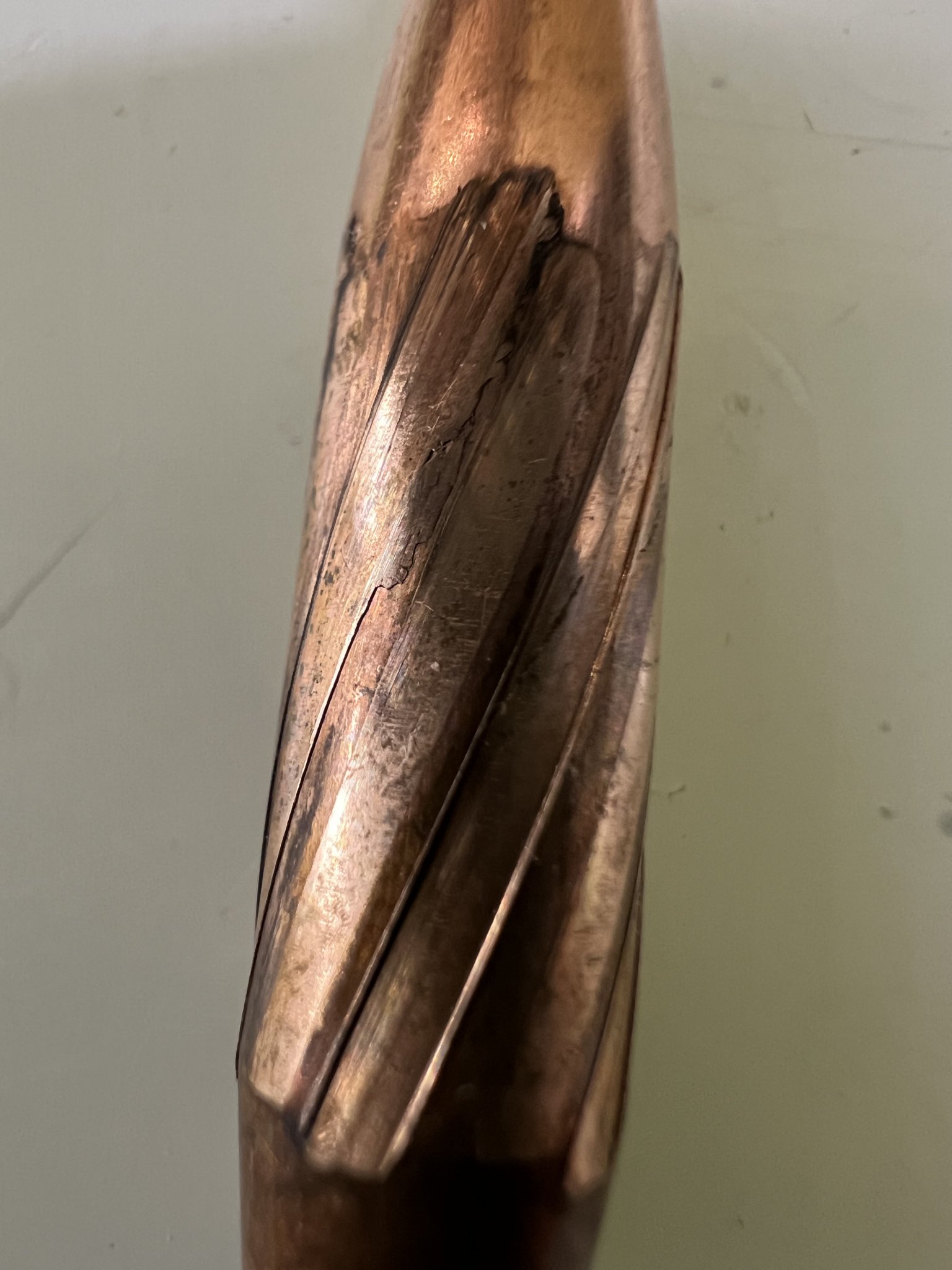

Guys.... as you approach 300k bullet rpm and I'll say the hard line in the sand is 300k. Bullet failure is going to be a problem.
At 1400fps out of a 3 twist barrel that gives you 336k rpm on the bullet.
With a 3 twist barrel you will have to limit your velocities to 1200fps or less. My opinion.
Also really fast twist barrels if your loaded ammo has excessive runout or your shooting poor quality bullets... the fast twist will amplify what I call the premature wobble of the bullet as it makes the jump into the rifling. Accuracy will suffer.
Barrels with poor bore finish and or damage to the rifling from when it was made along with the really fast twist will also be another recipe for bullet failure. The bullet will take more of a beating and the really fast twist isn't going to help anything. The bullet might not be the problem and other factors are making it a problem.

Watch the other video you posted in your post #36. Slow the video down and watch it really close at about the 13 or 14 second mark. Here is a still picture I took of it. Everyone or most people think that when the bullet leaves the barrel it leaves perfectly straight etc... it doesn't it. You can see in that video the bullet tipping down at the base. Now the bullet has to recover while in flight. The worse the tipping is and this can be caused by very high pressures as well. The more the bullet has to try and to recover.... usually the accuracy suffers.
Reactions: Mike6158 and Vynz
Yeah, I noticed that too when I first saw that video...however...it's really hard to tell from video if that is not an artifact of lens distortion or sensor distortion as a consequence of "rolling shutter" (the readout time from the camera sensor top to bottom is linear, so over a period of microseconds it results in angular distortion of moving objects in the direction of their motion). Point being...I'm not sure...it does seem odd that a bullet spinning that fast would start to nose up (or ass down) just a few inches out of the barrel...so...inconclusive in my view...

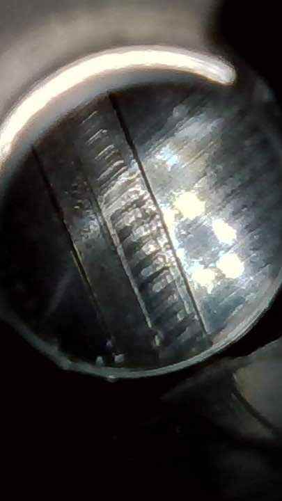

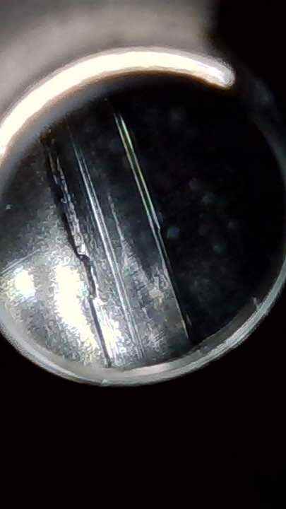

Did you're barrel look similar to this?
Reactions: 45-90
Your first two pic's are damage to the rifling from when the button was pulled thru. Button rifling with these really fast twist I feel will always be an issue. Button rifling displaces the material it doesn't remove the material. Depending on the spec of the button and the material as it will always change they might be pulling a .341" to .342" button size for the groove down the barrel in order to end up with a .338" groove size. Like a snake swallowing a mouse. The steel will expand and spring back where we physically cut the grooves. Those edges of the lands is what we call tearing/tore. It could be a soft spot or a hard spot in the material and with that really fast twist and the conventional rifling it's tearing/breaking chunks out of the edges.
When we cut rifle the barrels we are only cutting like .0001" per pass. Basically shaving.
Also that hard edge of conventional rifling isn't going to help with the button process. That hard sharp edge is going to take a beating.
Your 3rd picture those are bore reamer marks (assuming they are reaming the bores before pulling the button thru as some shops/gun makers to save time and money will go from drilling the blank to just pulling a button thru but those look like bore reamer marks) on the lands and in the grooves. Again button rifling displaces material and the rougher that finish is from the bore reamer... the button is just going to push them down into the grooves as well.
Again the rougher bore/grooves like that and any damage to the edges of the lands.... means the bullets will take more of a beating/get damaged done to them and then the really fast twist rate isn't going to help anything at all either. Accuracy will suffer and bullets blowing up will be another.
That hard edge of conventional rifling will also leave a burr on the sides of the bullets. It will look like a flag sticking up on the side of the jacket. I've seen those burrs as big as a 1/32" of an inch and that will affect the bc of the bullet and affect the flight of the bullet as well.

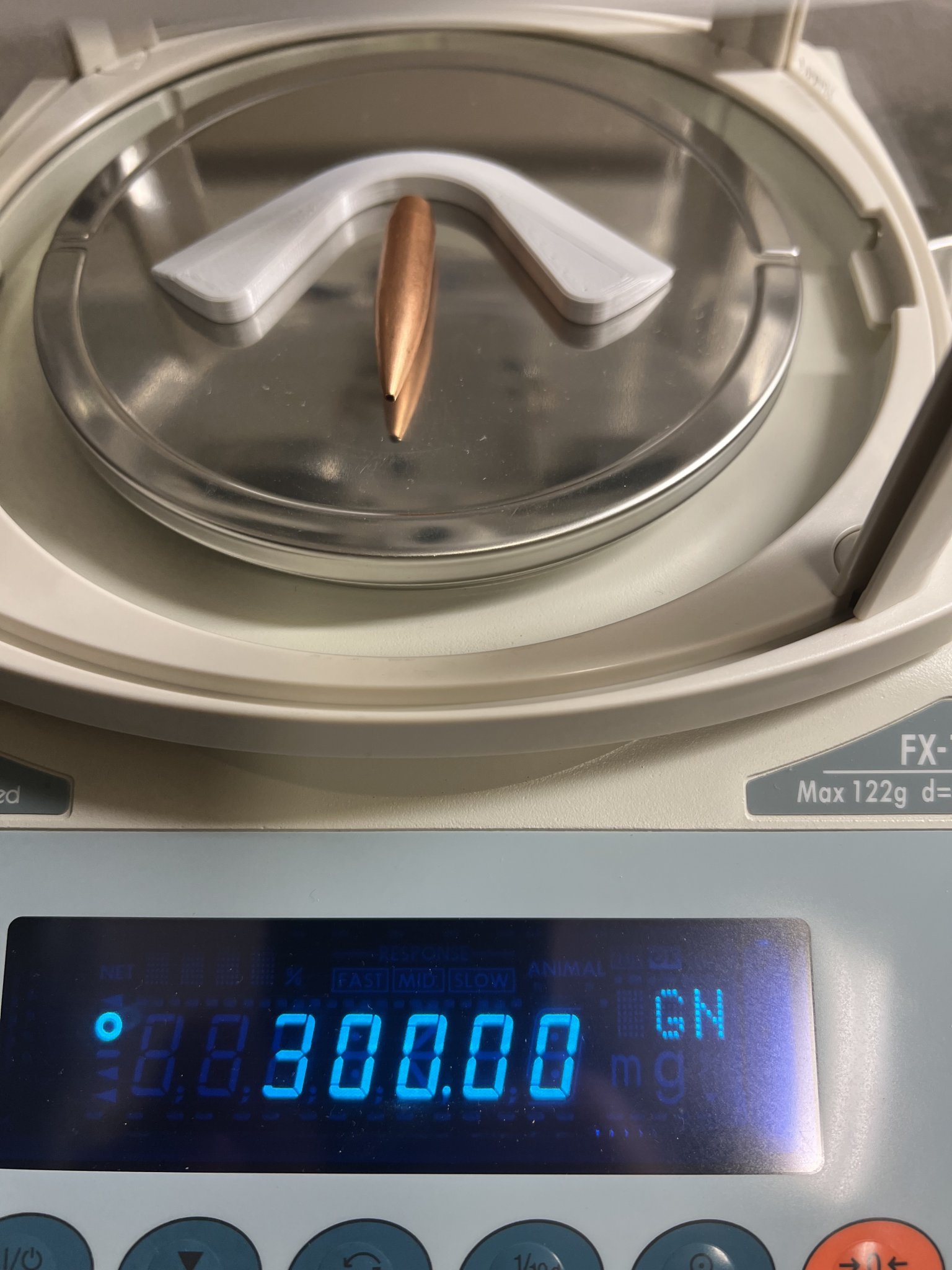

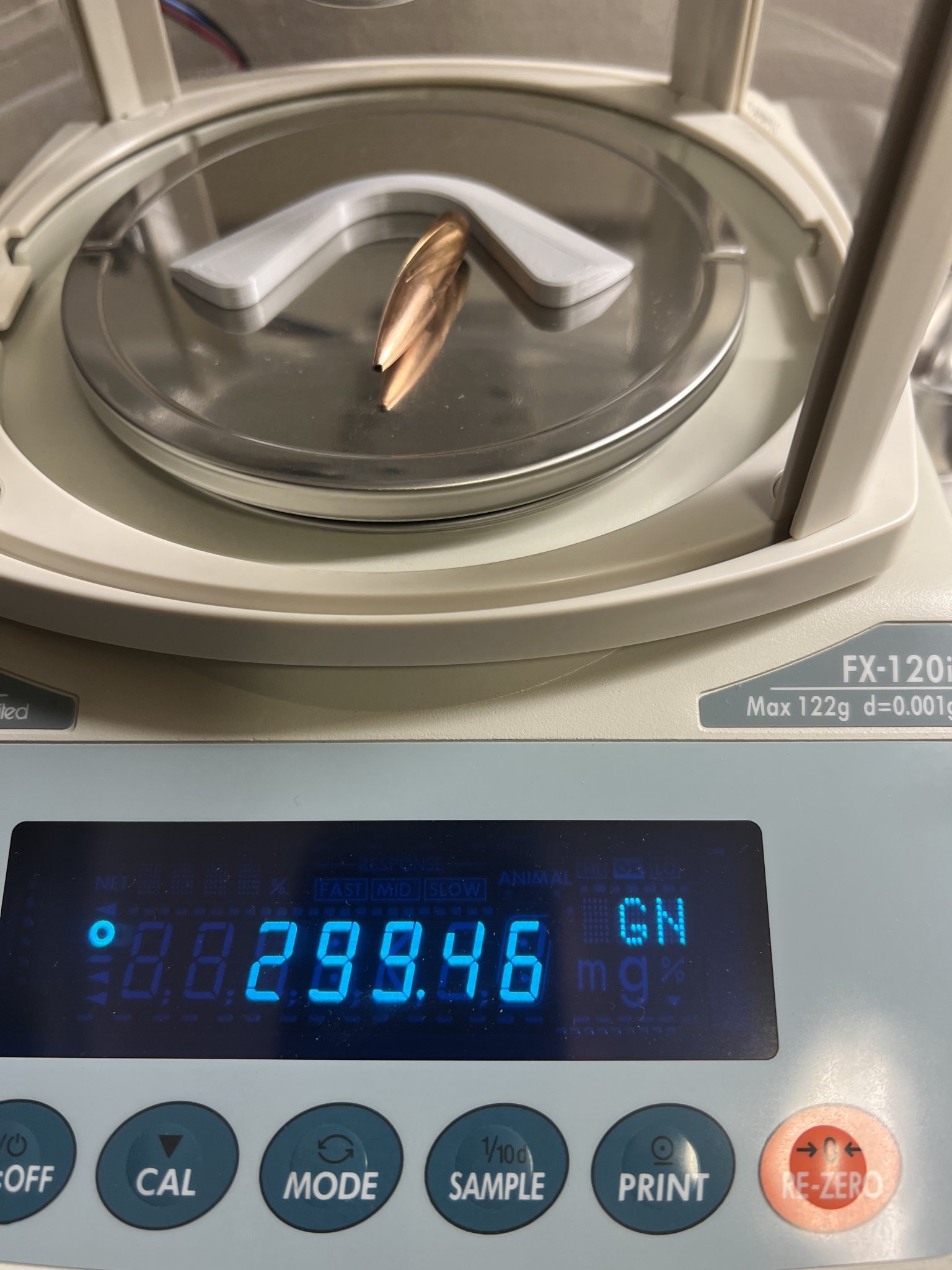

I managed to recover a bullet shoot from the barrel where the pictures was taken. It shows signs of what you describes. It has also lost some weigh which probably is shaved off by the lands?
Yes, typical Faxon 3 twist, mine was maybe worse...chunks of metal were torn off the rifling. Appeared fuzzy looking down the bore, ran a patch through it, and it was brown with slivers and small pieces of metal from the bore...So I lapped it before I shot it.. it still had chunks of metal missing in the beginning by the chamber, but was better toward the muzzle.
