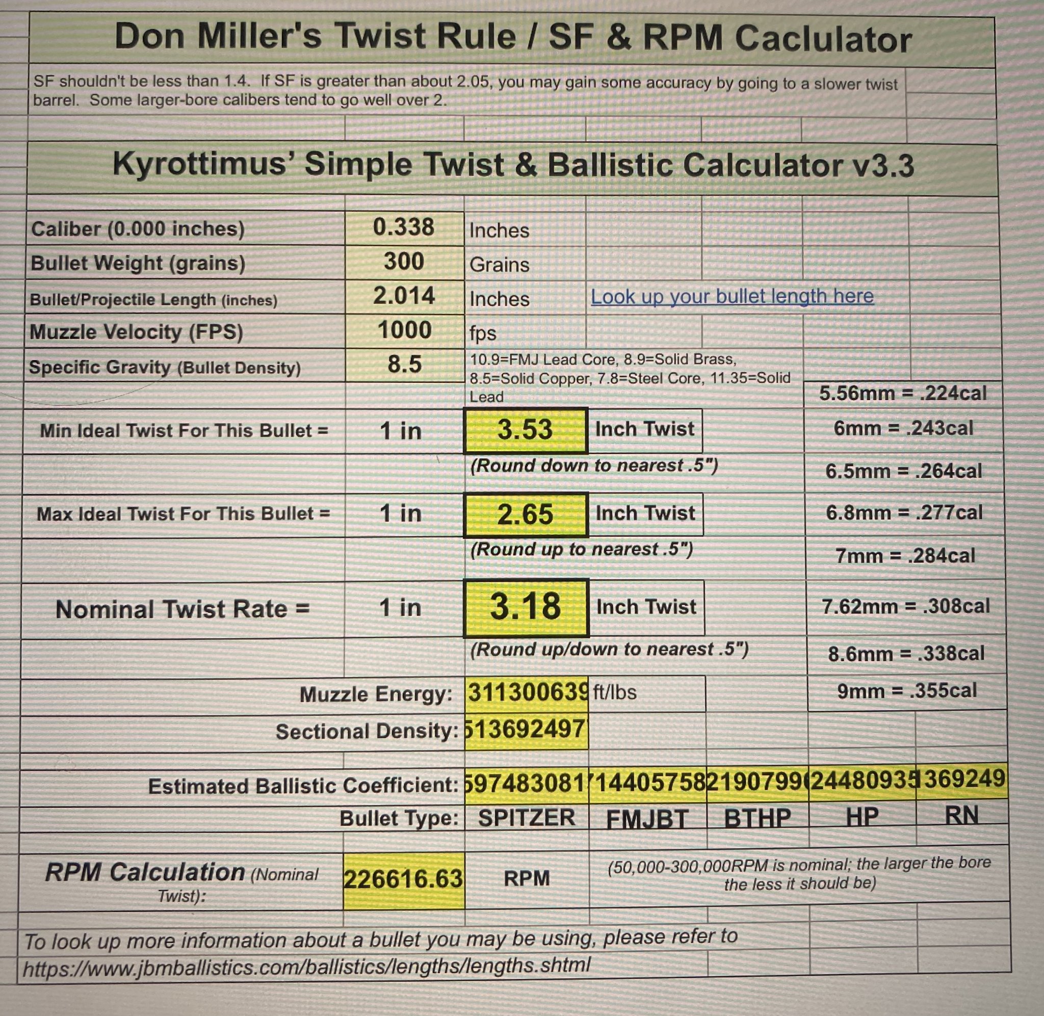

I am basing on this calculator listed on the X-caliber site.
I did see that the maker bullet you mentioned specifically said to avoid a 1:3 twist.

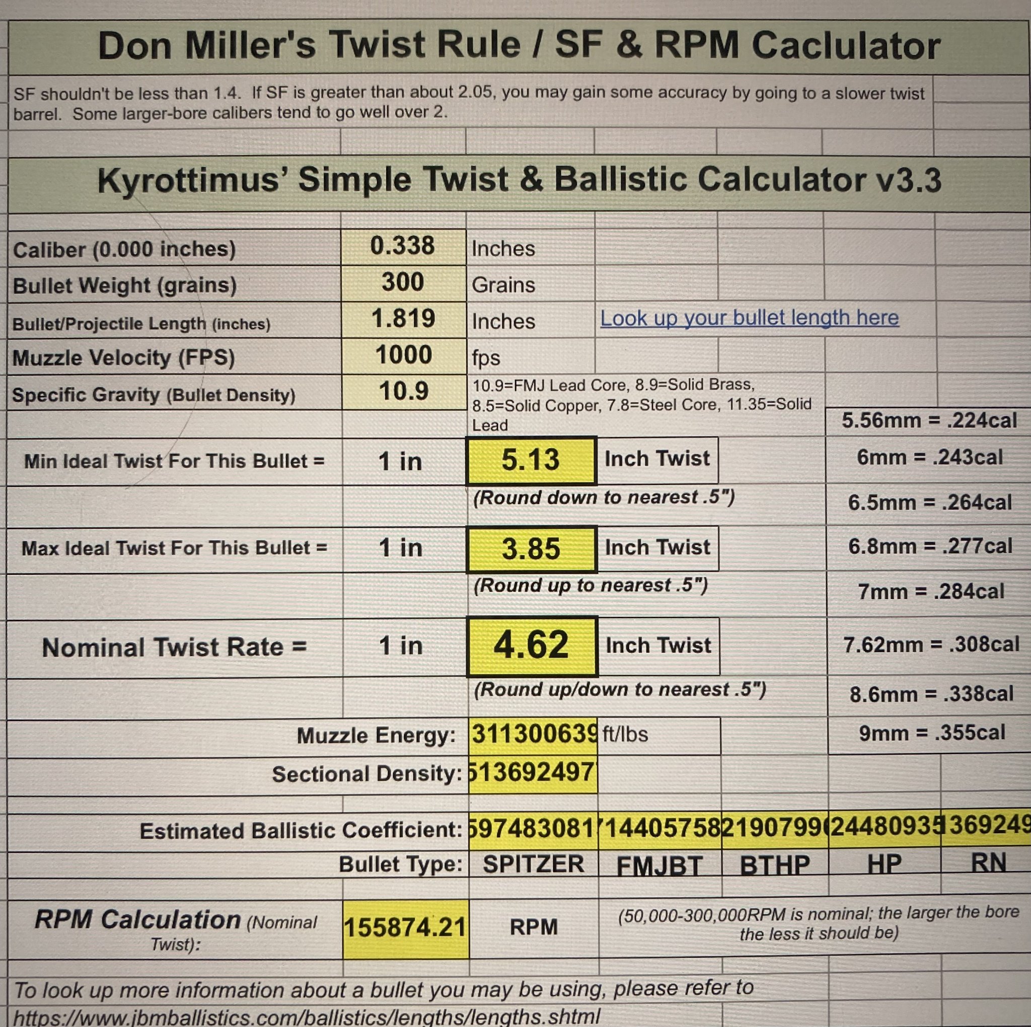

Could not find a bullet length for the makers, but here is another calculation for the cutting edge 300gr .338.
I guess this is why I am still sitting on the sidelines with the 8.6BLK.
