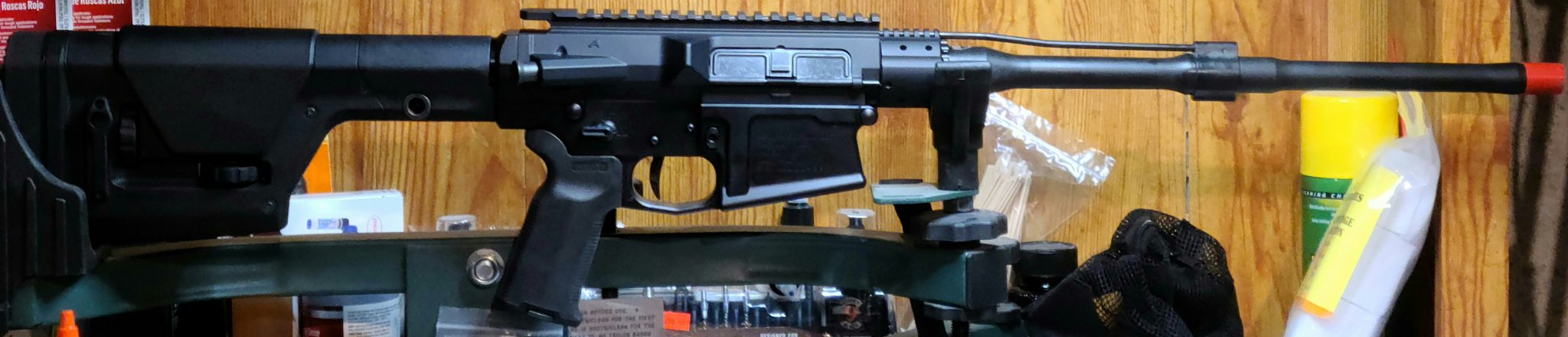

Aside from that, my large bore can came in today, so I got the rail chopped to fit the shorter barrel.
Got the rifle test fired at the shop, so now I have to drag it out to the range to shoot some groups.
Was wondering how you were gonna fit that on the LM8. lol. Considering doing the same on my LMT, or getting another upper altogether.

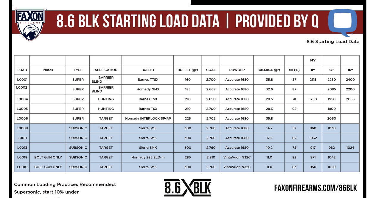

I just got some of the 8.6 BLK ammo from Gorilla today and figured I would study the load data in the chart to see what I may want to cook up in the future. Having said that, I don't think there's any way the charge for load L0013 is correct. Guessing it should be 20.2 based on the fill% and MV. Am I the only one that noticed that?
Seems a bit low, but L0011 shows 1032 fps with 17.2 gr out of an 8" bbl...so it could be correct.
I don't see how it's possible to go from 17.2 gr and a fill% of 62% to 10.2 gr and a fill% of 78% and have the velocity be less, but somehow still faster than L0009 at 14.7 gr.
You are right; something is definitely off there, and it makes me question the rest of the data too.
I wonder if load 13 was actually VV N32C powder, and they either had a typo, or lost track of which powder was in that load. If it's N32C, that lines up well with load 10 at the very bottom.
Definitely some questionable data, regardless. Work up carefully, fellas. (Well, work up for the supers. Work down for subs. Don't want to stick a bullet in the bore.)
Good plan. The cartridge still isn't SAAMI approved and since that load chart is the only one out there looks like we get to be the guinea pigs for loading these. I just hope my CFE BLK comes out real close.. the burn chart I found shows it down by 2 burn rates from 1680 but I am kinda stuck for now until some more dies come out. I think that everyone underestimated demand for this new round. I just hope that eventually supply will catch up with that demand.
