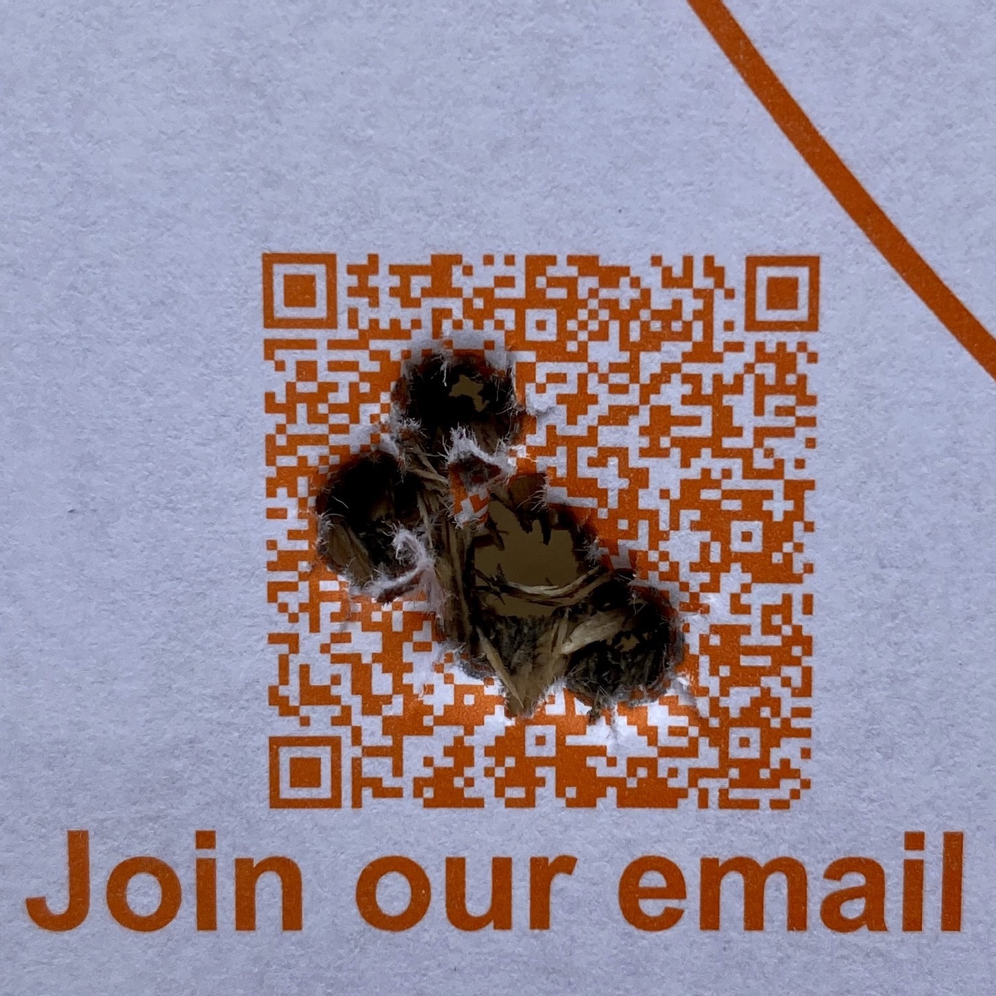

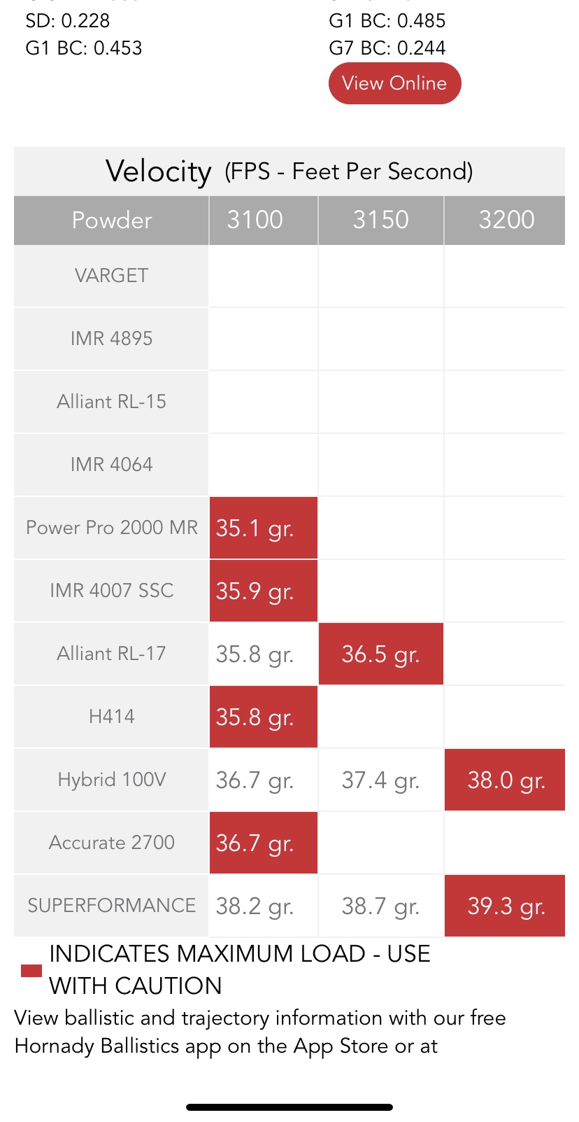

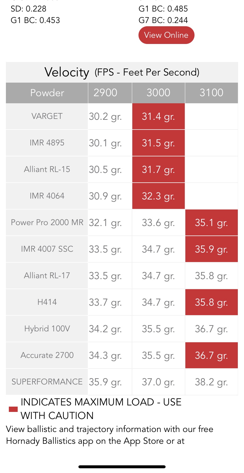

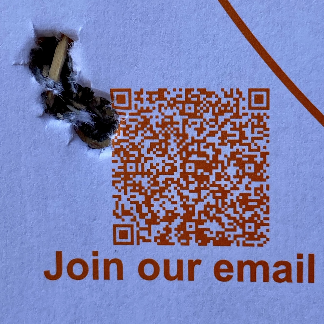

I have load data...80gr ELDM, 34gr H100V, Lapua Brass, Winchester LRP, 2.54” Coal...sub moa @ 100y
