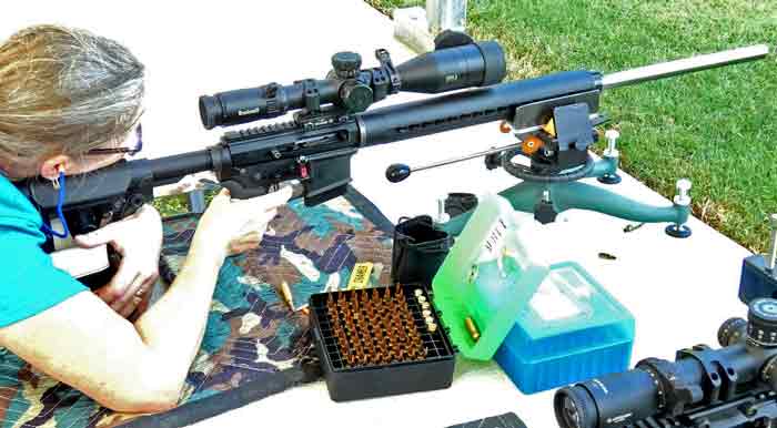

    Made a range trip to have the wife make a final decision on Berger 85.5 or the Hornady 90A-Tip and set scopes for a 600yd F-Open match this Saturday. Was an abnormally cool day (started at 80F, 84F when we finished).
    For background, the shooter, my wife, shoots about 1.5MOA @ 600yds, shooting from a rest and bag.
    Last 4 midrange scores of 559, 570, 565, 569.
    The rifle is a kitchen assembled AR-15, 28", 1:7, 5R, 0.219"/0.224" shooting annealed twice/third fired 22 NosGar cases (weight sorted to a grain), CCI 450 (unsorted), SB6.5 powder (weighed to much better than +/- 0.1gr).

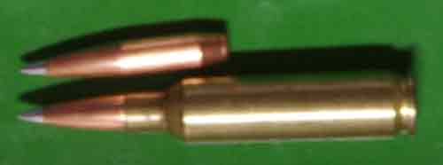

    The 90As where seated deep , case length of 1.760", bullet length of 1.276", cartridge AOL 2.417".

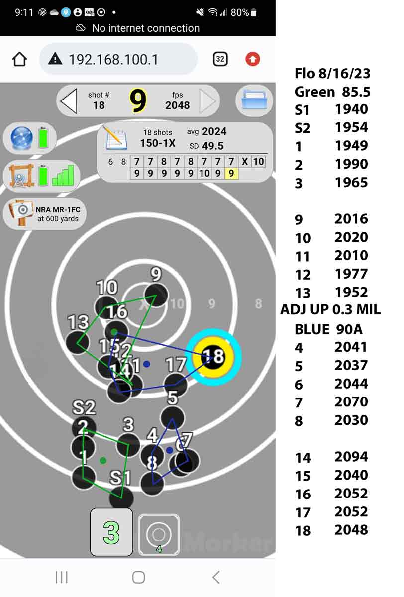

    The velocity started off low with a cold clean barrel. Even if you don't believe the accuracy of the Shotmarker it should show a trend. The 20 shots shown in the picture posted below were shot in the order 5 shots each 85.5/90A adjusted up 0.3 mils then 5 shots each 85.5/90A as listed in the picture.
    For the 10 shots with the 85.5/31.4 load the ES=70, Avg=1977, SD=30.
    For the ten shots with the 90A/31.0 load the ES=54, Avg=2051, SD=19

    Why isn't the POI of the 90A-tip with a higher B.C. and loaded faster higher than the 85.5 @ 600yds?
    I can get the 90A-tip load going faster than the 85.5 load, 31.0gr of powder was a guess and the A-tips are seated deeper into the case, but the higher B.C. and higher velocity doesn't make sense with POA/POI.
    Maybe the groups are too big to really tell. The girl does pull a shot or two :)

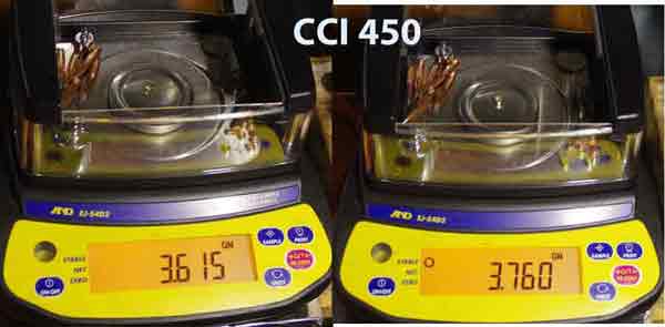

    CCI450 seem to be pretty consistent @ 3.66gr average with most +/- 0.2gr.
    Sorting primers?
    EDIT 8/19/23:
    Sorted some more of the CCI 450 and found a few light ones about 3.615 and two heavy outliers of 3.77 and 3.78 grains.
    Hundreds fell right about 3.66grains avg.

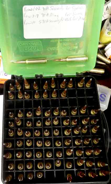

    All done with Flo's match rounds. Took about 3 hours, including breaks, but no naps.
    Sighters, score rounds, and some for a 100yd zero check.
    NAP TIME, then do my ammo.
