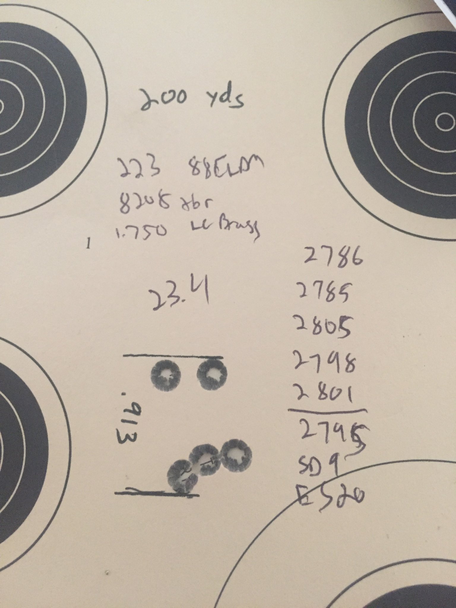

    Run them in my suppressed 22" 7 twist Krieger 223 wylde at 2839fps with 24grs H4895. Love them
    Maybe it’s just me but I have had best luck setting them .035-040 off. My 140’s are the same way. Not the best group but it will work for my trainer.

    Apologize I’m kinda buzzed typing this but I’m running 24 grains in a wolf primed case at 2.54” at 2885 FPS and half inch groups. I’ve shot in at practice and club matches and it does very well. A mandrel die and chamfer debut does wonders for neck tension consistency and SD if you want a match like load

    26.0 2000MR, LC brass, cci#400, col-2.425 85rdf and 2.540 88eld, both touching the lands.
    What’s your velocity? I’d imagine you have to seat a 88 so deep in an AR to mag feed it’s not worth the velocity penalty. In a bolt gun they just barely work if you have the freebore throated for it
