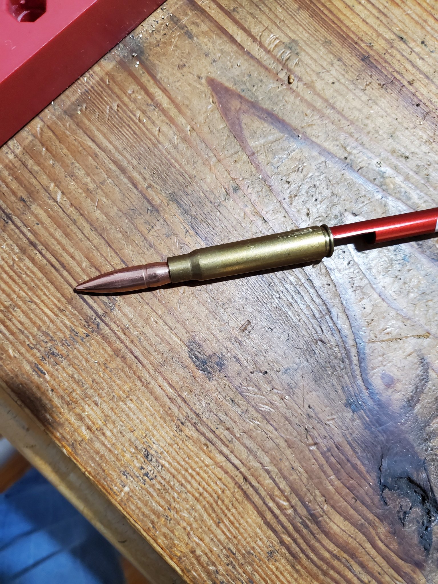

Early 1950s M48B Yugo Mauser, New old stock. This gun shows potential with milsurp ammo so I decided to see if I could improve it. Replaced the horrible trigger with a 3.5lb Timney, added a Bad Ace no tap mount, Vortex rings and scout scope. Added Eagle stock pack to improve cheek weld.
Using Redding dies, Federal brass, 198gr FMJ, 46gr of H4350, 210 primers, seating depth of 2.99 inches. Gun shoots consistent 1.25 to 1.5 inch groups for 3 shots but suucks on 5 shot groups. Maybe its just getting hot I don't know.
If anyone has actual experience loading 8mm I would appreciate your insight on seating depth. Lyman manual says COAL is 3.25 inches, the longest COAL is with a 200gr at 3.00 inches. however my Stoney point indicates a much longer chamber. Here is a pic.

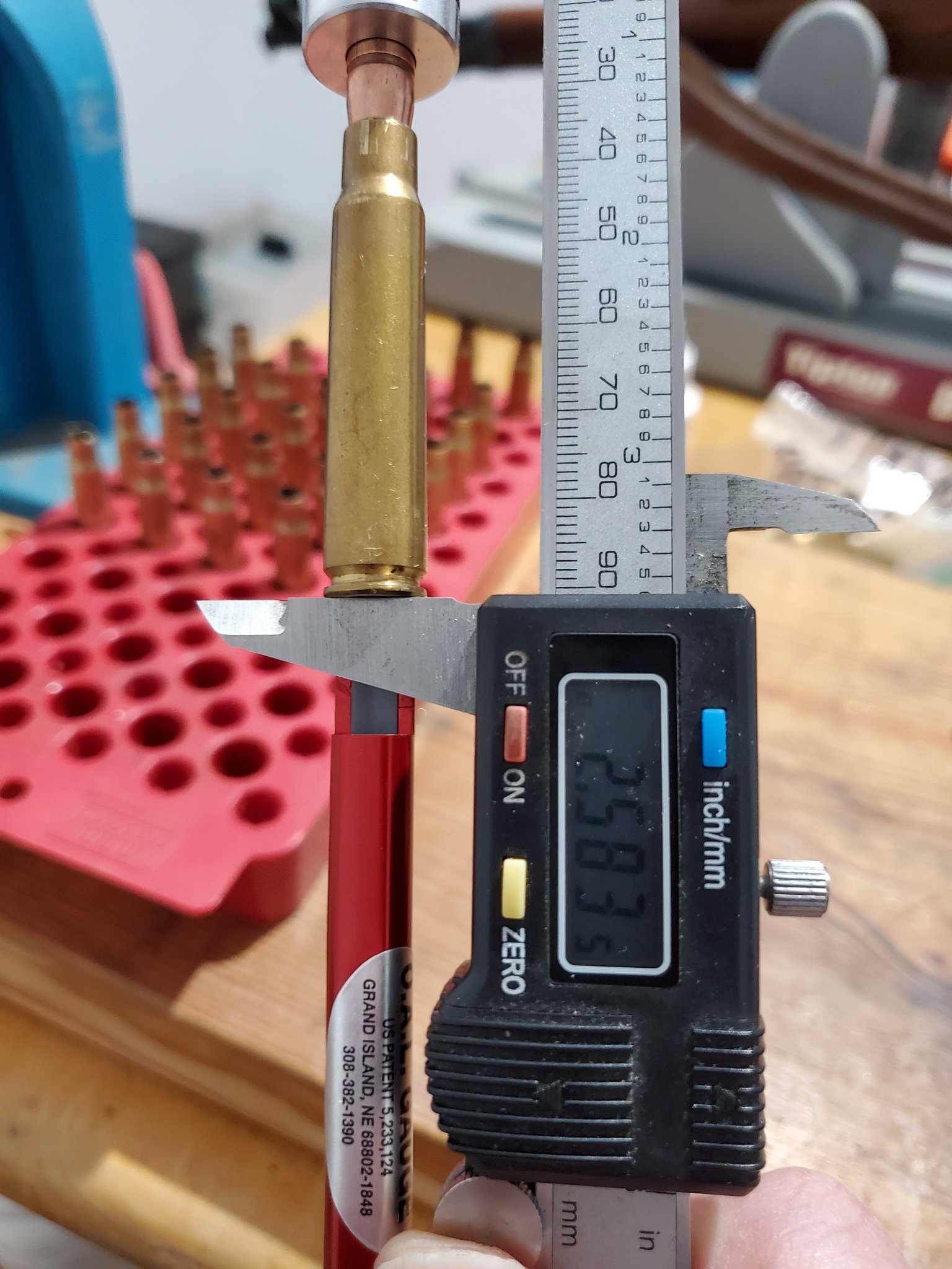

Hornady apparently doesnt see fit to include a .323 bullet comparator but with a .33, it shows
Lands at 2.583 inches and COAL crazy long.
Seating to the cannalure puts COAL at 3.17inches. I tried loading 25 thousands off the lands which is way over 3.25 inches and grouped like crap. Any actual experience and wisdom would be appreciated. Thx in advance.
rediculous right??

Rookie I’ve been loading the 7.92 for 20+ years, with my Yugoslav M48. Now most of the bullets on the market are hunting bullets with cannelures, the one’s that dont are the Speer 170 Gr Soft Point and Sierra 175 gr Soft point, and the Nosler 180 & 200 Grain Ballistic Tips and Partitions . Now from what I’ve read Sierra’s 200 Gr HPBT Matchking is the closest in profile to the Germans 198 Gr FMJ used in WW2, and it has no cannelure . That cannelure may be part of your problem, if you don't trust your Hornady equipment, you could use the smoke method, by taking a lighter flame to the bullet until it turns black, then gentle push the bullet into the chamber, when the bullet comes in contact with the rifling it will leave marks in the blacken part of the bullet. Take your measurements and that should put in the ball part for your CBTO. Now for hunting those Hogs, a FMJ isn’t your best choice, from my research the 180 or 200 Gr Nosler Partition’s have a great track record of putting meat on the table .
