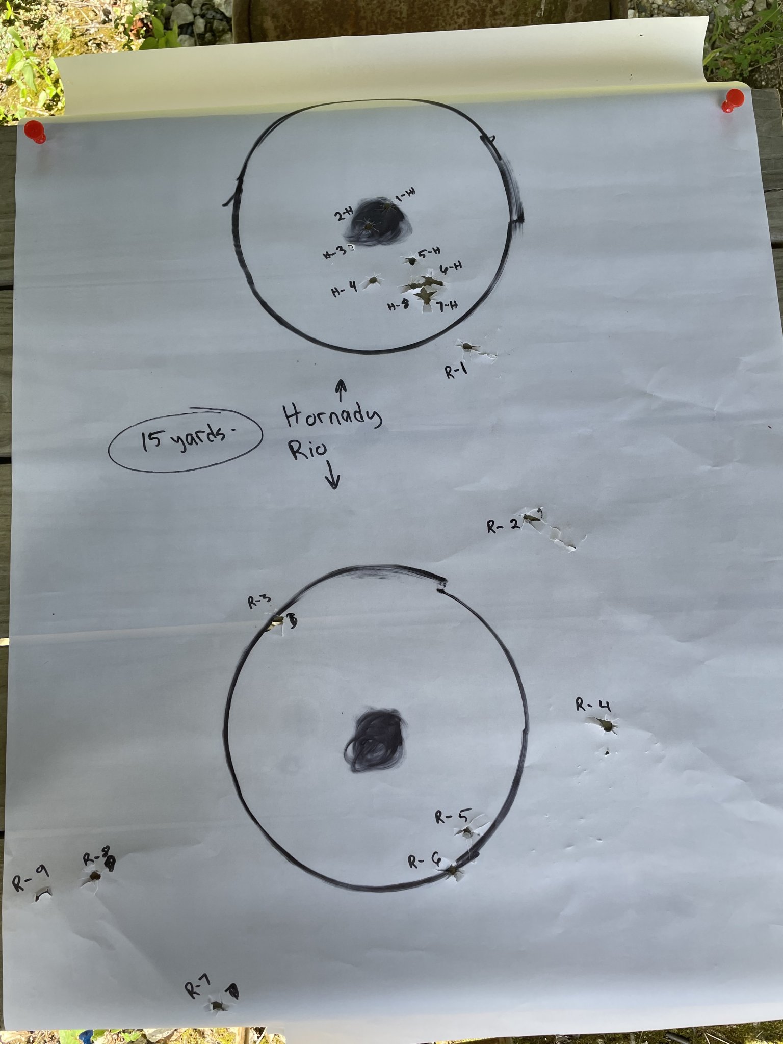

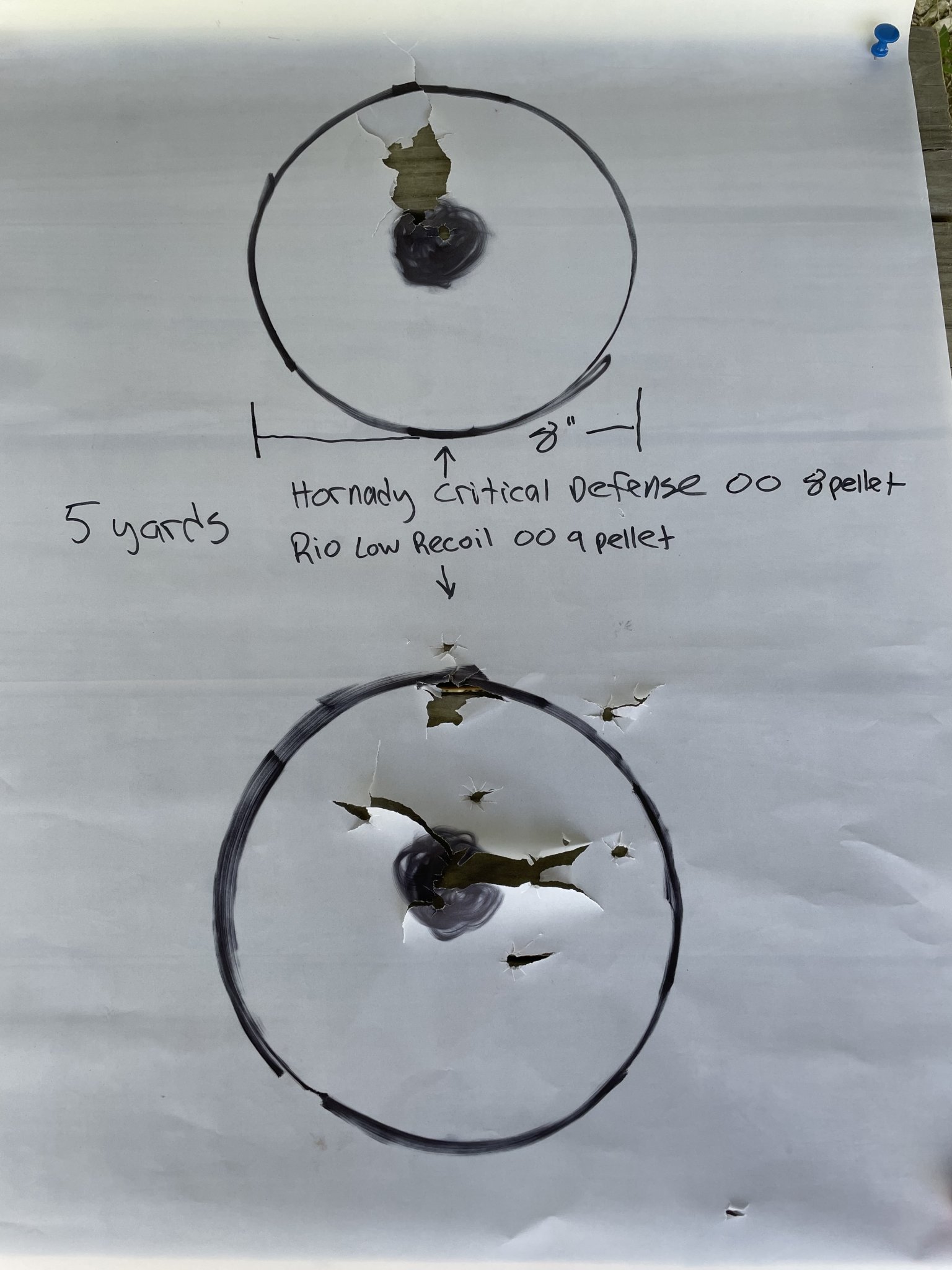

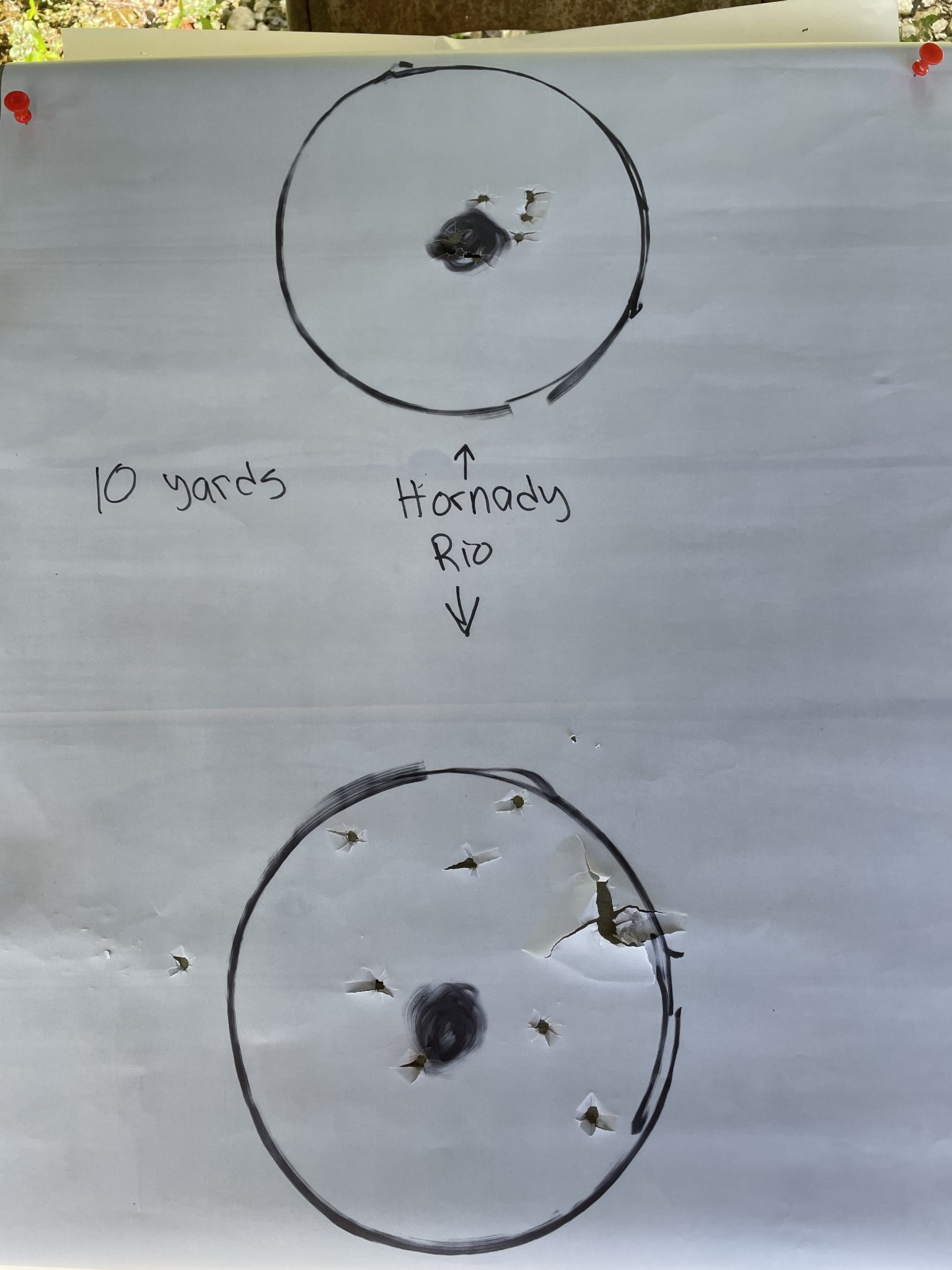

    I figure with buckshot it’s more about pattern than pattern density. And from what little I understand, more pellets may not mean better pattern.
    Below is a paper exercise I did with my 12” SBS. The Hornady load has same wad as Federal Flite Control:

    That Hornady coyote load looks promising.
    Now stretch that out to 40 yards and see what it looks like.
    Yeah no thanks, that’s not what a shotgun means to me. Lol… just trying to reinforce that OP needs to get them all and put them on paper because differences are vast.

    The saying goes "Every gun is a law unto itself." That certainly applies and then some when it comes to chokes and buckshot. Combos that work great in one gun won't pattern for crap in others.

    I LOVE the Rio buckshot... the widest dispersion pattern of any buckshot I've ever tested. ;)
    Federal Flite Control being the tightest.

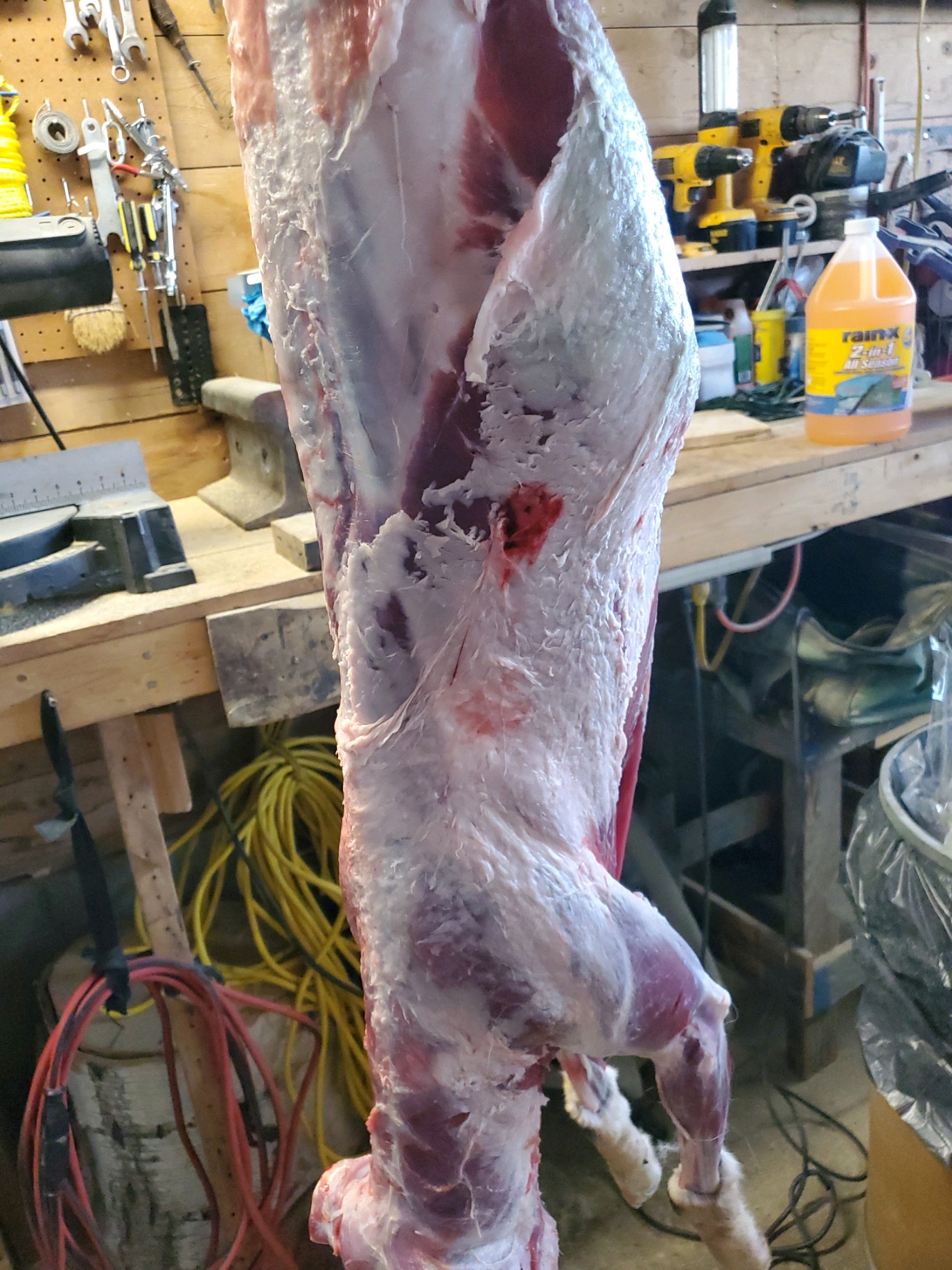

    This gentleman has written a couple excellent articles about shotgun coyote loads. The yardage/penetration charts are very helpful in determining a reasonable range to expect adequate penetration. I would say the caveat to the penetration data is even if a load will penetrate 4" at 100 yards, it's crazy to expect a shotgun to be the right tool for the job. I like to use 40 yards as the determining distance for patterns. I don't expect a pattern to hold together past that. I will try at 50 and 60 yards just to see, because rarely a coyote I've called in that's been shotgunned that works exactly how it's supposed to. It's nice to have that extra yardage in the back pocket if shit goes south, which it usually does.
    Case and point, last year I called in a pair on a line. Calling partner and I were set up in a fence line and the coyotes literally hit the brakes at 75 yards. I was set up with a rifle, but I was on the next post down in the fence line and my partner had already transitioned to the shotgun because of how hard they were coming. I couldn't shoot because he was right in line with the coyotes. The female started to circle and I was ready to kill her, but really wanted that male. I told him to shoot, which he did. He hit him twice, first load was some old Rem HD BB shot and the second was the Federal Coyote BB load. Of course I missed the female on the run, which I'm usually pretty good on; overconfidence and all.
    We were able to recover the male stone dead after he ran about 100 yards and piled up. We went and ranged from where he took the first load and it was 76 yards. Lucky we got him to say the least, but we got him. Skinning him there were 5 pellets in him that killed him. As I said before, I wouldn't recommend shooting them at that far, but sometimes you don't have a choice once you're committed to the shotgun.
