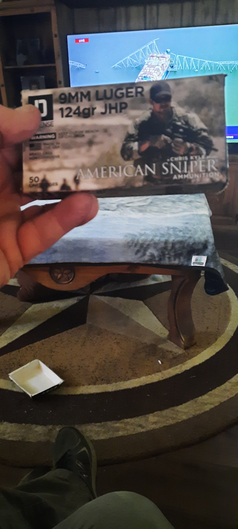

A few months ago I asked if any members had any experience with American Sniper 124gr JHP ammo, no one had ,I took a chance and bought 1K rounds at .39 a round, after 3 trips to the range with 4 different 9mm guns it's a no go on these rounds , I hate to bad mouth this company, as it's associated with Chris Kyle's widow, I don't know how much she actually has to do with the day to day running of the company, but I've had no response from American Sniper , Bought them from Battle Hawke and they refuse to refund, or replace, the ammo will not chamber in 2 glocks one wahlter and one PSA carbine/pistol AR , all other ammo chambers and fires fine, 2 out of 10 will chamber and fire, even had a few get stuck in the chamber and had to knock out with a rod , just ran a box through a lee factory crimp die with out crimp and most needed alot of effort to bottom the die out , tried some blazer brass factory just for comparison and they cycled through the die with no resistance, so I can't recommend this particular ammo , their other ammo has gotten good reviews.

Where on the case is it jamming? I’ve seen some factory rounds that could use a taper crimp. Is that the issue here?

I'm a reloader, I've run 50 thru my lee factory crimp die , the instructions with the die says it will insure all rounds that pass thru it will be to spec , it appears that whoever loads these for american sniper doesn't properly size their brass or the bullets are over sized and cuase the case to expand when the bullet is seated, I'll test fire the 50 I've resized and if they function OK I'll just resize all 1000 of the lot. I can't even find a proper phone # or email address for american sniper , the one I did find was for their apparel and they haven't responded.

Appears to jam on the case mouth , some of the rounds have the bullet pushed back into the case , actually had one fire out of battery on the AR pistol , that was exciting, case had to be extracted with a oversized bore brush , the case head was gone never to be seen again , and my off hand was burned a little , but otherwise no damage.
