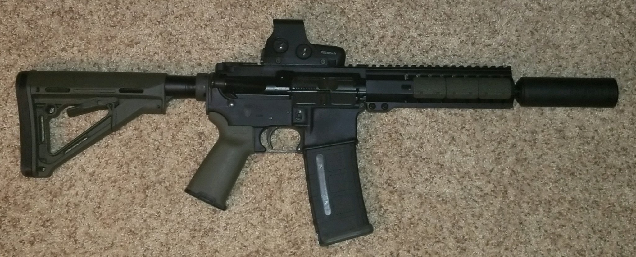

I have an SBR w/4.5” barrel and 6” Form 1 suppressor. It is just a full time giggle machine!
I have used Hahn and PSA mag well inserts for Colt pattern magazines. Both work equally well. I’ve used both the ones that are semi-permanent, requiring the bolt catch to be re-installed, and the ones that insert from the bottom and use a set screw. Both ran just fine. The current setup is a PSA insert that I’ve run a couple thousands rounds with.
No issues with cheap steel case ammo. Sometimes an issue if my 147 reloads run a bit long.
KAW Valley bolt, and blitzkrieg bufffer system.
By far most fun fun I own!
I went with a CMMG Guard upper and ENdomag inserts to Magpul mags.

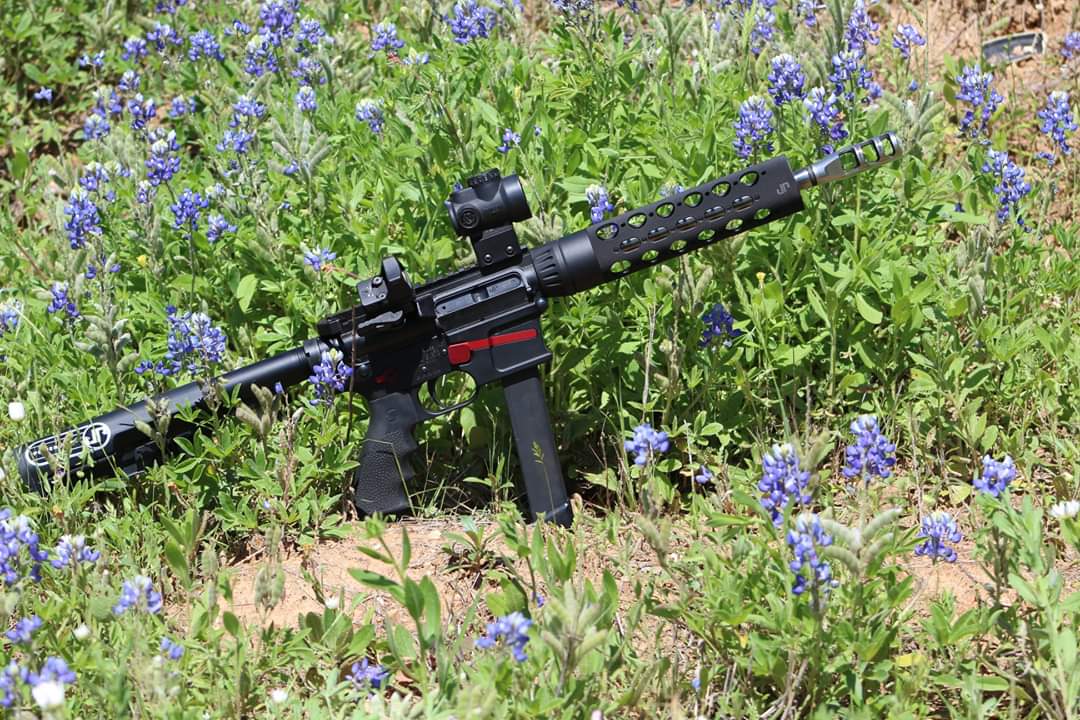

Just build a complete SIG brace gun, Glock mags etc. I used a TROS 3 lug barrel and mine is fun as hell and accurate

I'd strongly suggest ordering a JP GMR15 pistol and doing an online Form 1. I got my Form 1 back in 7 days and the JP is exactly what I wanted. Glock mags, ultra reliable and extremely easy to shoot. My GMRs are loaned out at matches and run a wide array of ammo. 1 gun is over 100,000 rounds of random 9mm food.
