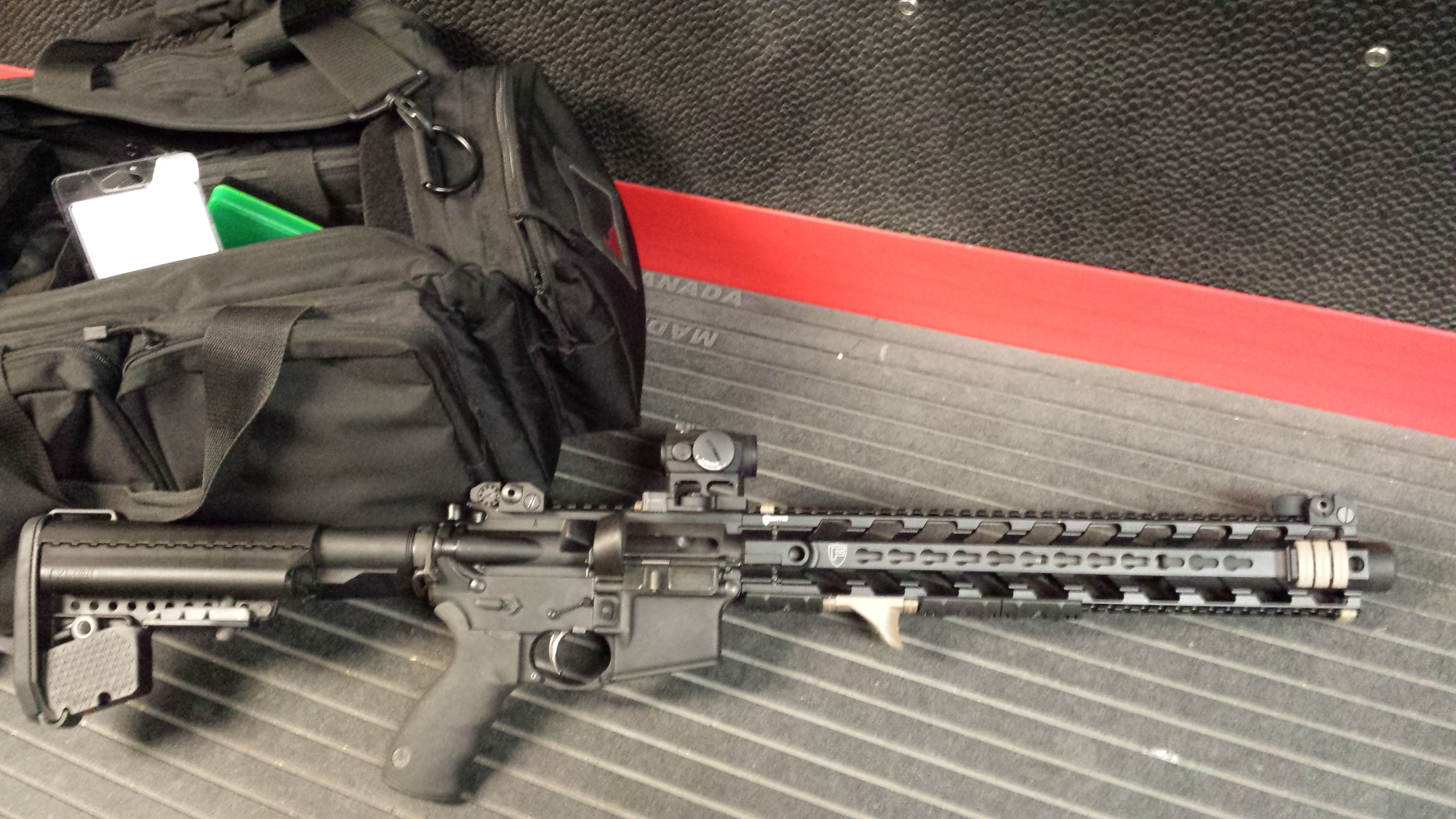

This was my build. CMMG dedicated lower, custom built upper.
