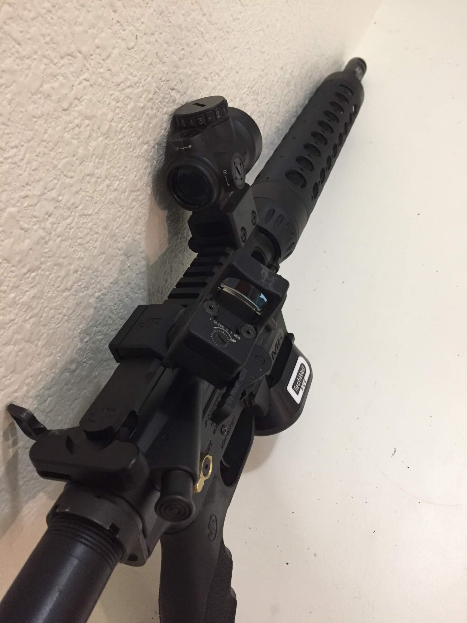

As has been stated I have a dedicated glock lower. Form 1 SBR.
Also built a colt style 16 inch gun and gave it to my daughter.
