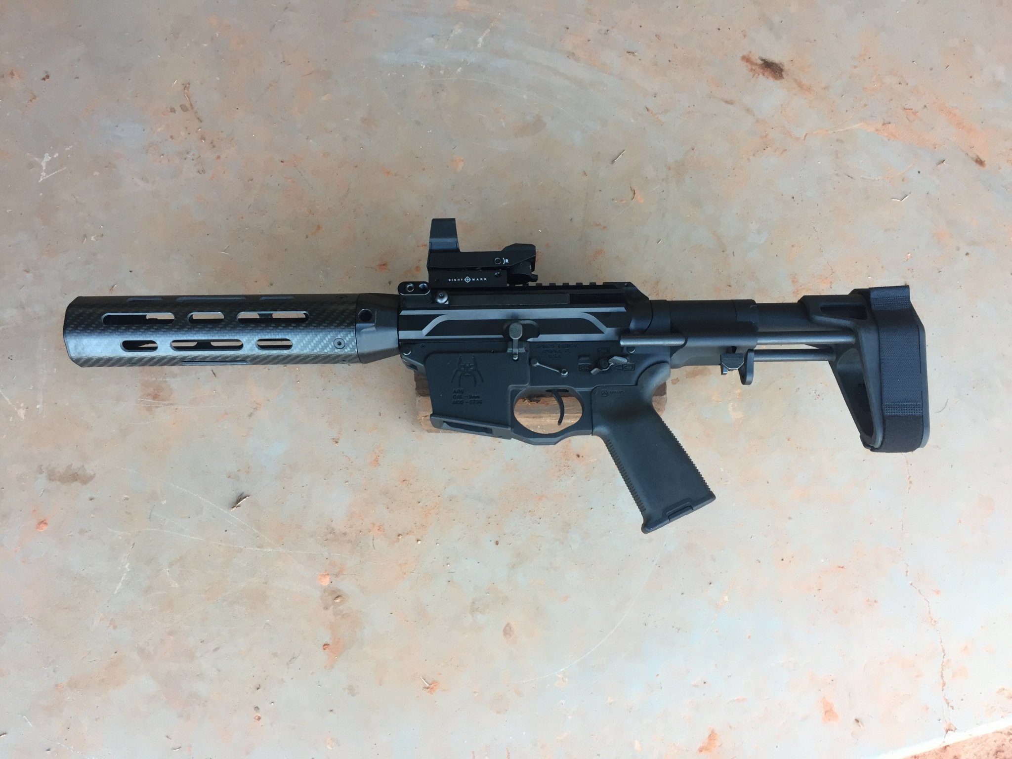

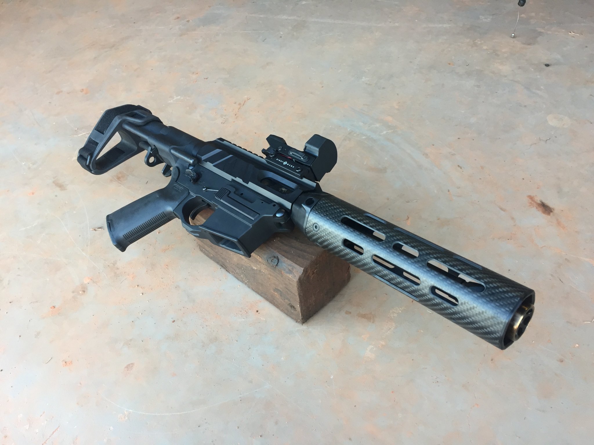

I’m running a dedicated spikes lower with a gibbz side charging upper suppressed, I prefer the side charge it’s easier to use I think. I’ve ran several other upper and lower combos and sometimes the bolt locks back but not always, it doesn’t work on the one I’m running now all the time either, you can mess with it from what I’ve researched but it’s not that big a deal to me.
pics of the Gibbs?
Does it need bolt mod to operate?
No I’m running a spikes bolt in it, these pics were before my can showed up and it’s wearing a sig red dot now, this is also with an 8” barrel and slr comp
