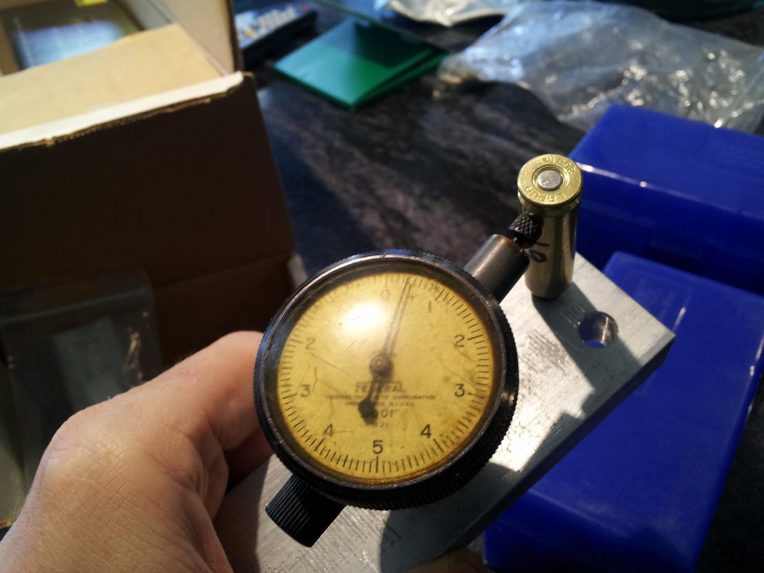

Meanwhile I made a rig to straighten the ones I have loaded. Drilled fixture holes with drill bits a few thousandths at the most over the neck diameters (.260 and .308) and rigged up an old Federal tenths (.0001") indicator I've had sitting around for 3 decades. Finally found a use for it, providing some indication of how far I'm "bending" the cartridges.
I have found that I have to "bend" the case .030" (about 1/32") to get the cartridges to even move... that is, I apply some pressure on the side of the case, note the reading on the indicator, and move the rim end of the cartridge 3 revs (.010" per rev) before the cartridge moves enough see any change in the bullet runout.
