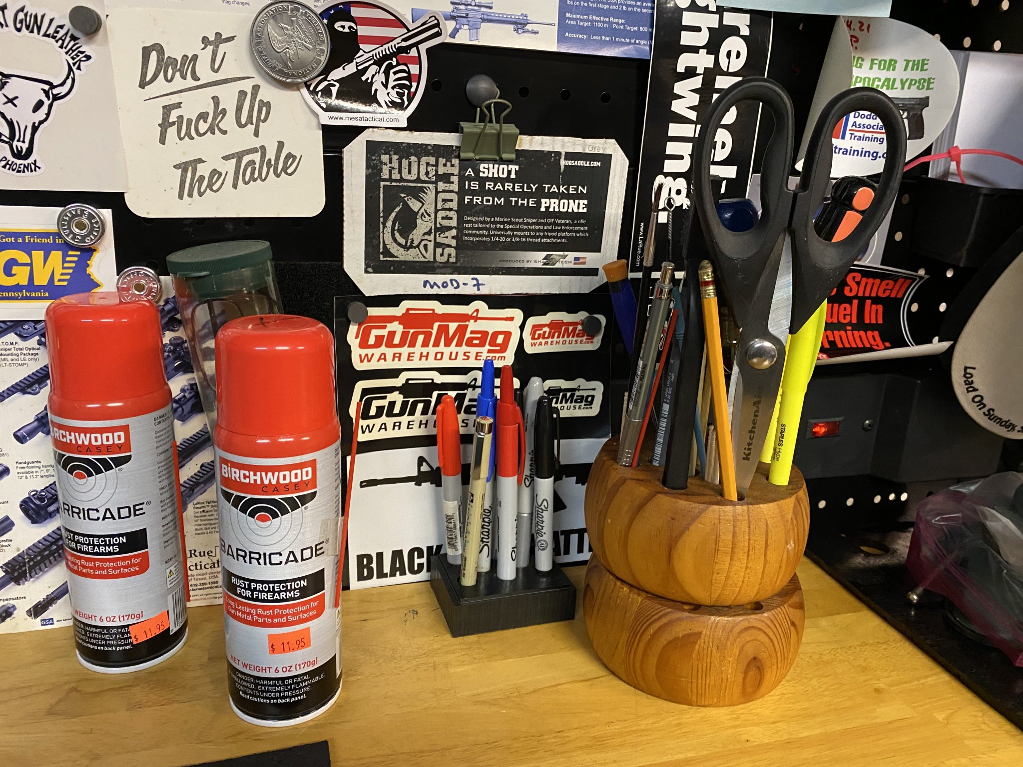

Using Barricade for about 10 years now. Thin and light creeps into fine spaces internally, externally wipe down with moistened microfiber cloths.
Reactions: carbonbased

Using Barricade for about 10 years now. Thin and light creeps into fine spaces internally, externally wipe down with moistened microfiber cloths. View attachment 7806265
I LOVE Barricade and have been using it for decades on my skeet guns. Don't know how long you have been using it, but it used to be called Sheath and they changed the name....dunno why, maybe they thought Sheath sounded too much like a condom! haha
IMO, its great for outside of guns as a rust preventive...yeah, I have seen the articles on testing many various brands of stuff on metal in salt fog....but Barricade works very well and doesn't smell like ass. haha
I suppose it would work just as well on the outside of a bolt....but have never used it for that.
That Bob Marvel's Custom Oil I linked above is apparently a product well liked for semi-auto (AR type) bolts as it lubricates as well as inhibits rust. I have a custom rifle that I bought virtually new from a fella and he used a Seekins action for some obscure reason. The bolt movement was fairly rough when new but a bit of Bob's oil when cleaning and running it a couple of hundred times smoothed it out.
IMO, Barricade is very good for rust but really doesn't offer any lubrication if that's part of the requirement.
Great product and I use the BC Gun Scrubber as an all around solvent for gun cleaning and like it a lot also.
