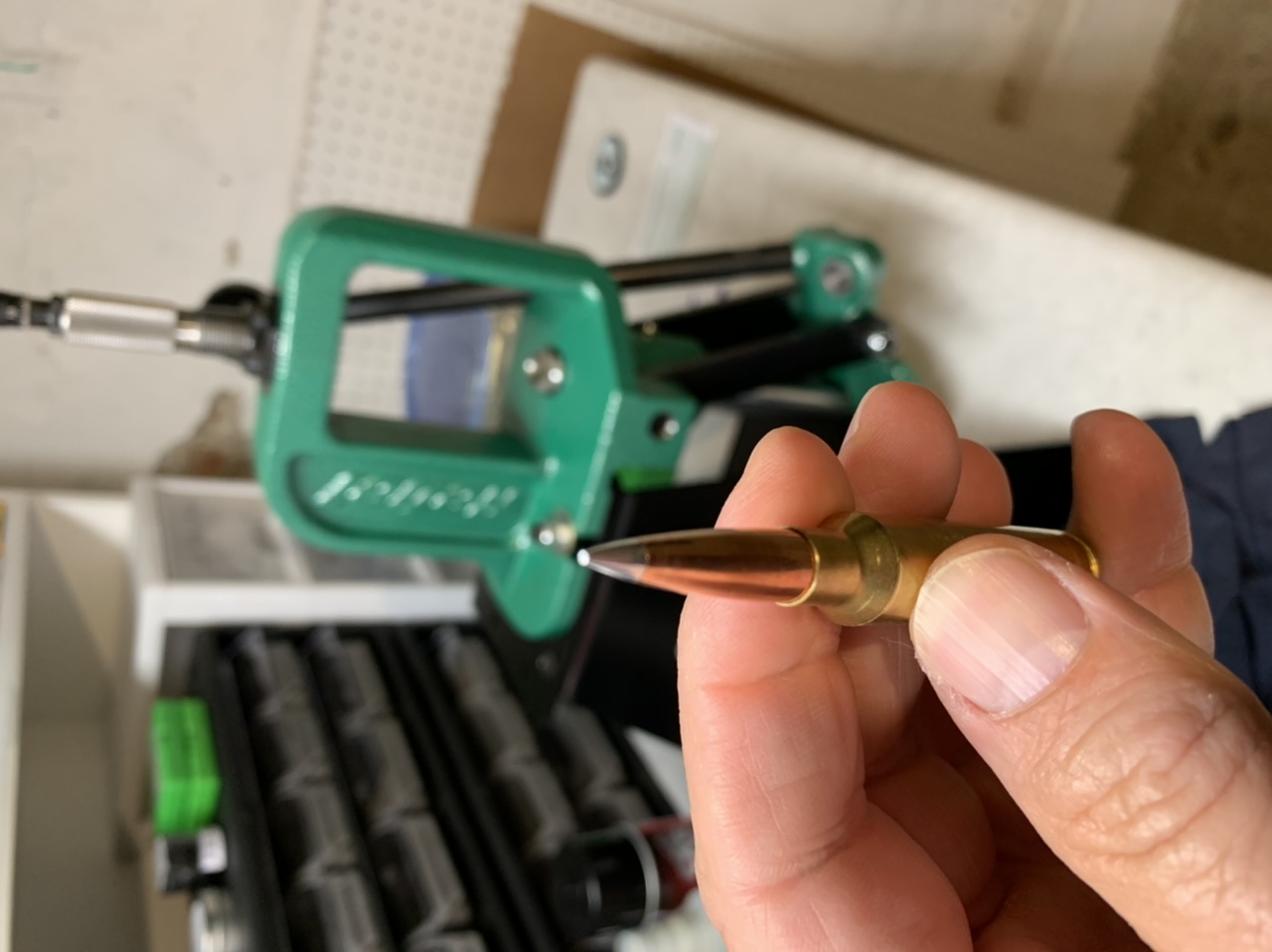

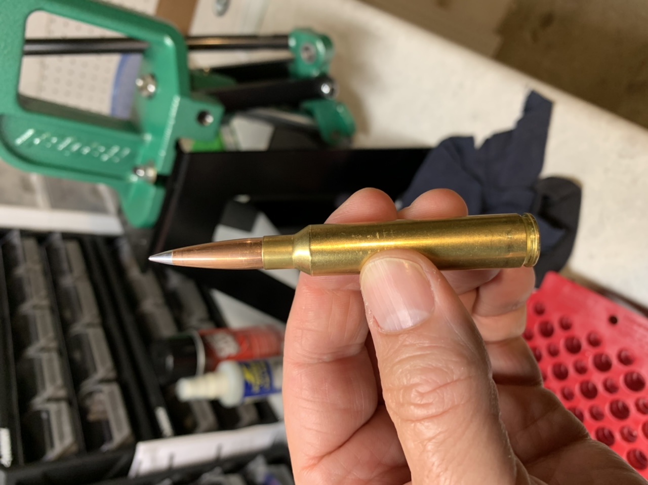

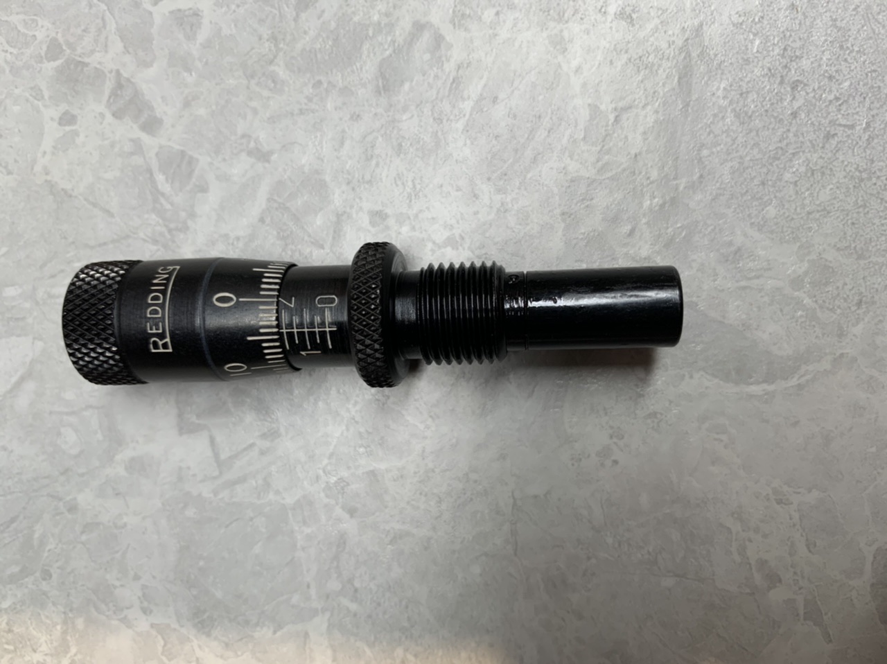

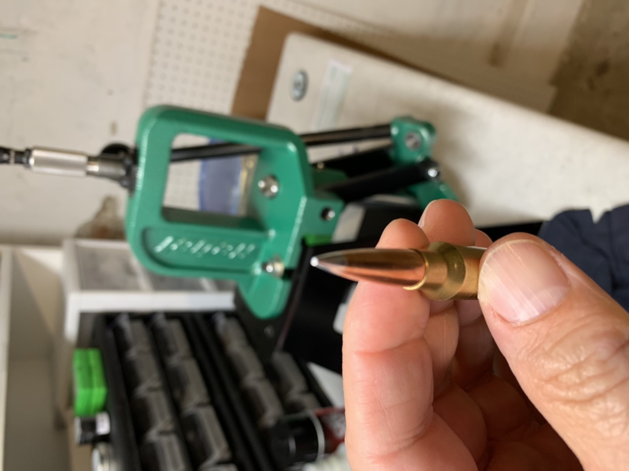

This thread seemed most appropriate to add my comments…

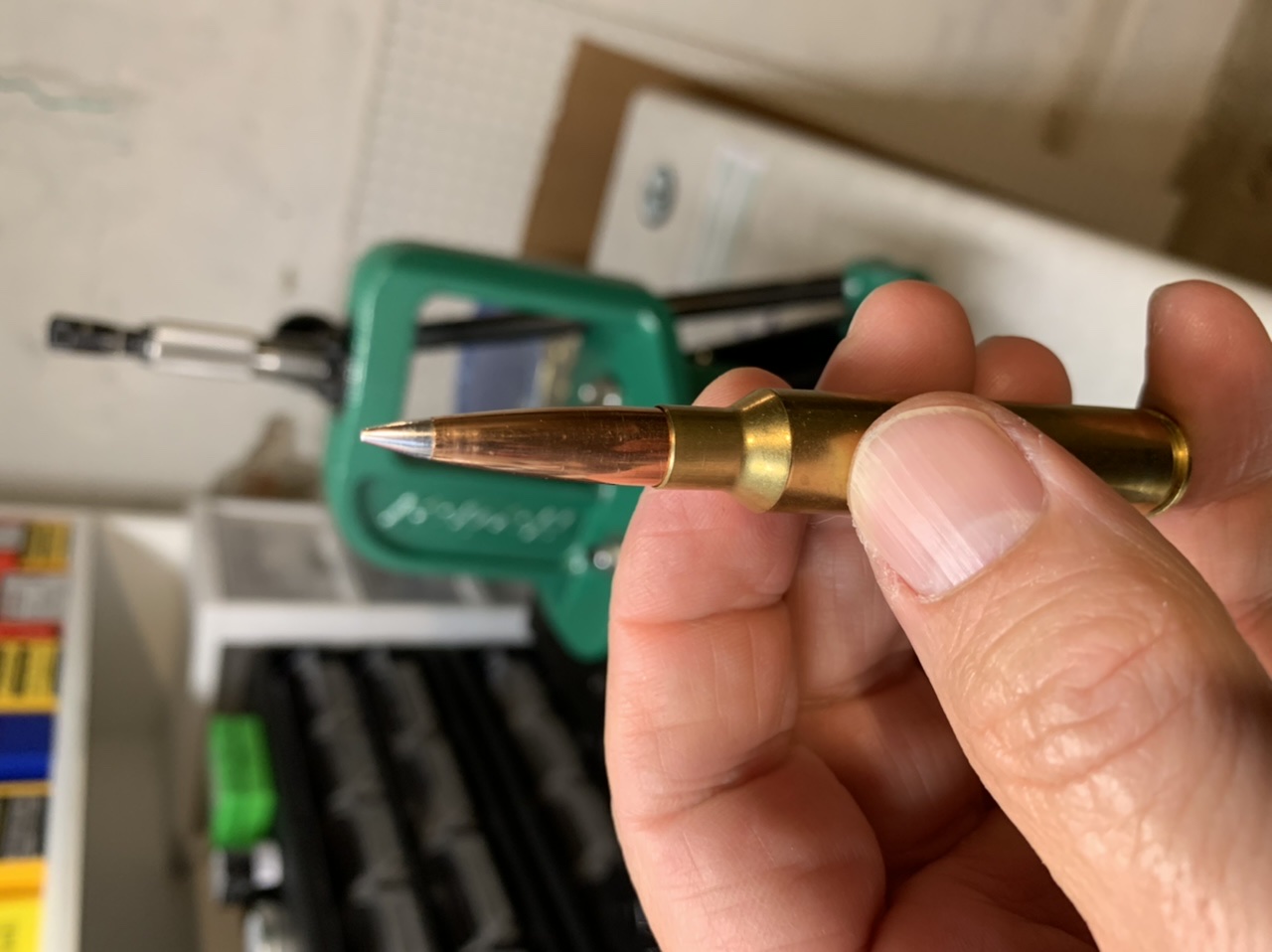

FWIW, I have the below pictured seating micrometer. I just got some .308 250 gr. A-tips and they fit fairly snug. When I push the bullet in there is no wobble. I’m going to give it a try before I buy Hornady dies and special stem.
