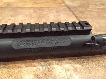

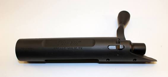

There's two variants, Tac 30 and Tac 30 AW. Does yours have AW written on the side?

Yes, they can be modified to accept AW magazines. I had GA Precision convert mine when I had them build up my Tac 30. I bought it from the first batch many years ago, before Stiller made and marked the actions Tac 30 AW. I do not know what it cost me, it was all in as part of my build.
I think this will end up being taken care of by the builder, and not on my dime. The build sheet called for an AW lefty action, but I didn't get one.
