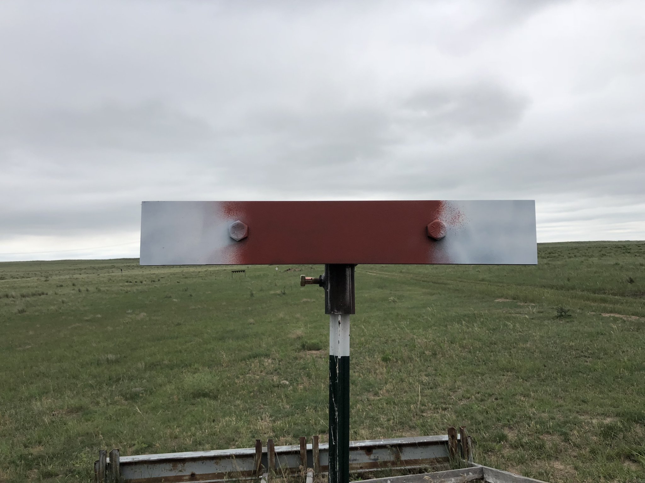

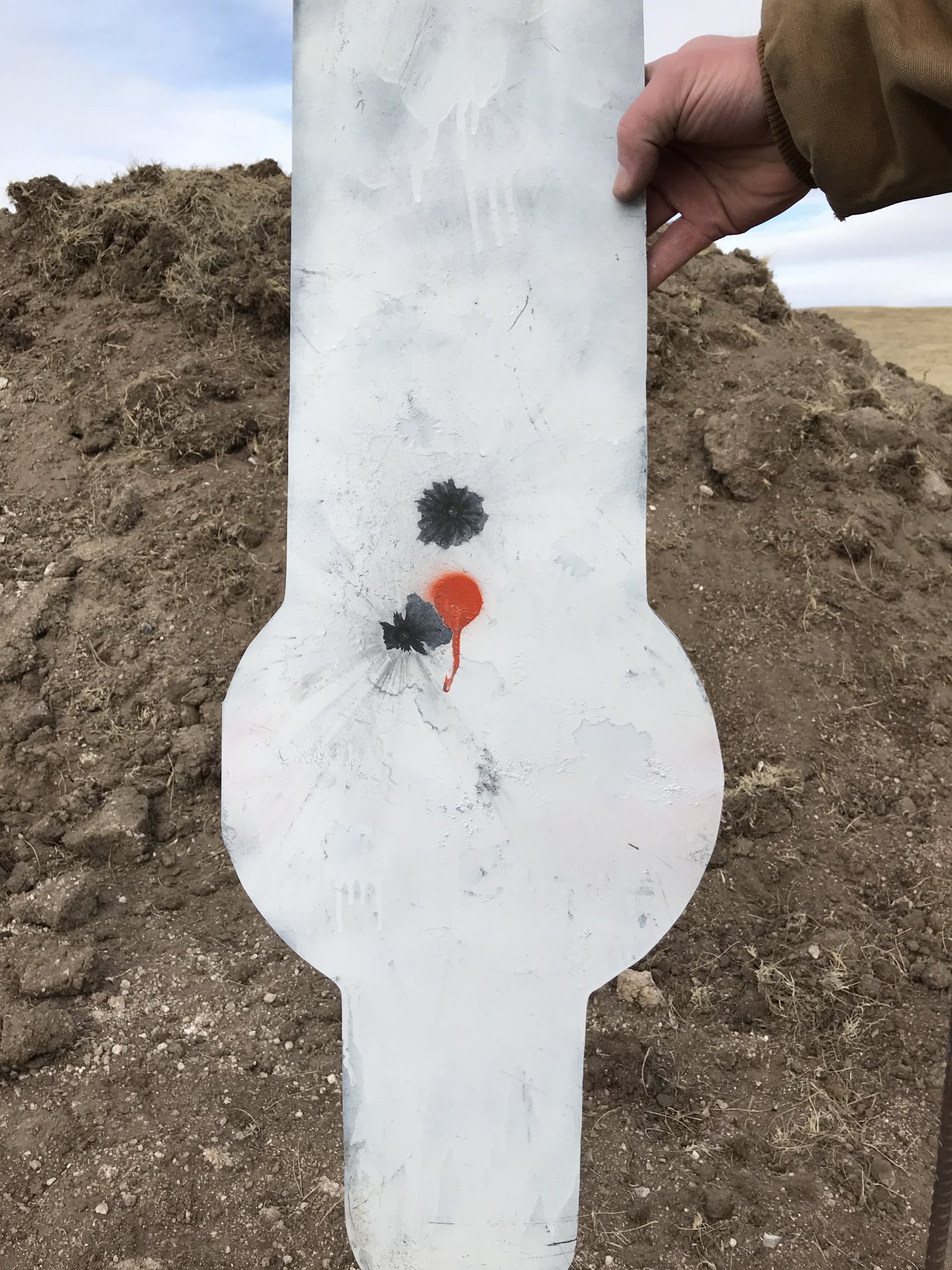

    So after seeing the set up being used at Hatcreek Ranch, where they had one target in front of the other I decided to have Austin Angus of AA Targets build me a complete solution.
    My original thought was to put a MagnetoSpeed T1000 on it, which I did to see how it reacts. Unfortunately, in this first try target, a hit on either the bar or the plate set it off. My goal is to only have it set off by the Bar and not the Plate.
    So I have a solution and a fix and will be relaying that to Austin this weekend.

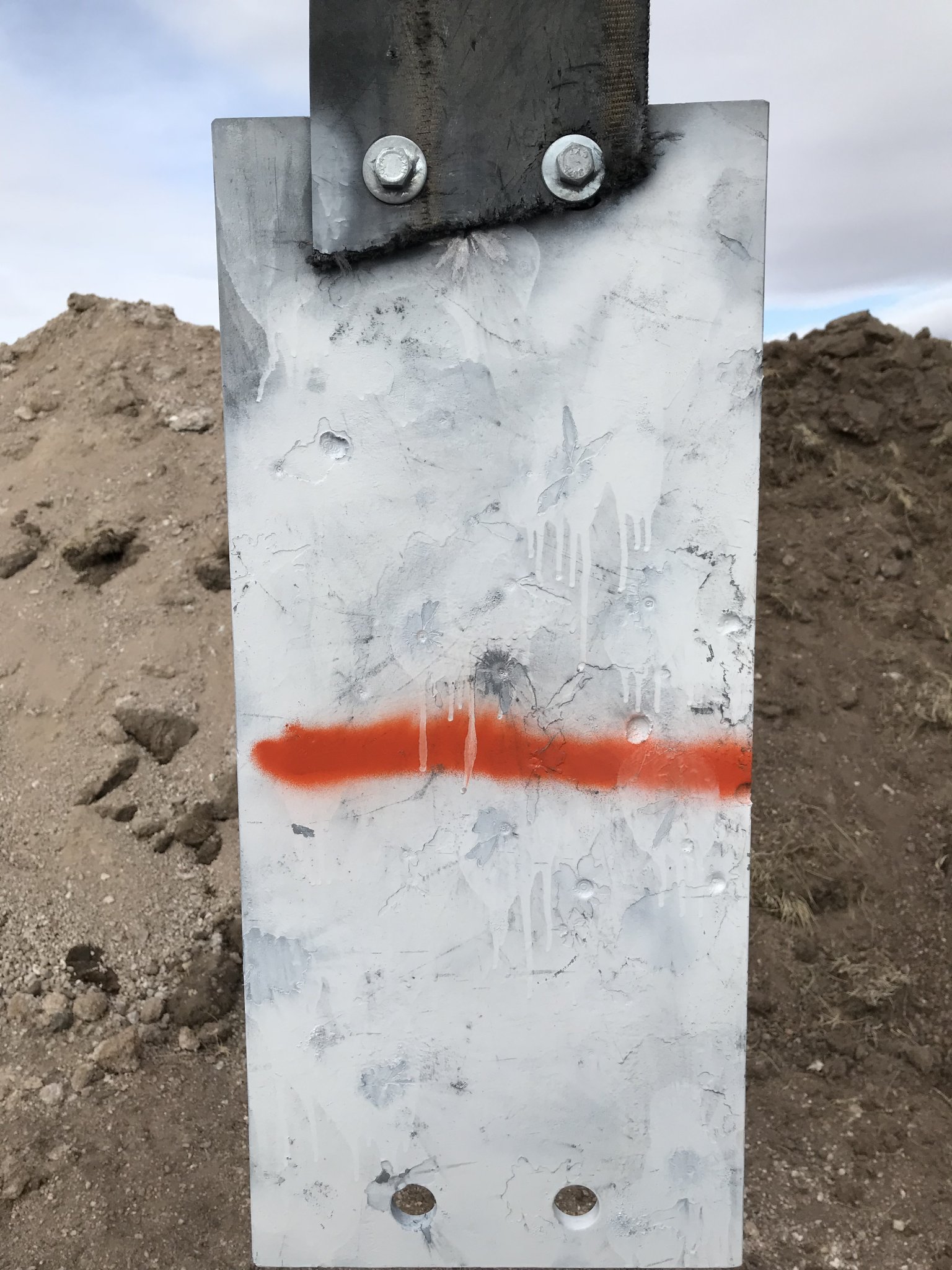

    Still, this is an awesome target, at 800 yards (where it stands) the Bar is .2 Mil wide or 5.75" tall. That gives you a defined aiming point and using the dope from the bar you can easily use it to TRUE your software.
    We start a class tomorrow and I plan on shooting them on it before we dope their rifles to see how it works with their Colorado TRY DOPE before we confirm drops at distance. In other words, for class, we would Chronograph the students, then immediately go to this target. After which we can adjust software and confirm the rest of the drops for precise adjustments.
    My plan is to add 2 more of these to our range, one at 1250 yards, and possibly one at 1000 yards.

    This system eliminates me shooting a three shot group then packing up, driving downrange, determining a correction, driving back and shooting again.
    Old instructor always said dope on paper is your hard dope, Dope on steel without going down and measuring the group on the plate sucks. The plate is forgiving.
    This is trying to get dope on steel closer to groups on paper.
    Not to mention if a whole class of people is shooting it a normal target would get pretty splattered up, this will allow you to see just the bar wiggle instead of the whole plate. Or so one would hope...

    Austin Angus came out to the range we spoke about modifying it a bit.
    And more and more over the weekend shooting, I realized that inside 500 I want "BAR" targets and not circles or 45% IPSCs like we use now. I do like the Diamonds, but to help gets "TRUE" their software, we need targets with a lot less vertical spread.
    Most targets on your average range are easily 2 MOA tall, in some cases more than 4 MOA in height. So what happens is, you get some odd variations in our data. So if I use .2 MIL Bars instead of Circles or Squares, we can start to manage and limit the elevation and being wider, we can absorb new shooters windage errors. Dialing elevation it's not as big a problem, but windage can be.
    Odds are the next version of this will be a Standalone Bar vs the combined unit as posted above. Because my Range does not have a lot of Berms on it, we are a field range, I like the IPSC Backers to help spot misses. With the MagnetoSpeed T1000 Flashers, this will be easy to see and resolve.

    Honestly the channel over the T post help a lot with the sagging, but the back of the two targets work together to hold each other. It's definitely over engineered and we have simplified the idea to a separate bar along with the IPSC so the flashers will work correctly. They have to be separate for the flashes to work and even though they are just mounted on the same T Posts, the flashers react regardless. So we devised a plan fix that.
    But the bracket goes around both. One idea to use is 3 T posts, one for the ISPC then the bracket goes around both, and the Bar is held by 2 Posts
    For simplicity and sales, I believe we are gonna just make a separate bar that can be placed in front of a standard target with a bit of standoff or for ranges with Berms that don't need a target as a backstop, you can get the bar alone as most have an ISPC already.
    Inside 400 yards I am gonna move to "Bar Targets' on a single T Post with no backstop, gonna do 1 MOA bars at 400, 300, 200 yards, Most steel targets at these ranges are far too big, and small swingers like we use now get wailed hard and either fall or swing too much. This fix will give a fine aiming point in bar form. I try using Paper but that is time-consuming
