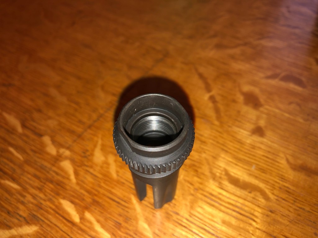

    I’ve got an HS precision in 308. The outside diameter of my barrel is larger than the inside diameter of my factory AAC adaptor that came with my silencer. What can I do to attaché my AAC silencer to my barrel? Any ideas would be greatly appreciated!
    I can only get the factory aac adapter on the barrel with one thread, at best. Then the aac adaptor hits the end of the HS barrel and since the barrel is larger in OD then the adapters ID it won’t thread on any further, if that makes sense

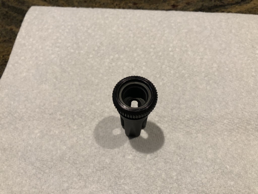

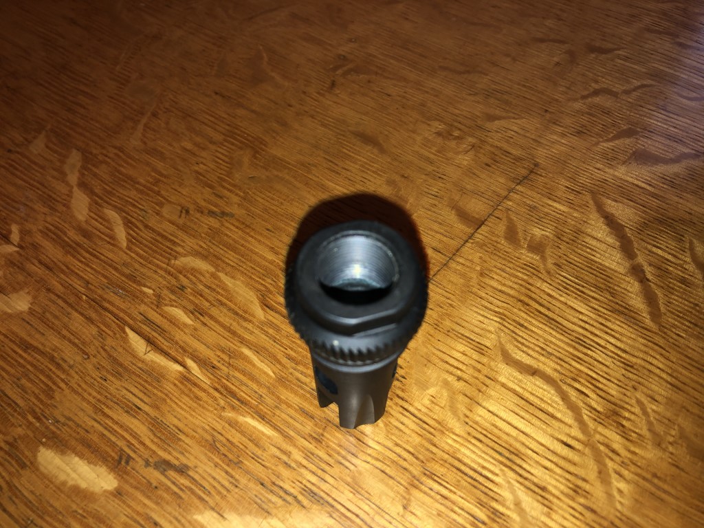

    Happened to run across a couple AAC flash hiders and it dawned on me what OP is probably talking about. At least some of them have a "skirt" that goes over the barrel diameter. For this 5/8x24, a bbl diameter over .810 behind the threads isn't going to fit unless it's turned down a bit. If you don't want to turn down the bbl, you need a flash hider/brake that's flush at the base. Don't know much about AAC adapters but I've got one that is flush (Brakeout?) so there might be others.
    Skirt
    Flush
    Skirt
    Flush
    YES!! a flush mount AAC adapter would resolve the issue.

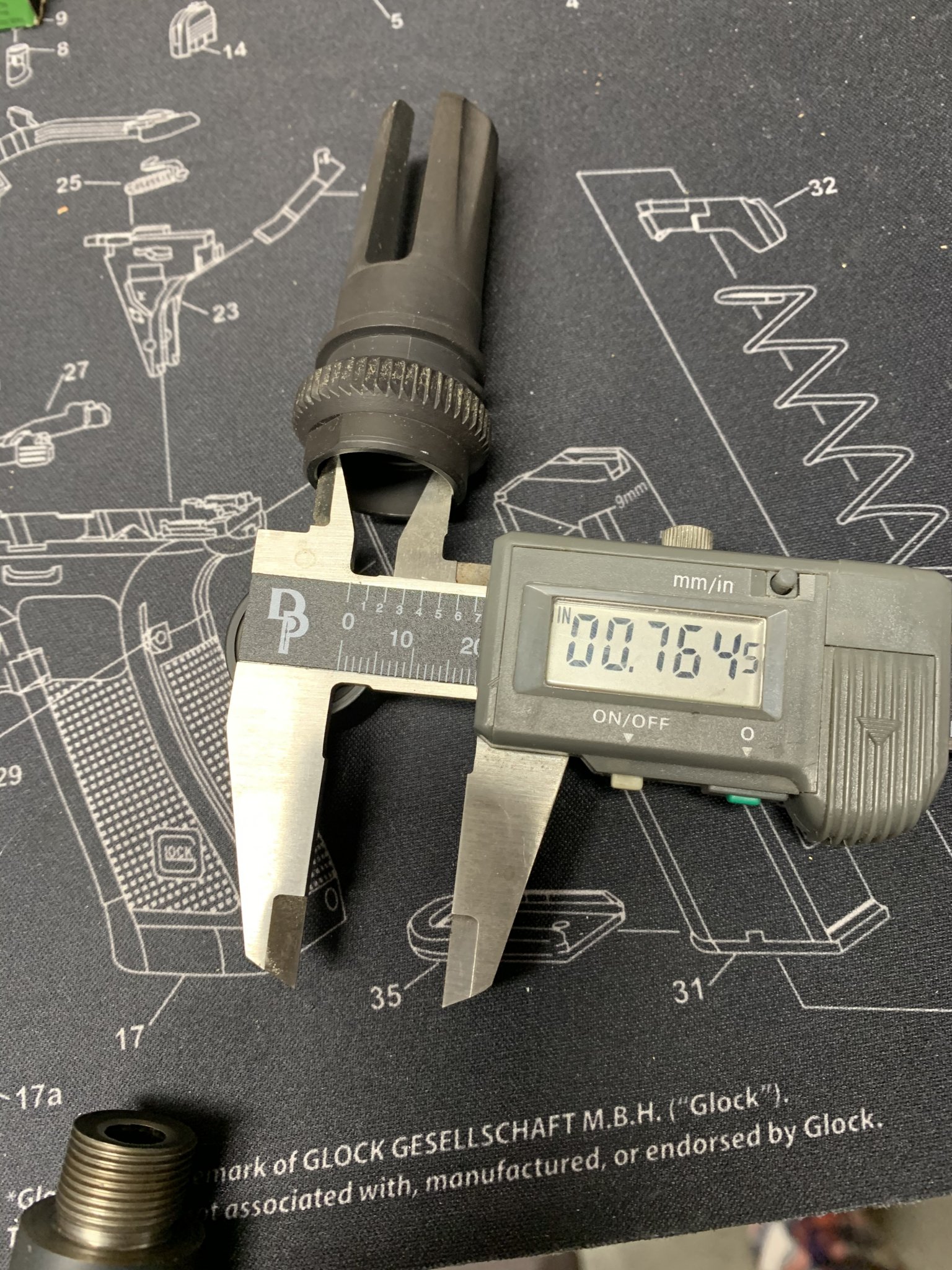

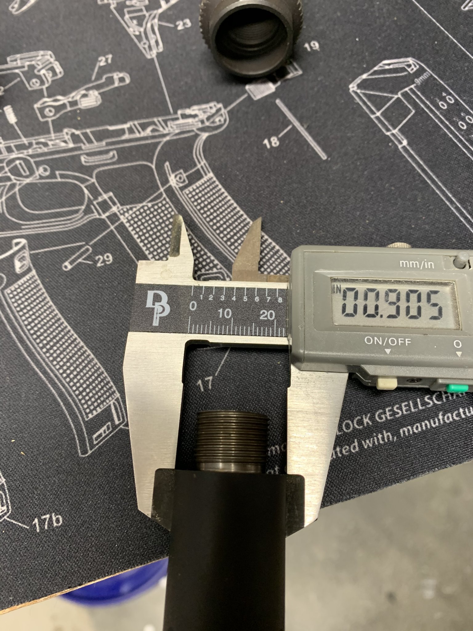

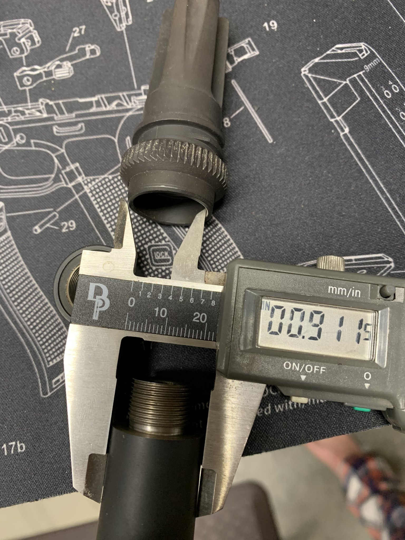

    Was struggling to get pictures that would accurately tell the story, hoping the ones I attached here helped
    Either buy a flush mounted break adapter.
    Or, have a Smith turn down the end of your barrel to accept the skirt of the hider.
    Or have the Smith turn the skirt off the hider.
    Easiest might be to just find a flush adapter, of course with Remington going bankrupt it might make it difficult to find one.
