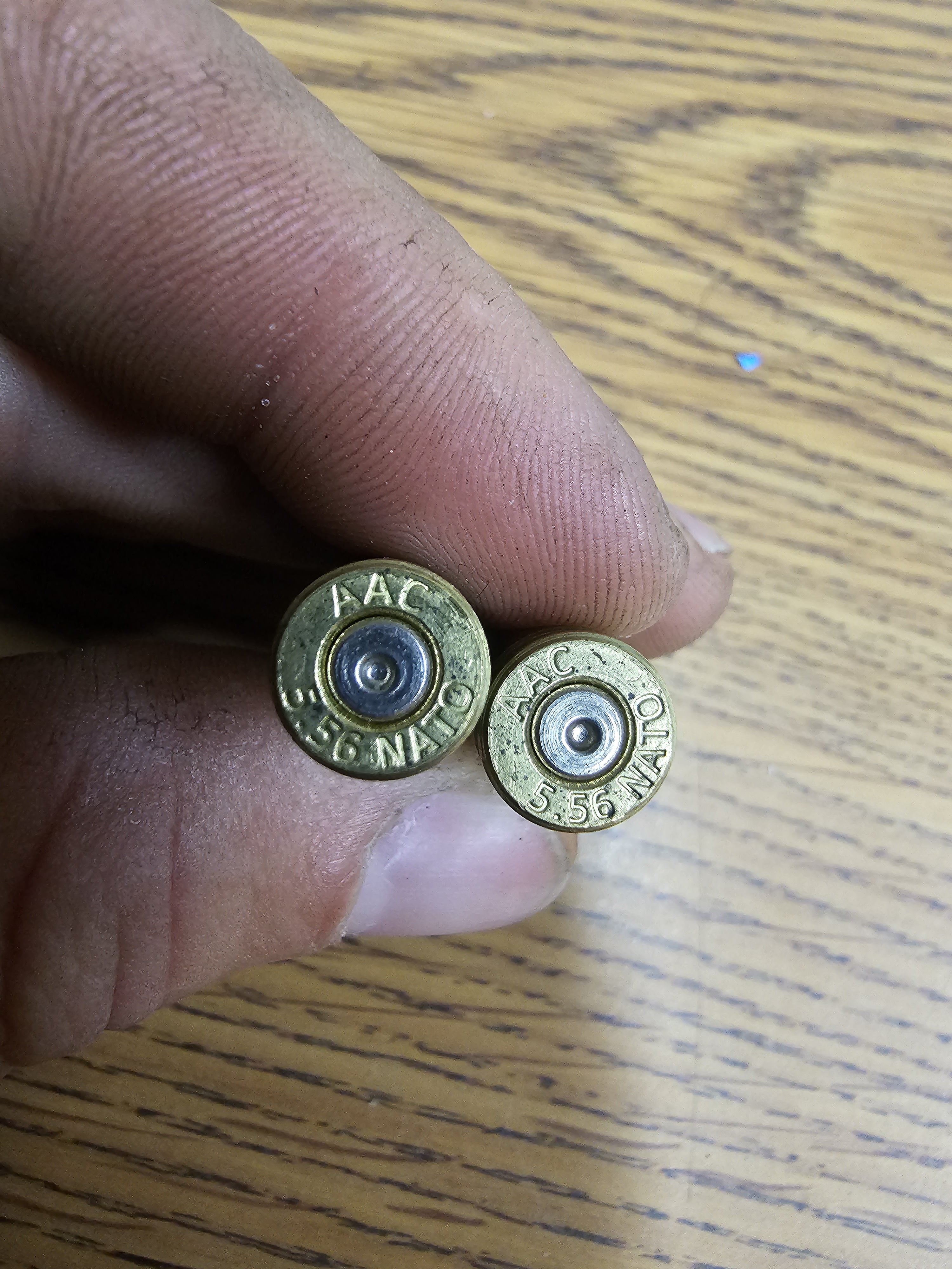

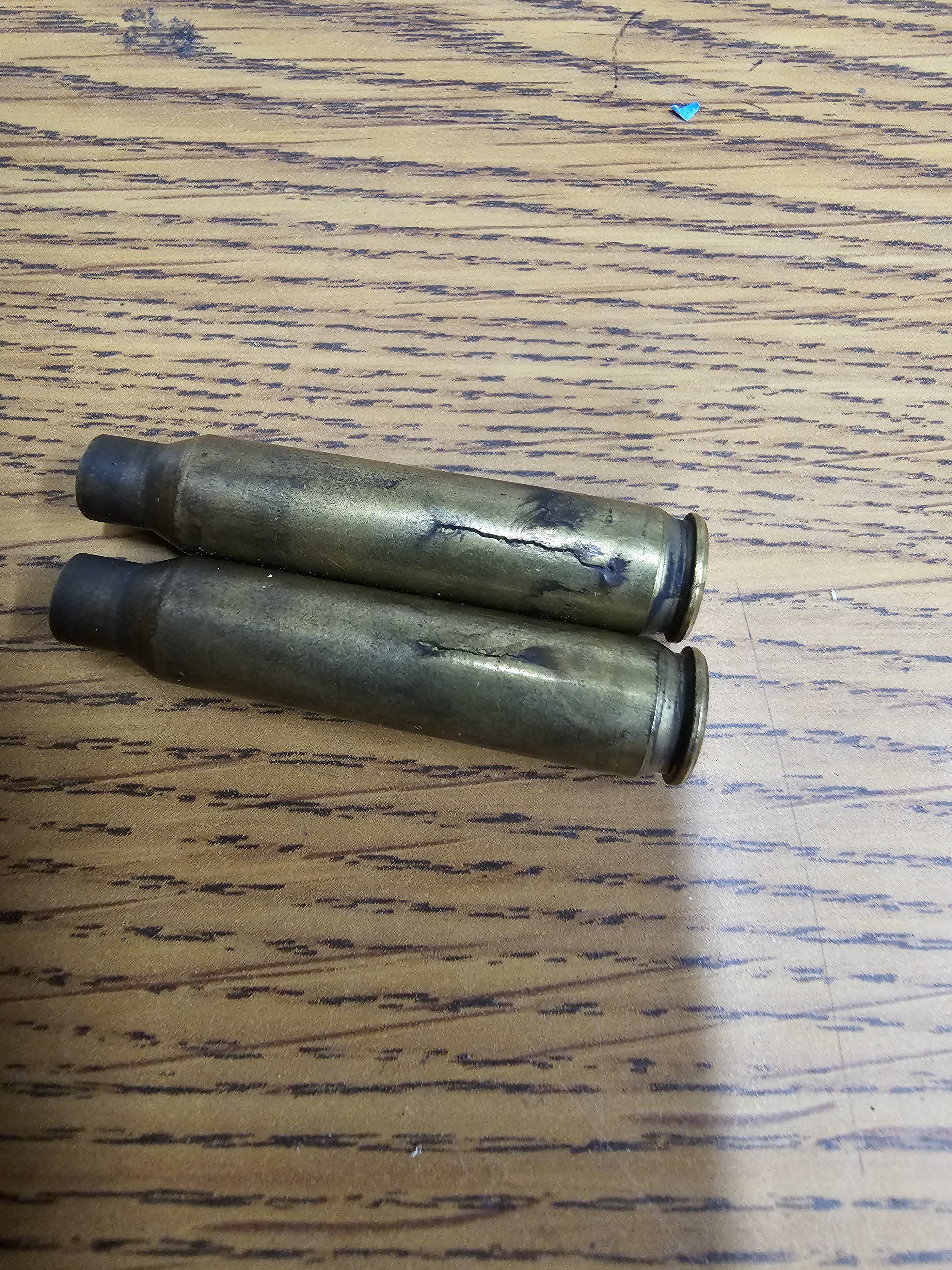

    Here are just 2 I grabbed last night, there are more somewhere but didn't look to hard for them. And I forgot to check date of Mfg
    I also have had a handful of split cases. Posted here and elsewhere. 77OTM and 75SB only. Shot a lot of AAC 75HPBT and 77SMK, but never had a split case with those. Personally I think some of their brass is weak. Some reloaders have said it's only good for 2 loading.
    Could be my chamber (BMP chambered Hawk Hill 223 Wylde) , but it's never happened with any other ammo.
    Doesn't cause a flier at all, so not overcharged.
    Maybe just tolerance stacking, not a big issue for me, but it definitely happens.
    Ill be buying more once they get their normal powder back.
    barrels and chambers matter. what was this thru?
    i had a criterion barrel that would split cases and pop primers when no other barrel would.
    As I stated in an earlier post this is out of a Ballistic Adv. barrel with a 1-8 Wylde chamber that I have thousands of rounds down with no other ammo that this has happened with. Including rather hot handloads with 77gr bthp.
    These are splitting because of the case drawing operation had a problem. The brass gets thin on one side and this happens. It happens to EVERY brand of ammo. Some it just happens more often. Most people don't reload and don't pick up their brass so they would never know about it

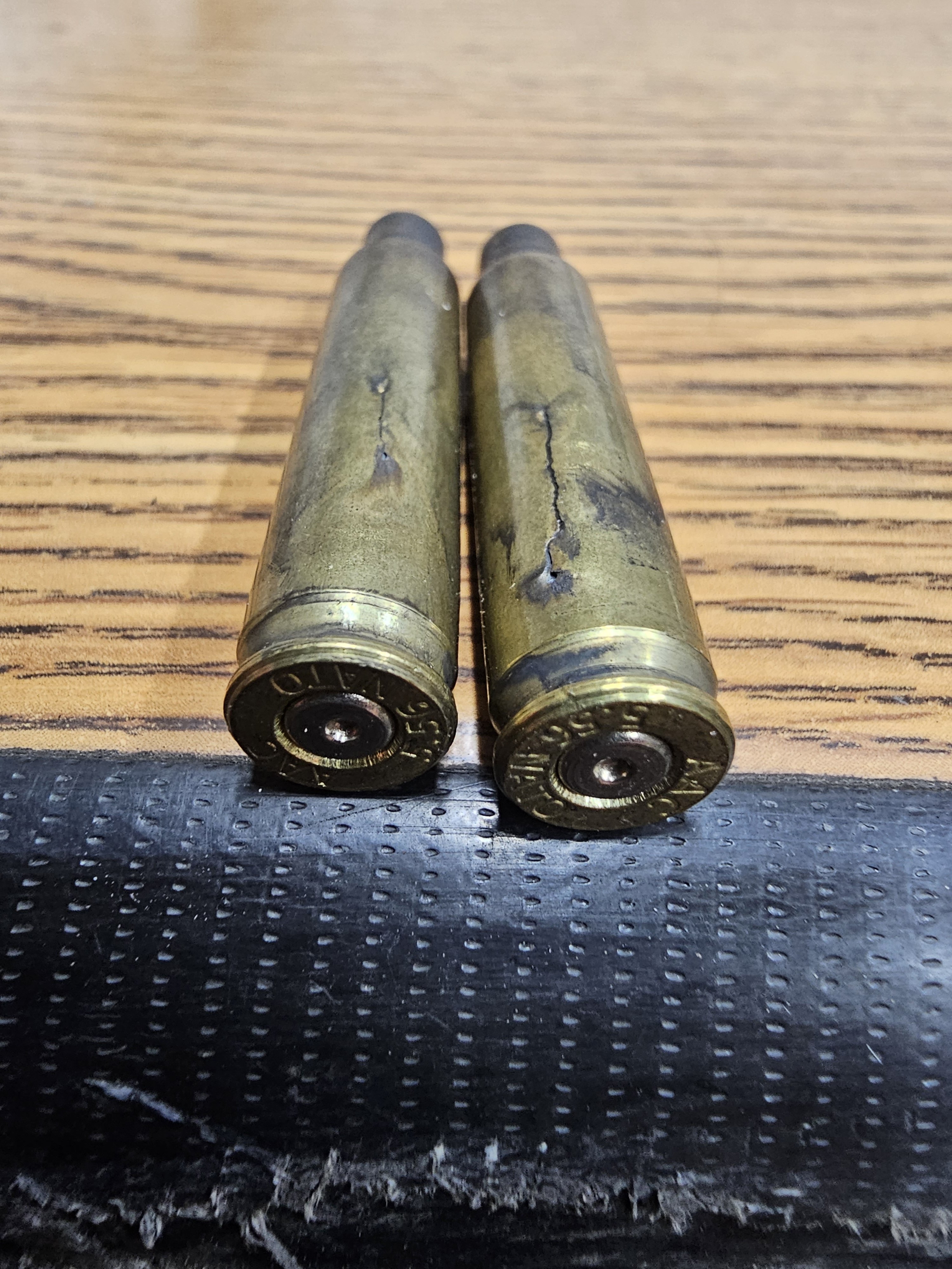

    Not quite the “whole length of the case”…
    I see this in about 10% of all the AAC cases I fire in my .223 AI chamber, but don’t see it at all in my AR’s until about the third reloading. Definitely a manufacturing issue that shows itself more in certain chambers.
    You are correct on fixing my quote in regards to these to cases, however some of the cases i did not find in my pile do to not looking did have worse cracks then these. still not acceptable imo no matter the size from factory ammo.
