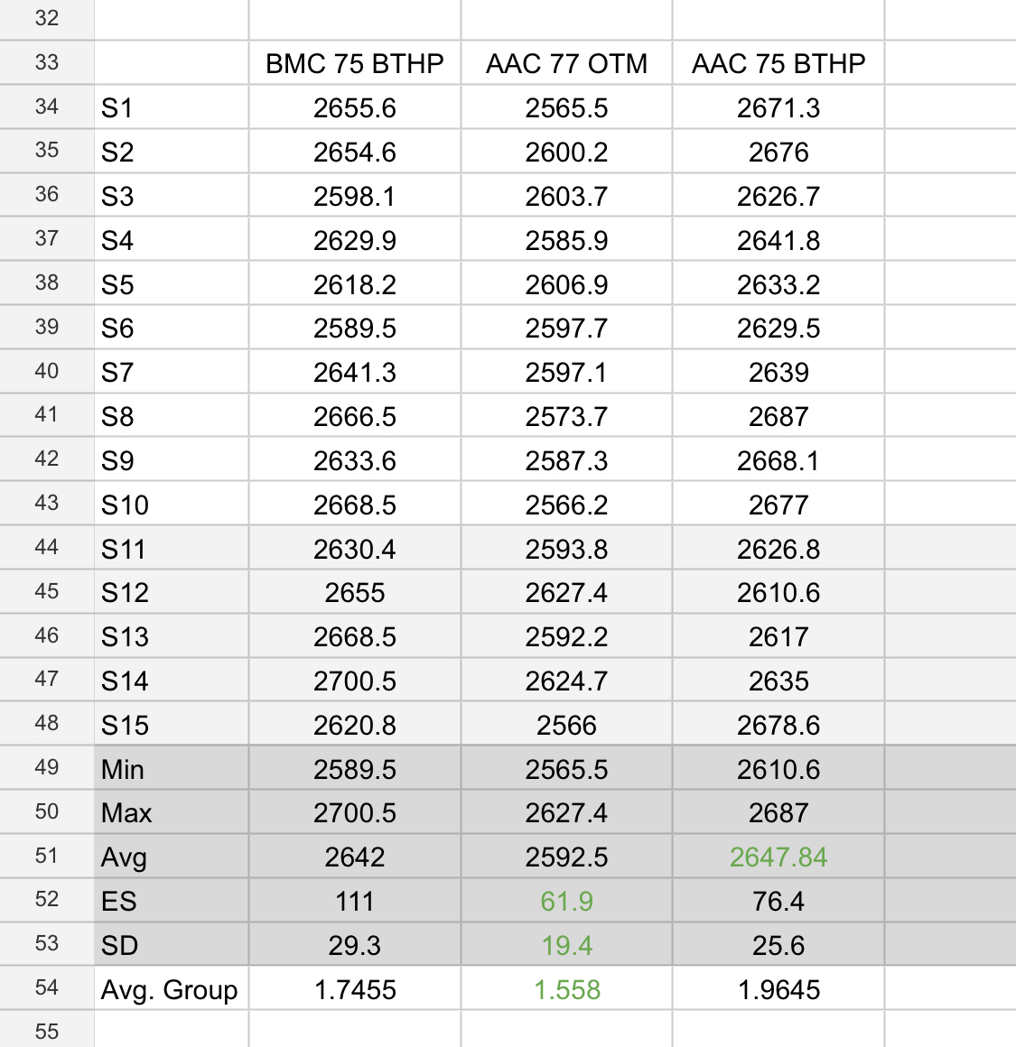

Quick session today testing out the Garmin Xero chrono and a few different loads. Data was surprising with the AAC 77 OTM having both the lowest average group size and SD of the three match ammo types tested. Currently, the BMC 75 BTHP is my go to match ammo, but that’ll change after seeing this data set.
Shot 10 rounds of each for group 1, then a second 5 round group. Avg. Group is an average size of both group 1 and 2. All velocities shown.
Barrel used is a BRT 16” Optimum. Atlas CAL gen 2 bipod/rear bag for shooting. Trijicon VCOG 1-8 SCO optic. ~55-60*, mild to no wind, 100y.

Quick update. Shot some more yesterday and got higher velocities. Data shown is from a 10 round shot string.
Min: 2589.9
Max: 2674
Avg: 2629
ES: 88.1
SD: 22.6

In comparison, the AAC 55 FMJ produced an average of 2914, ES of 145, SD of 43.4. Wolf Gold has had the lowest SD of the “55 FMJ” loadings at 17.3 and PMC at 25.5!
