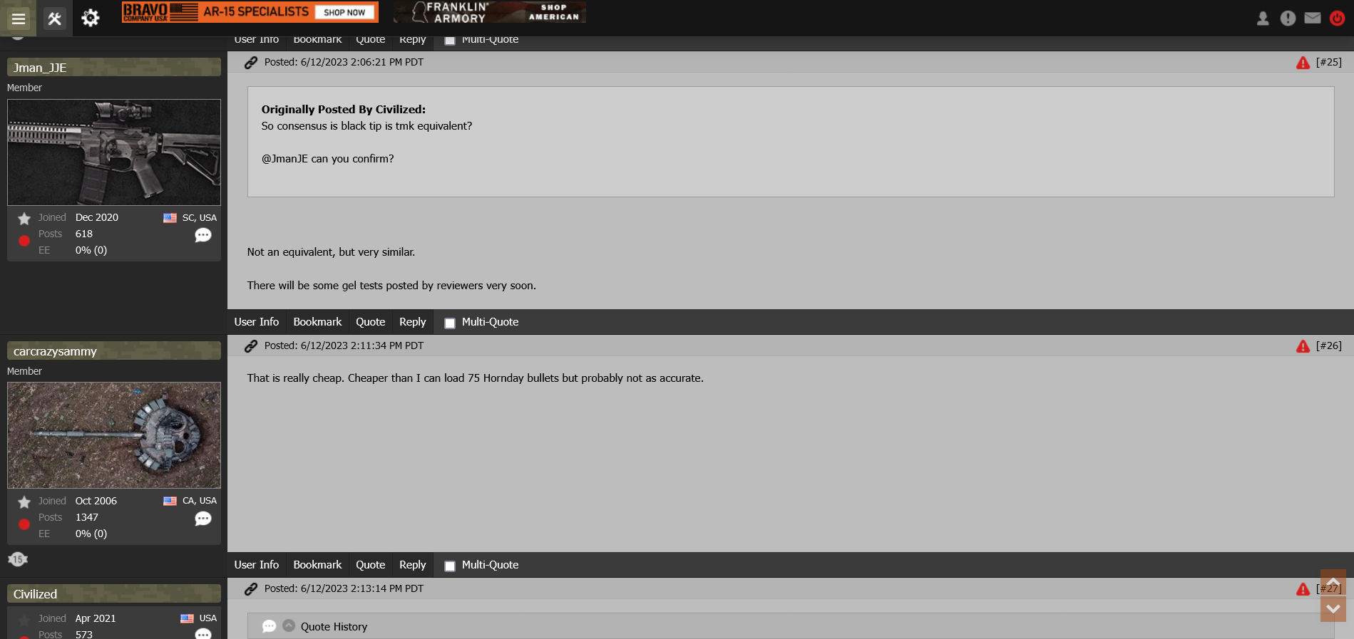

Jamin himself has said it is not bonded, but is similar to the TMK.

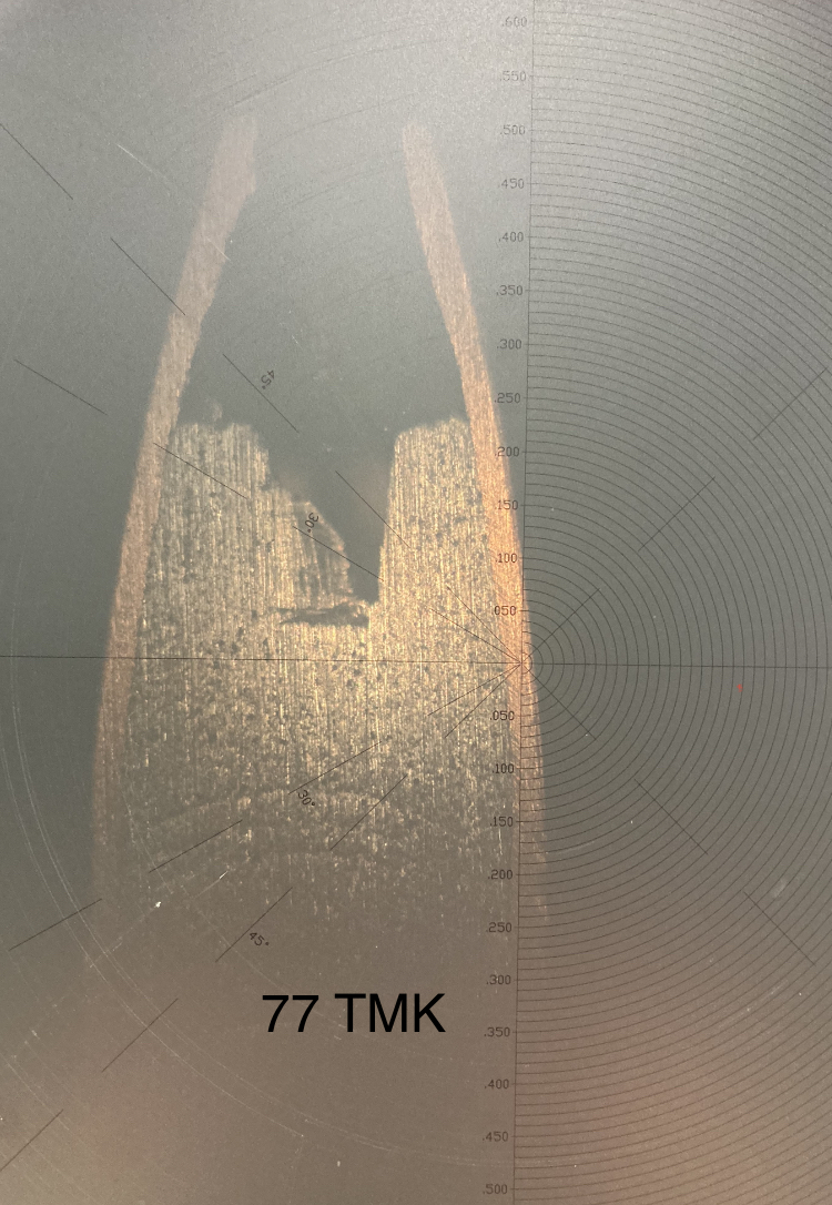

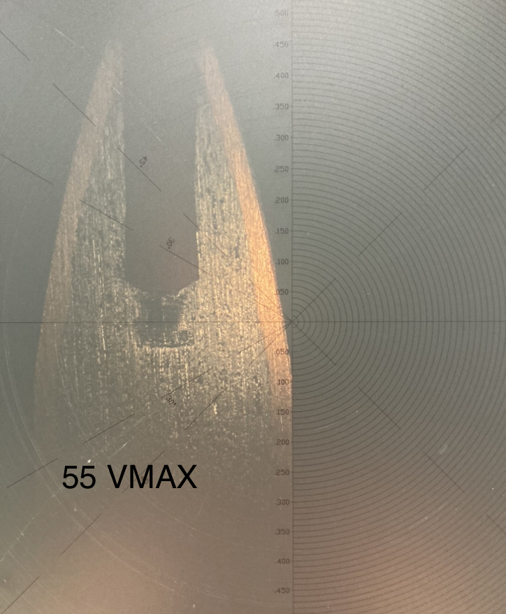

77 TMK, 75 Sabre, 55 Vmax, 75 ELDM.
Looks kind of like a 55 Vmax with a BT, Different angle on the BT than a 77 TMK… So not a direct copy.

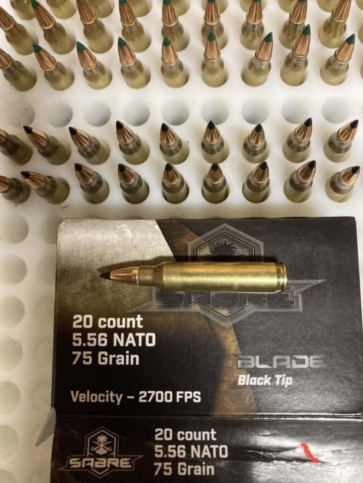

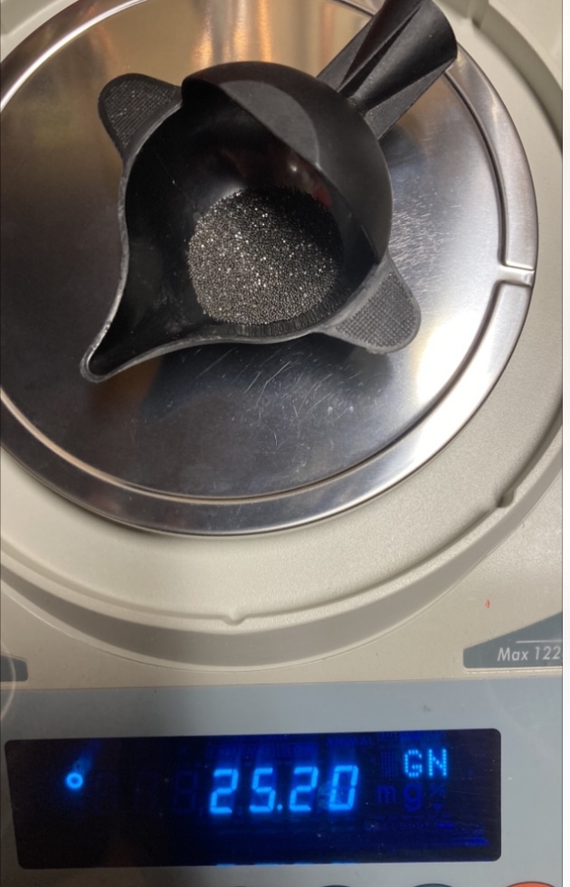

Same charge weight in my 75gr SBBT ammo. What lot # if you please.
Mine is SCL2CF081
Those are respectable velocities for the 62gr SBBT, I have the same lot #.

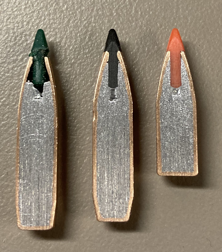

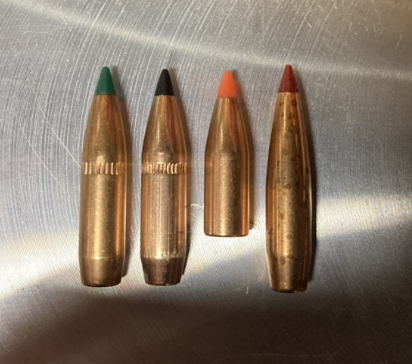

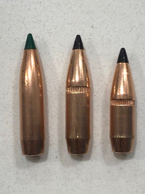

Here is the 62gr as well...( all pulled from AAC loads ) next to the 77gr TMK, and the 75gr SBBT.
Reactions: towerofpower93

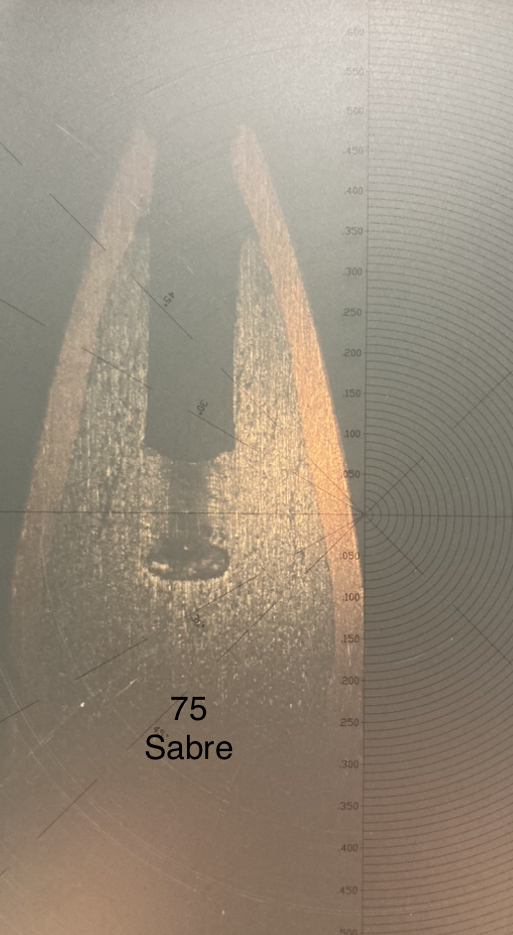

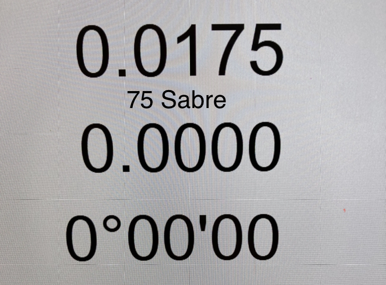

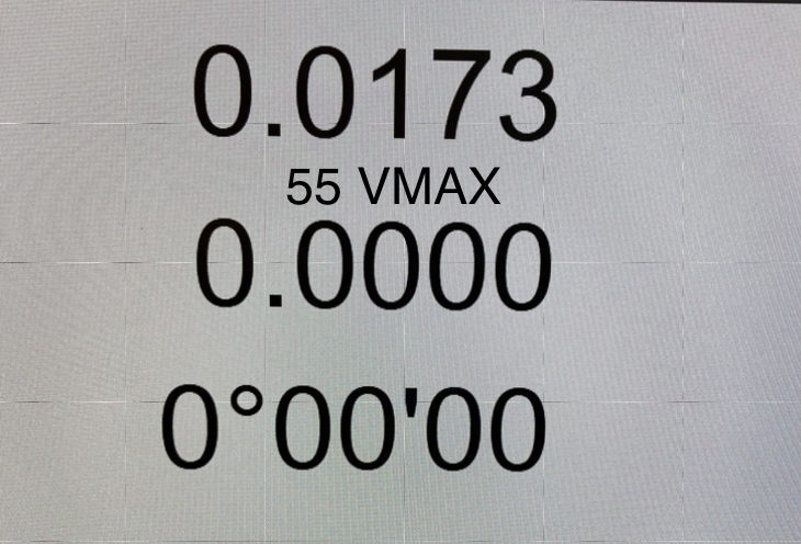

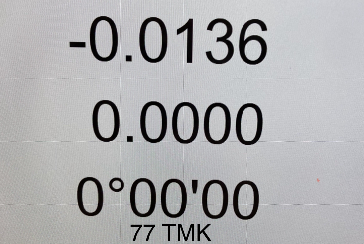

Jacket thickness on the above measured on an Optical Comparitor.
This is cool to see and thanks for the info! Do you know the jacket thickness of a 77gr SMK by chance? I would suspect this won't fragment to quite the same ranges at the TMK but for typical distances it probably doesn't matter
You the man.
Thank You for sharing.
How did you cut them ?..../ As in, is this something a dimwit like myself could readily do at home ?
And the optical comparator , please tell me more... hand held ? Inexpensive enough for its purpose ?
How does it work ?
You the man.
Milling machine and an endmill. Sanded with some 3M superfine to remove burrs.
The TMK tip spun and got ripped out as it was not held by much.

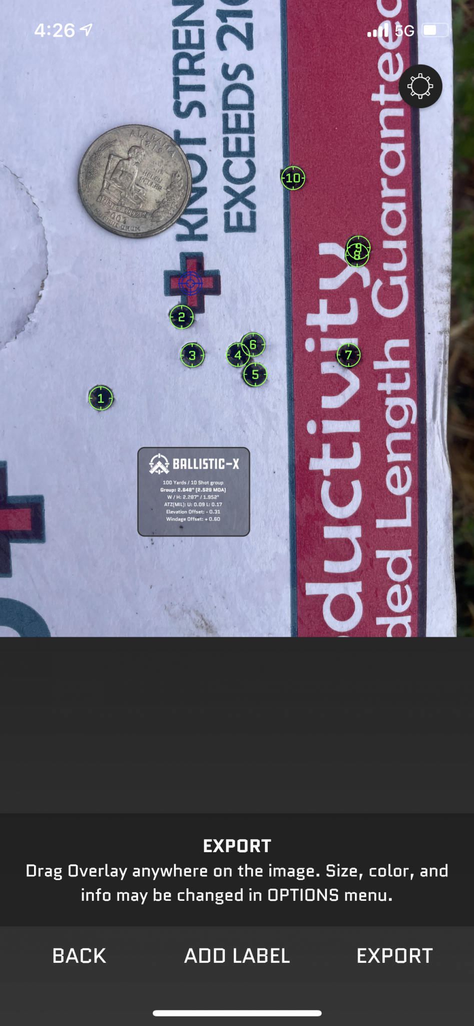

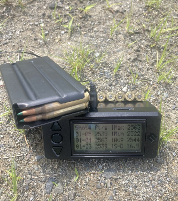

Made it to the range this AM, chrono'd some various rounds and shot groups.
ZERO function issues, 100% reliable
The AAC / PSA Sabre Blade Black Tip bullets are similar in construction to the Sierra TMK.
This thread isn't about the SBBT's terminal performance. Ballistic gel tests concerning that are coming as/per Jamin w/ PSA
Rifle is a 20" 1n7.7 twist Krieger barrel. ( I consider this to be a "fast" barrel, so YMMV ) 100yds, Benched , bagged, scoped, etc.
The 75gr AAC SBBT ( lot # SCL2CF081 ) chrono'd at an average of 2704fps, ES of 39fps, SD of 11.0
The first 10rd group is great, I must have aligned all the Shooting Gods stars. Lol
Next 11rds..( oops ) still darned good for the price.
Next 9rds, again oops...

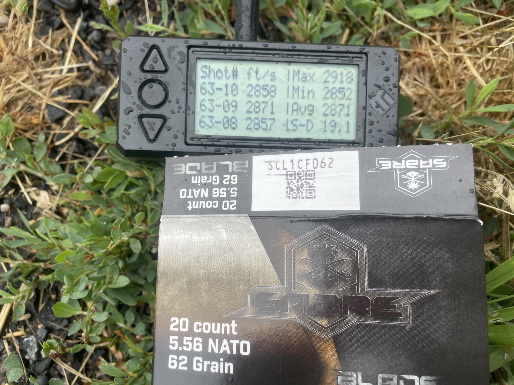

The AAC 62gr SBBT ( lot # SCL1CF062 ) chrono'd at an average of 2997fps, ES of 90fps, SD of 32.3
10rds
10rds... much more horizontal group, I will blame some of that on me.
All in all, I am quite happy with both. ESPECIALLY concerning the price. ( Thank You @JMan_JJE )

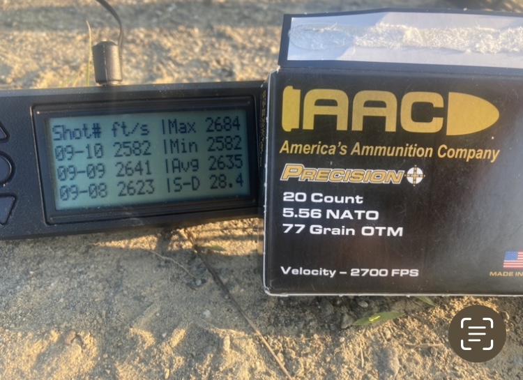

I'm gonna have to chrono my aac 77 otm. Hopefully they run as good as the Saber and boomhauers tmk loads. That Saber load s-d was super impressive for cheap factory ammo.

Same rifle as above. Similar groups.

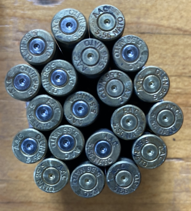

Never looked at the brass yesterday.
It is certainly on the hot side.

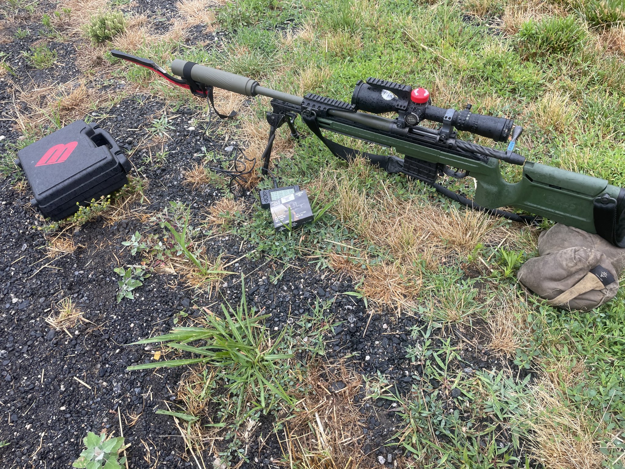

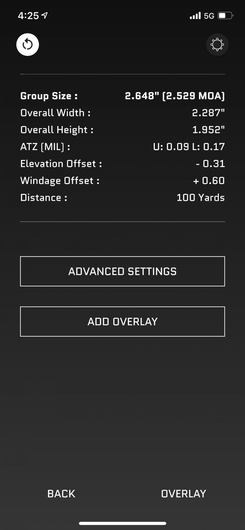

75 sabre groups at 300 and 500.
Counted wrong and shot 9 @ 300 and 11 @ 500.
Optic was a Burris 1-6 on the 13.9 P&W.
