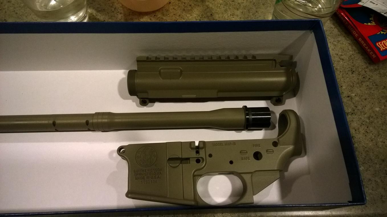

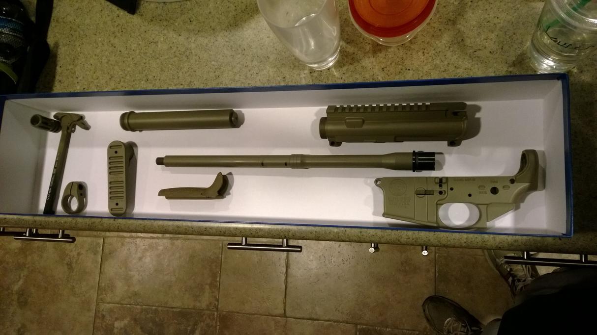

So I finished my alumahyde project. Everything came out fantastic. There is one thing I did not consider and that is the added thickness of my Threaded parts. Particularly the buffer tube. Any good ways to take down the the finish on the threads to allow easier reassembly?
Dang, you're making me wish I had done that before my recent build. Looks fantastic! I've heard acetone will take it off, so if you put some on a rag you should be able to strip the threads carefully. No personal experience though. If not, a fine abrasive cloth might do the trick if you can get it down inside the threads.
