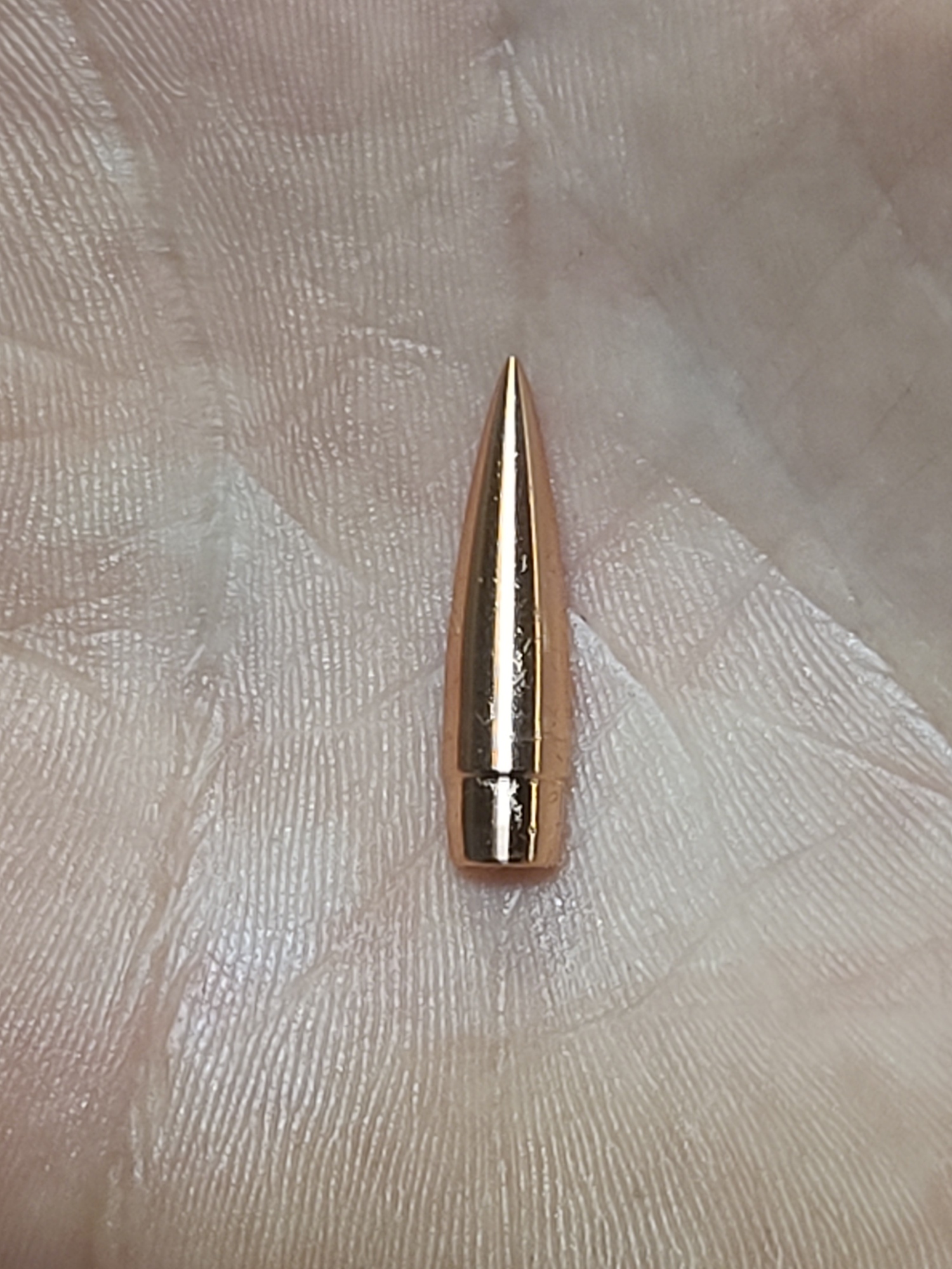

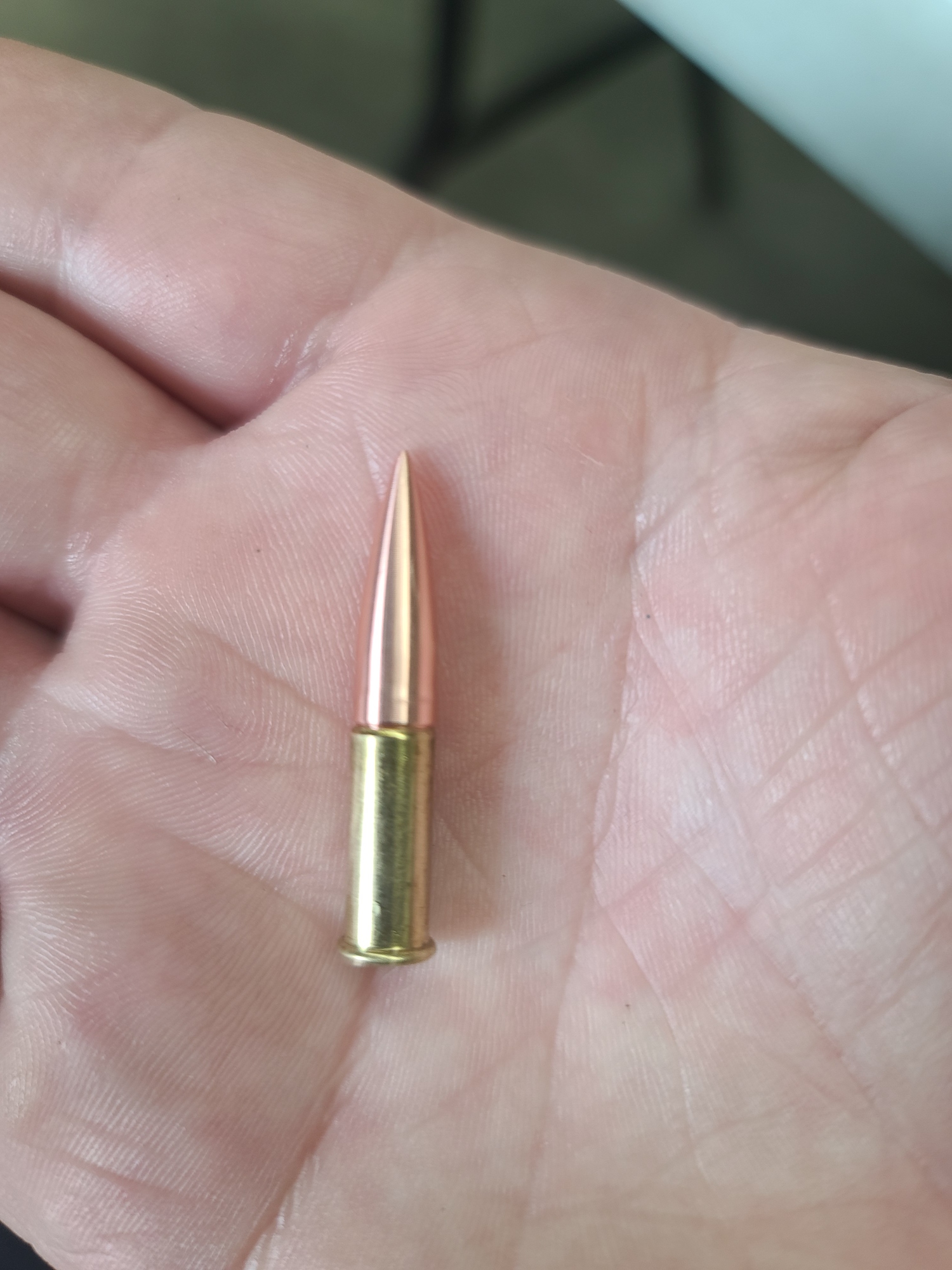

    Going to start loading 22lr. Got a buddy at Badlands precision to make the bullet. Think I’ll start with something in the Red Dot 🔴 burn range

    Ok here goes.
    1)New primed brass? Not pulled bullets from loaded ammo? Did not know this was available.
    2)What twist to stabilize?
    3)What velocity do you expect to achieve?
    Reactions: MCHOG
    What does that bullet weigh?
    Learning something new every day
    Ok here goes.
    My barrel is a 5.75 but they should be stable in anything faster than an 8
    Hoping for 14-1500fps but that’s yet to be determined. They’ll ship tomorrow so once I get them in hand, then real testing will start
    No, I should be under .65 per shot. Eley Tenex is .42 for reference. It’s not plinking ammo priced for sure
    Side track but you’re buying tenex at the slightly wrong place then (I suck at math and it wasn’t as different as I thought)
    Back to the regularly scheduled programming badassery
    Reactions: Geno C.
    I'm sure you have worked this out already, so I'm not second guessing you. But it seems like you you would hit the transonic range pretty quickly. I would have thought you would want to start out subsonic. What is the thought in the 1,400 - 1,500 fps?
    This bullet will transition without problems. That being the case, there is no need to start subsonic. The plan it to push them as hard as the brass will take it and find a stable node like normal

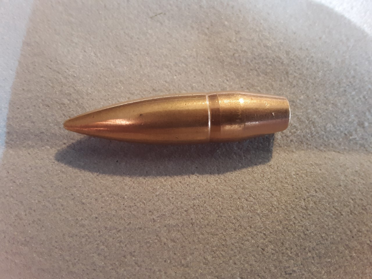

    Your custom bullet looks a bit like the one in the attached pic. This one came out of a .303 Brit loaded in 1950.
    Your project is really interesting. Hope you will keep us posted on the progress!
    That’s a cool looking projectile! What’s the diameter of the portion behind the recessed part and in front of it?
