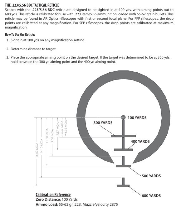

It's entirely possible that I'm just an idiot so feel free to say so if that's the case.
This is a Bushnell AR Optic 1-6 LPVO.

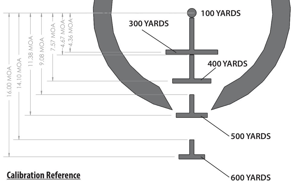

The manual tells me this:
MOA all over there:

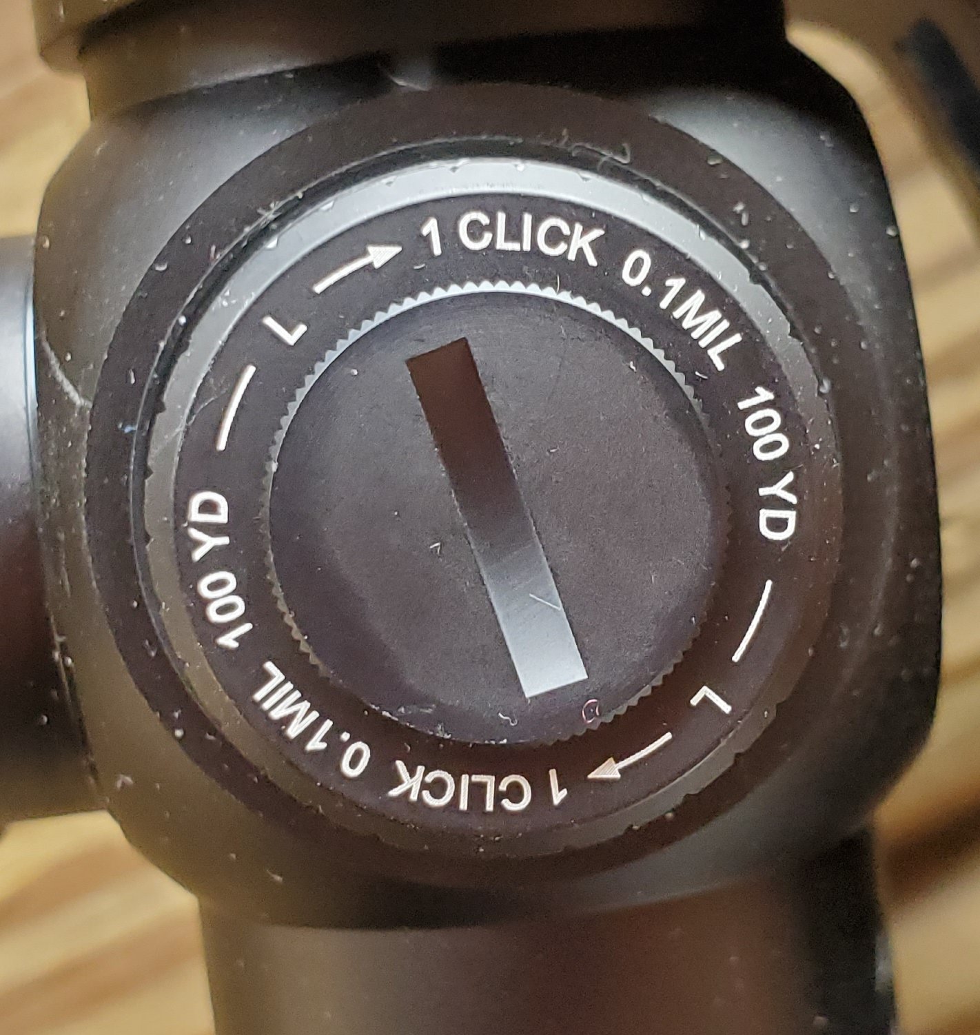

And yet the turrets are in MILS:
It's bad enough that I just CANNOT seem to grasp how to use the mil system because of some inexplicable mental block, but then there seems to be conflicting information on top of it. I have read numerous articles, numerous forum conversations and watched some videos and it just gets worse. It's like I'm dealing with a foreign language.
Forgive my terseness please, but it's late and I've spent hours on this and am quite frustrated.
Any insight would make you my new hero.

First things first. Mils and MOA are different routes to the same answer. Do not think in inches or centimeters. Those don't matter. If you missed low by .3 mil you missed low by .3 mil. Period. If you missed by .25 moa low then that's it period.
With this particular optic, I'd just use the gross adjustment of .1 mil is about 1/3 of an inch. But after that don't try to convert anything when using that reticle.
That BDC reticle is for certain yardage. Just like the diagram provided your load matches what they calibrated the reticle for. If you're shooting something different those lines will not match the yardage calibrated in the book.

OK, I'm going to limit this discussion to your particular scope and reticle so as not to add a bunch of extra info that, while you should eventually understand, isn't helpful exactly right now.
Minutes of angle (more correctly minutes of arc) and milliradians (1/1000 of a radian) are both angular units of measurement. Like there is for all other units of measurement (linear/pressure/whatever) there are already conversion factors that have been figured out.
In this case, 1 milliradian equals 3.6 inches per 100 yards.
Why am I ignoring MOA? Because we're going to zero with a target that has a grid laid out in fractions of an inch. But you say wait 1 MOA = 1 in at 100 yards. Nope....1 moa covers a distance of 1.047 inches at 100 yards.
That .047" is why 1 milliradian = 3.6" per hundred yards but equals 3.43 moa
So now let's zero the scope.
1) Get your shit all setup at the range however you like
2) Post a target that has a 1/4" grid all over it 100 yards away
3) Shoot the rifle
4) Look through some powerful enough spotting scope (or walk 100 yards) and use the grid to figure out the horizontal and vertical distance that separated the point of impact from the point of aim. Write that shit down.
5) Take those two measurements in inches and divide each one by 3.6. Whatever the answers are, round to the nearest 0.1. Example: you're 2.25" low at 100 yards. 2.25/3.6 = .625 mils (short for milliradians). Since your turrets adjust in increments of 0.1 milliradians, your answer is adjust up by 0.6 milliradians. Same shit for windage
6) Wash, rinse, repeat until bullets hit where you aim at 100 yards.
7) Use the drop lines on the reticle for the appropriate distance when shooting farther than 100 yards
8) Impacts will be close enough because that reticle is not a precision rifle reticle. Think of it as a good enough to hit minute of deer (or man), kinda like an infantryman uses a rifle.
Or you can bypass all the math bullshit and use a milliradian grid target. Each square in them is .1 mil wide by .1 mil tall.
Count the squares, that's how many milliradians you need to move the reticle. If you're four squares right and two low, you need to adjust the scope .4 mils left and .2 mils up.

This is a second focal plane scope, Tiribulus, which means that the reticle does not change size as you adjust the magnification. So those MOA indications in the manual only work for one magnification setting.
Also, there is no parallax adjustment. It is set at the factory at 100 yards, so further distances may be blurry or may, if you move your head around, the target may move across the reticle.
Bushnell says 55 to 62 grain bullets, so experiment and see which one works for these reticles to be accurate, and, if not dead on, figure out at what distances they are dead on and then use that, instead. E.g., if the first holdover (300 reticle) with 62 grain bullets is actually dead on at 275 yards, then just make a note of that and realize that is where the reticle is accurate - if you want hits at 275 yards, there is where you aim. It is actually a holdover for 275 yards instead of 300. If you want to holdover for 300 yards, then you are going to need to place the first reticle a little bit higher. With practice you will figure out how much higher for the holdover.

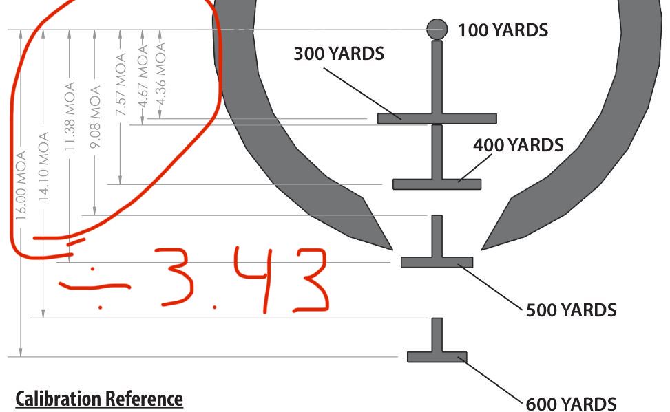

@Tribulus
I am repeating what some of the others are saying, just showing here how I do the math.
Can you comprehend converting centimeters to inches? Mils to MOA is no different, except that one is linear units and the other is angular- similar to degrees.
I repeat, both Mil and MOA are measuring angle, not inches or centimeters, but it translates to linear differences on paper or steel, etc.
Think about it. When you dial a scope up or down, you are basically changing the angle of the barrel so that it will hit higher or lower on the target. The same thing happens when you use the BDC reticle.
Holding on the 400 yard hash in the reticle=
7.57 MOA or converting to Mils= 7.57/3.4 which equals 2.2 Mils. If you wanted to dial that instead, you would take 2.2 Mils and divide that by .1, result is 22 clicks.
If you are zeroing on paper at 100 yards, and your impacts are 6.5 inches vertical from the point of aim- Take 6.5, divide by .34 to convert to .1 Mil clicks, result is 19 clicks.
Hope that helps.

To be clear, the reticle above is neither mils nor MOA. It is just a bullet drop reticle with holdover hashes for certain distances. The manual, however, stated an angular measurement for the holdover reticles, and it stated the angle in MOA.
Mk4 series is the SAME animal. The reticle says nothing of angular measurements, however the manual states otherwise. The Mk4 manual is also regurgitated verbatim in the GTA 07-10-004, Sniper Quick Reference referenced from FM 3-22.10.
The measurements are GIVEN for you, not represented on the reticle. It is up to the end user to figure them out and use accordingly. Both scope boxes give you the same amount of info.

P.S. It's not like it is a bad idea in theory, especially compared to just crosshairs, when extending your range out to 300 meters and beyond.
Not to slight anyone who took the time to respond here, but it's not possible to address everybody specifically.
A couple points.
My main concern for the moment is getting this rifle shooting straight as some have said. I just want to get it zeroed. For now. I have every intention of learning the technical aspects of why when I can. I love that kinda stuff as anyone who knows me will tell you. I'm just as untested in the why as well as the how.
I'm still not entirely clear on how this sighting system works, but I'm getting closer.
Another problem and a big one is that I don't have a really stable rest. I might be able to rig up a SANDBAG outfit. Or get somebody with a good sled to let me borrow it for a little while. The gun has a Magpul bipod (I know not the greatest), but I don't have a good rear bag, Which I've been meaning to get for a while, but there's only so much money.
This is a big deal because no matter how hard I try, I have a tough time keeping the rifle perfectly still while firing it so I don't have 100% confidence that what I'm seeing on the target represents only the optic. Or the gun for that matter.
Complicating things even further, I will be 60 in a few months and my eyesight isn't what it used to be.
It still seems to be hitting a LITTLE high and left on paper. I ran out of time and will tackle that next time out and hopefully by that time I'll have a firmer grasp on the technical details of this system. This time I more or less played with it until I got it close.
EDIT: Oh yeah. Yes this is a 223/556 AR which is what this LPVO is designed for.

So are you aiming using a holdover somewhere between the 100 yards and 300 yards on the reticle shown in the original post? I assume closer to the 100 yard aiming point than the 300, since a .223 or 5.56 bullet only drops about three-four inches at 200 yards, compared to about a foot at 300 . . .
Let us know how you are using the reticle.
Yes. Exactly this. It's close, but the last time I shot paper at 100 (using the dot on the top of the reticle) It was about an inch, but a little high and left. I want to get it more stable than I am before bothering to zero it precisely.

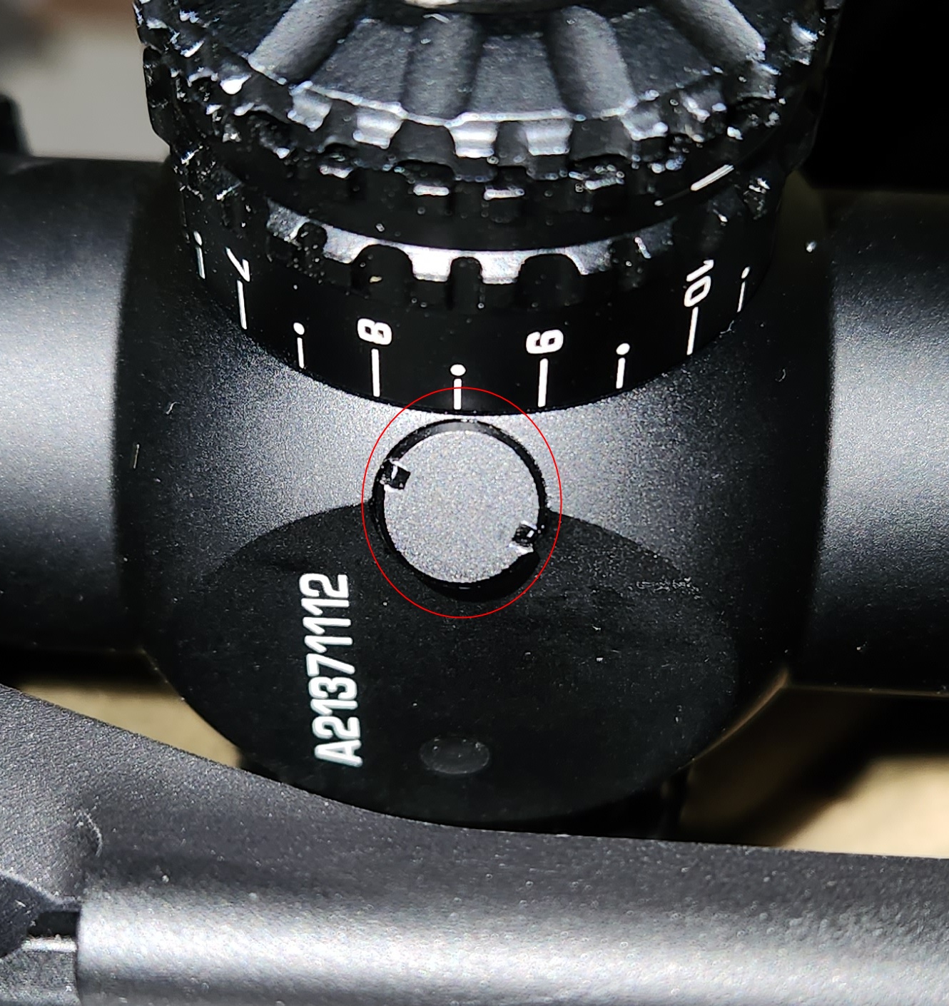

Ok, now you guys can beat me up. I finally got the parts with the holiday sales for another build. A budget build.
I also needed another optic so I got a Swampfox (covers head) Arrowhead 1-8, put it on my Aero build and put the Bushnell on the new one. Hopefully tomorrow I'll get them both sighted in.
All that aside for a second, I haven't been able to find a definitive answer to this question:
What is this on the bottom of these LPVOs?
My guess is that it has something to do with sealing up the internal environment of the piece, but I have certainly guessed wrong before.
Thanks.
Regardless, it's nothing that the end user can adjust or should mess with in any way. Why not worry about something that will actually benefit you?
