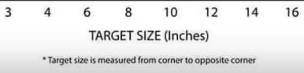

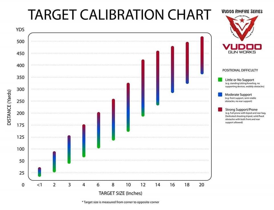

What size steel are you guys using from 3-500 yards? By the chart below, at 400,you'd be shooting a 8.75" square, tough target here in WY.
Dunno where in that chart you see 8.75" @ 400y....
Chart says 12", bottom of the chart says measured corner to opposite corner, I took that as diagonal, which would equal about 8.75" square, lol
Thanks for the insight, 16" at 400 was my mindset
Apparently some of you have forgotten your basic junior high math skills, aka the Pythagorean Theorem, a2 + b2 = c2. A square target, diagonally measured to be 12" (aka, the "hypotenuse" or "c"), would mean all sides of the square (aka, the "legs", "a" or "b") would be 8.5".

Looks like the 12" diagonal would be the smallest thing you'd see, 18" diagonal the average if look where the yard lines hit the middle of the size bars if am reading the intent of that chart correctly.

Two things. The first is minor, well both are minor. First is that the graph axis should be reversed. Distance on the x and target size on the y.
Second, I think target size is important, but what I really have come to think is more important is what you learn from misses. I like tight targets, but if there is a miss, can you see where it went. a close berm to see splash, or a cardboard backer, or a center hole on a plate to see splash on the face panel.
22lr is about learning. Every shot should give feedback. Nothing worse than a “No call” on a shot. Tight feedback loops.
Also, why does the target size increase, and then decrease as range increases.

No. He is correct.
All you have to do is use some reading comprehension skills and read the descriptor below the horizontal axis, then do some real basic Geometry.

How about two lines on the X axis, one showing the diagonal and below that the corresponding square size. Kind of like F and C for a temp axis labels. Could also add cm as units for both Canadians with guns still.
Wrong. In geometric terms, there is "adjacent" and "opposite". Both have very specific definitions. Your owe an apology to your geometry teacher.
brb putting a 1/2" wide by 12" tall at 425y and 1/2" wide x 20" tall target at 500yfor you cause well it meets the standard of that chart apparently
I highly doubt they are talking about the hypotenuse when discussing target size. Yeah, let me cant my scope 45° so I can mil this target width real quick lol

I did not mean to start shitshow with the graph, more interested in the size steel people shoot.

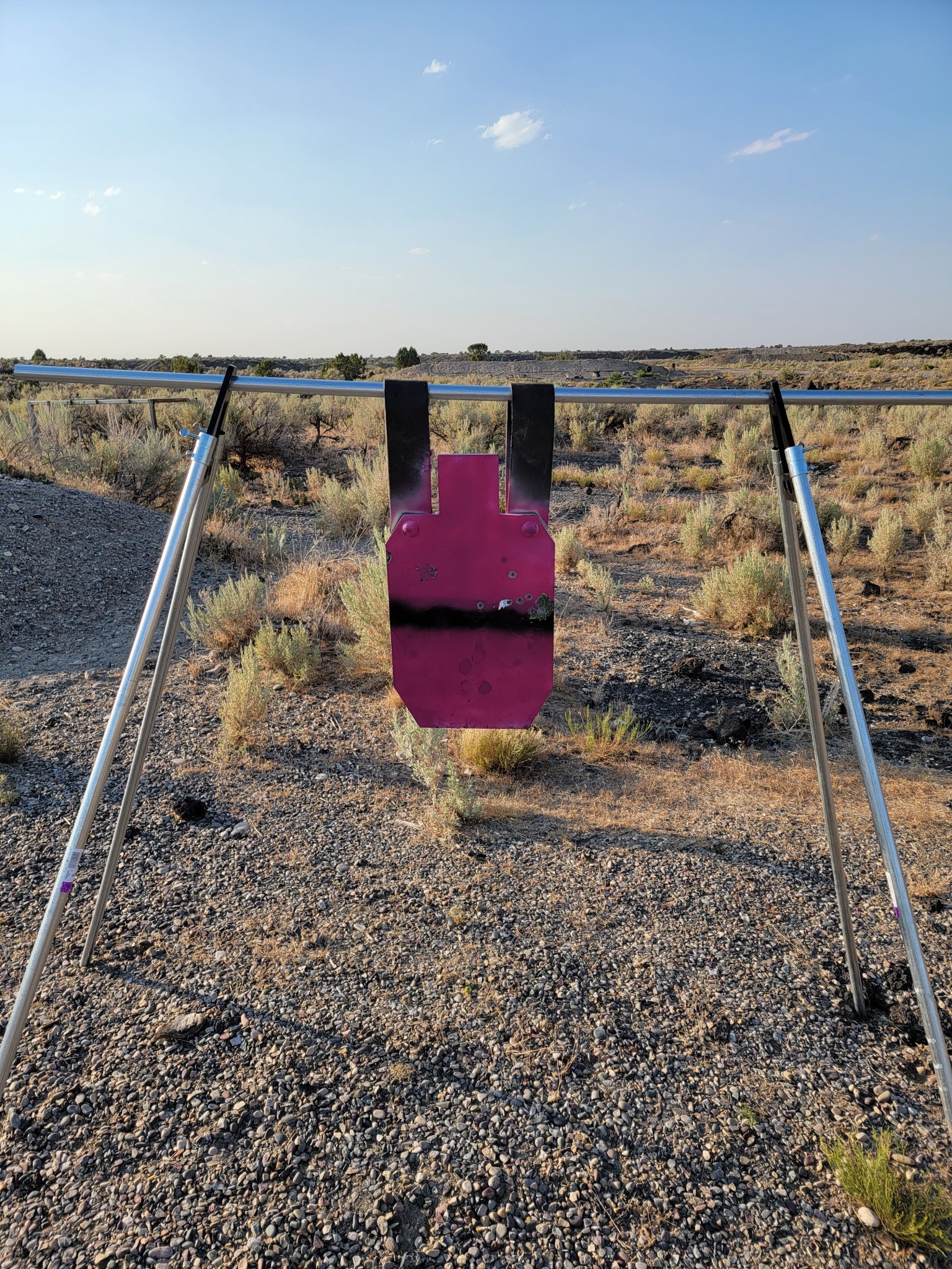

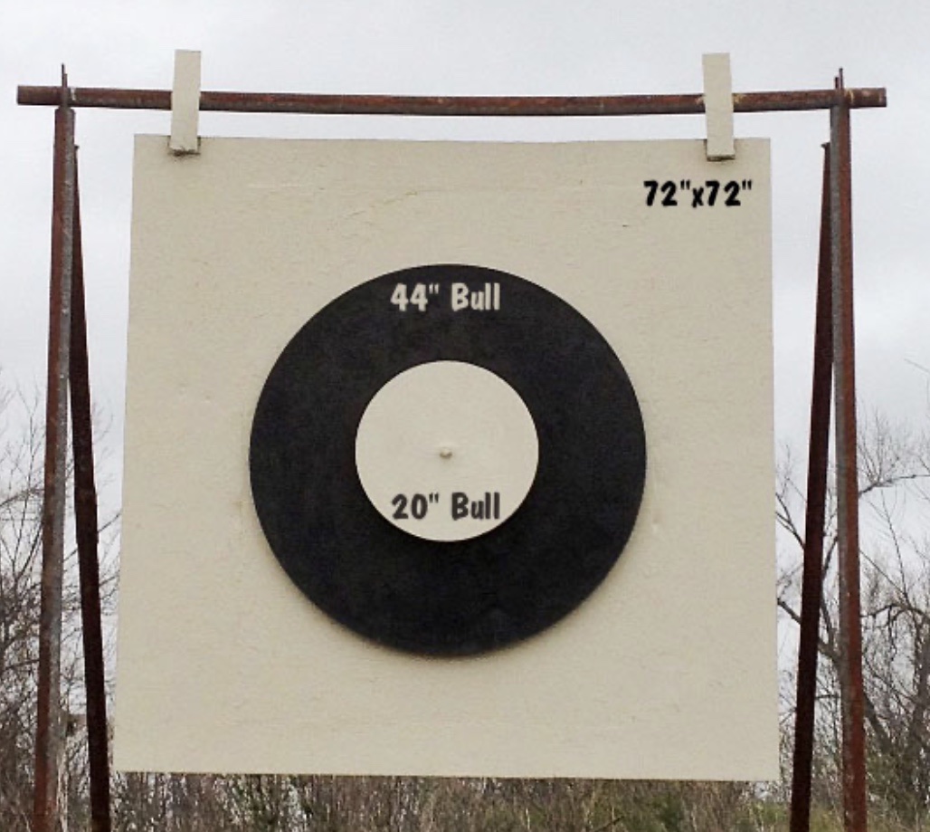

I have 5 plates now that range from 6" to this torso. I like the torso because it can gather better data. Also for what ever reason it rings very well when hit.

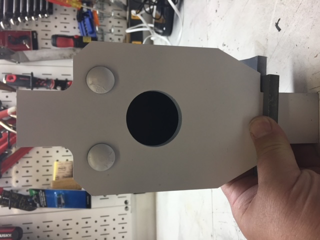

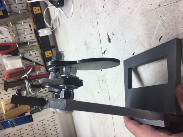

This is what I mean on feedback. If 22lr is quarter scale 308, I had these cut to 1/4 scale IPSC- but with a center hole with a flapper. Center is the real target, the face gives feedback. 1/4 scale gets smaller than you think. It isn't 1/4 of the surface area, its 1/4 on the hroizontal and vertical 1/4 times a 1/4 =1/16 surface area. Still pretty big. I really meant them for out to 200, but I think 300 would work, though. After that, misses off of the face would happen a lot.
These were fun, but I need to get back at them to get them to do what I want.

Those are awesome. I will do some R&D testing on them for you. 😉

Center would be a tough target at 300 yards Looks sweet.

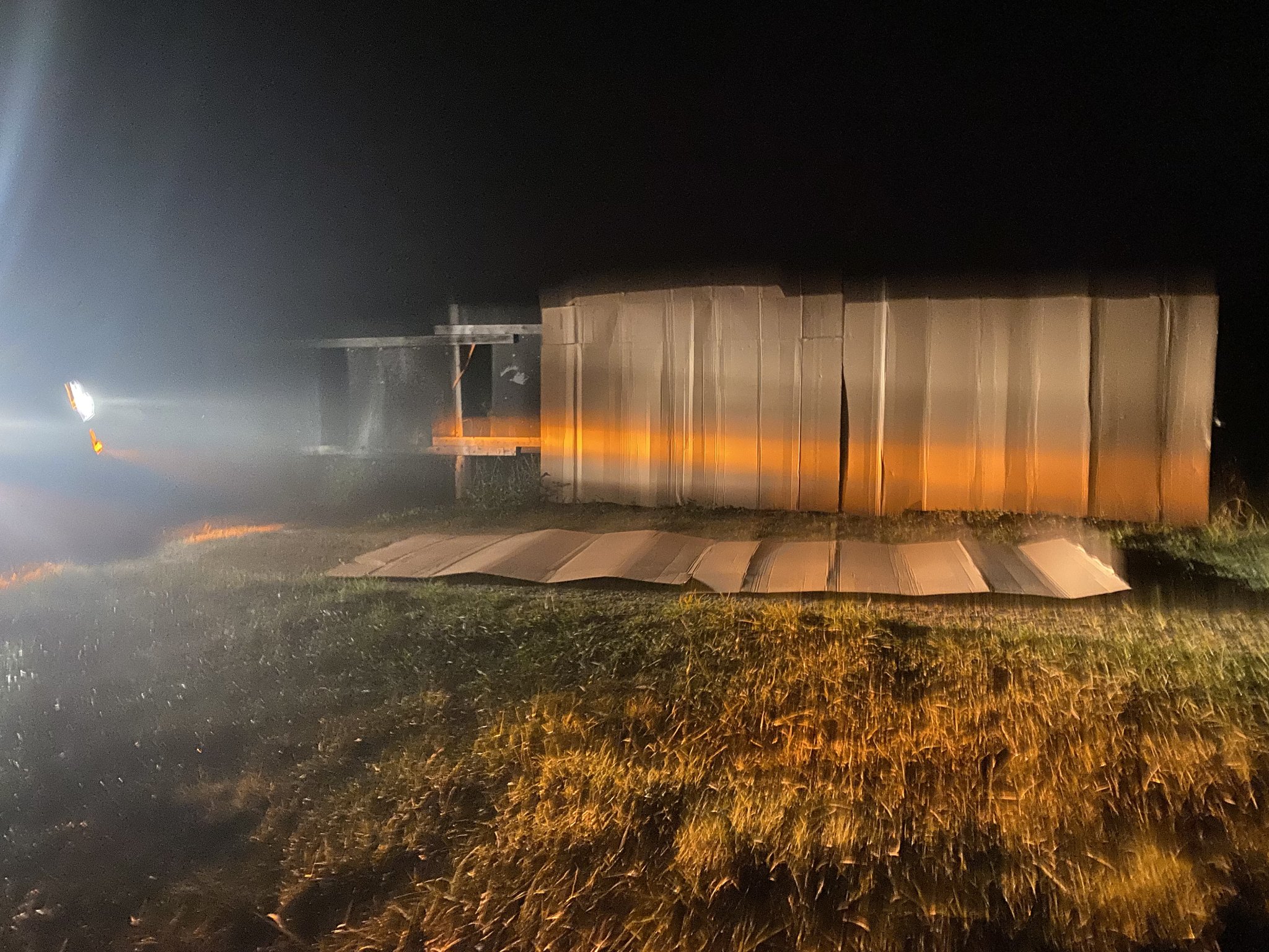

OK OK with Match Ammo. I’ve shot 15 6x5 targets with different match Ammo and they have all been accounted for. The best can be seen at Jbell’s 6x5 thread.
I live next to two mattress stores. I got it made. It is nice to see where every bullet is going. Shooting steel without first getting your dope on paper is annoying. With minimal wind I almost never miss a 6” plate @300.View attachment 7732439

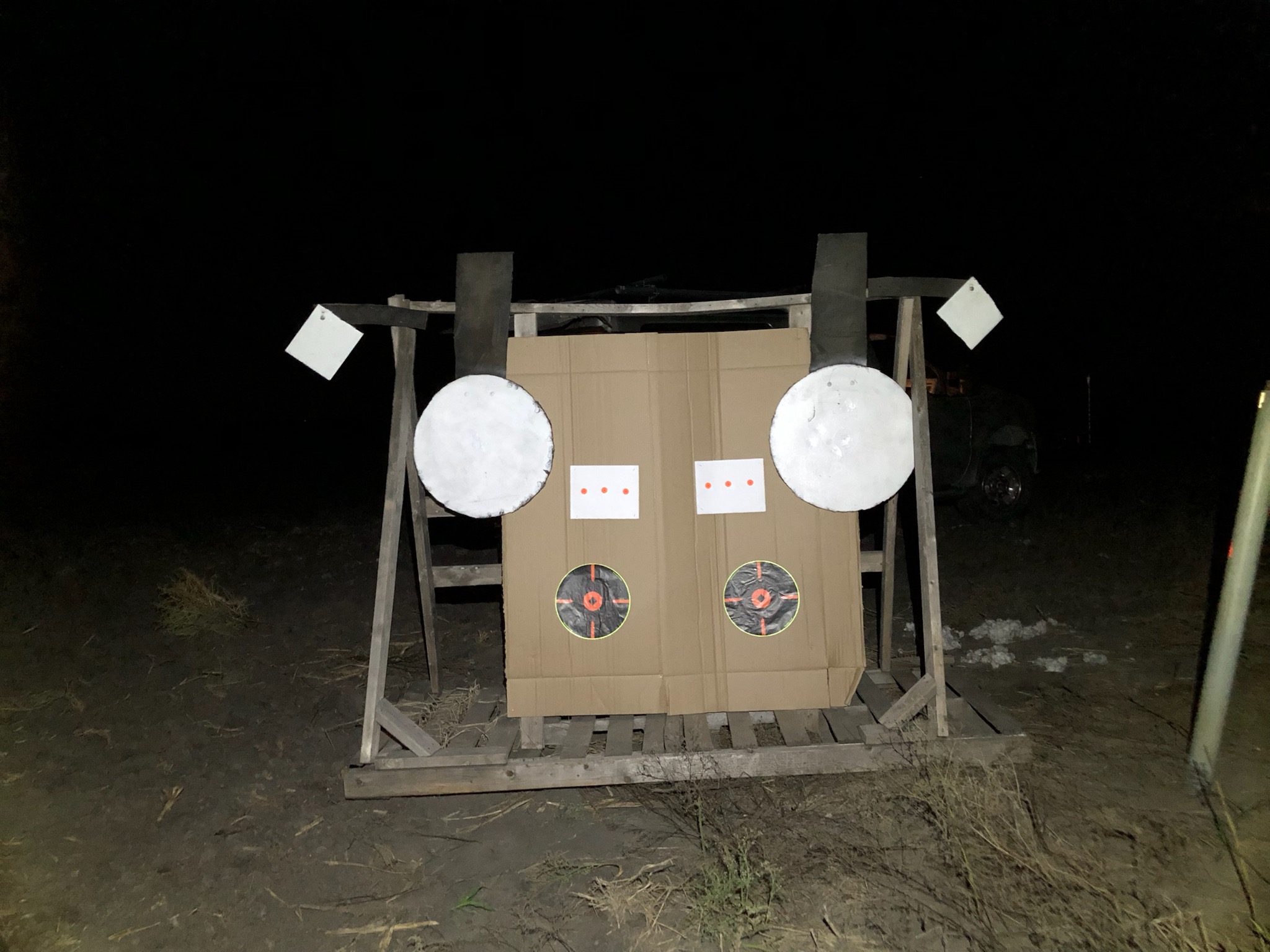

Shooting giant cardboard targets in the dark?!
There is a possibility we are related...

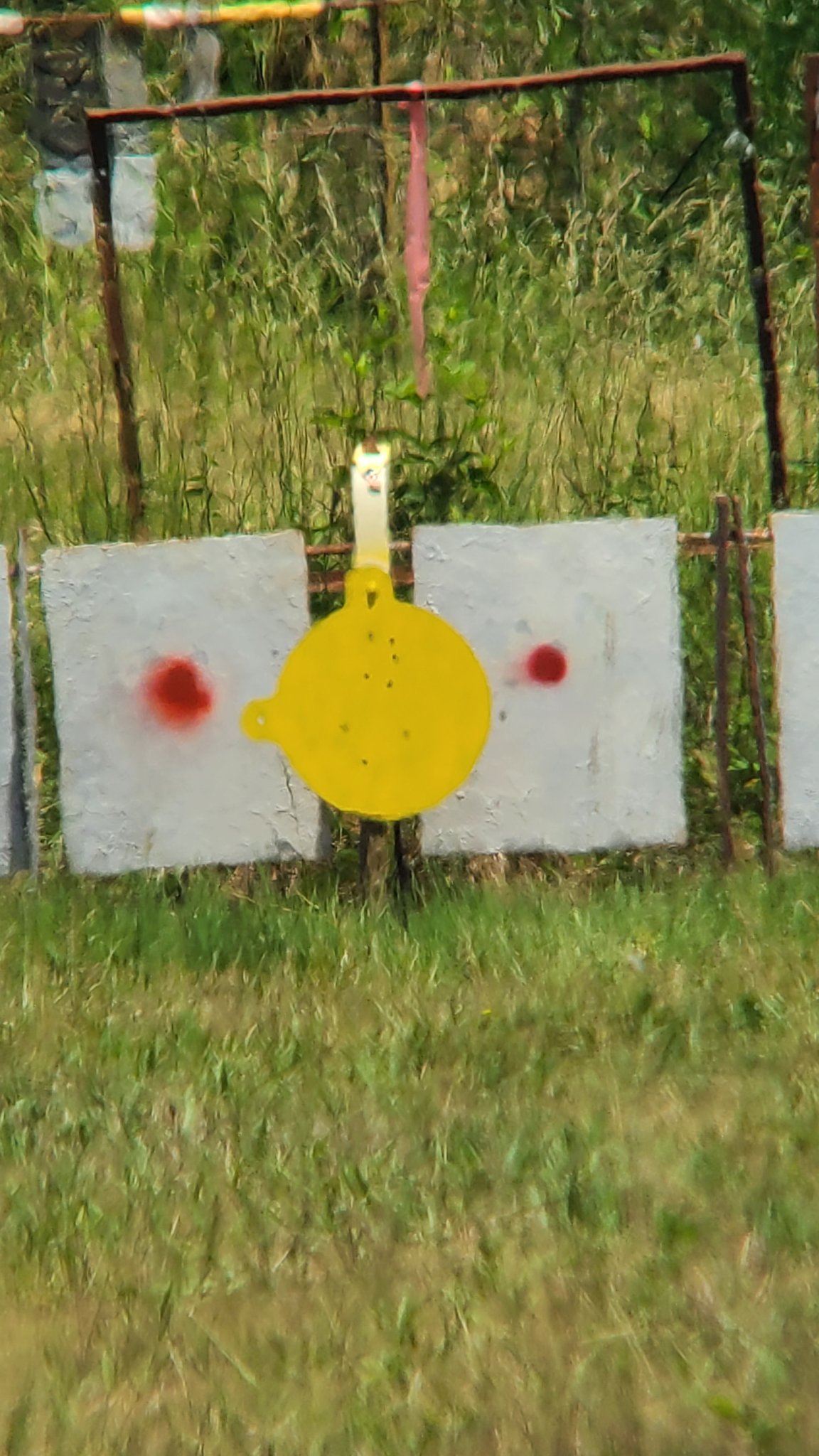

The "long range " stage in my match is this at 400yds. During the match the square steel, which is permanent to the range, will be all white. The gong is 16" and only 3/16 thick, rings like crazy. There are some gaps and you still have to have some idea of your dope but the adjacent steel gives good feedback.
