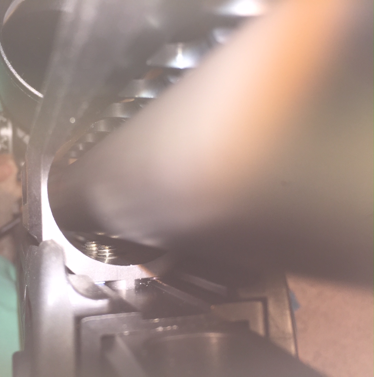

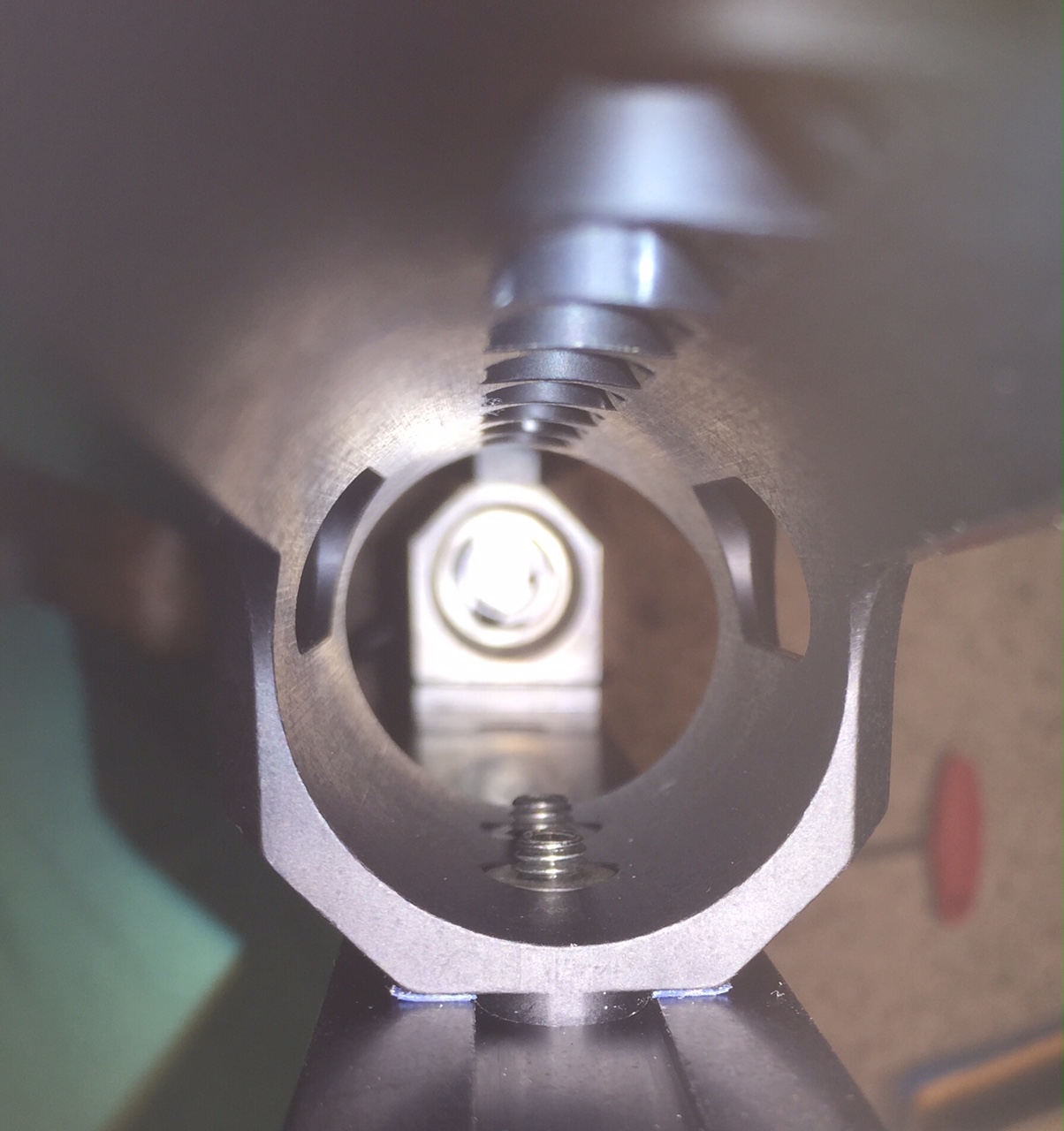

After half a decade - I finally decided to install the night vision bridge I bought with the rifle then.
The screws are too tall! :(
They tend to make barrel reinstallation an annoying process.
Anybody else run into this issue?
Can’t tell you the exact length at the moment - but they’re around half a centimeter or so taller than my other rifle’s night vision bridge (no protrusions on that one).

What's the OAL of the screws?
The correct length is 18mm, which I just got from AINA today.
The older ones were 21mm.
Not sure of the pitch, I don’t have one of those pitch gauges.
