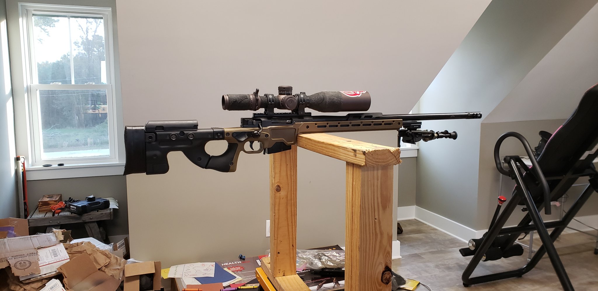

Thumb hole, you say? Accuracy Obsession you say? Bam!

Here's how an unbonded AI shoots in an MPA chassis
Nice. I’ve followed you and the couple other guys with AT-MPA over the past year(s?). It definitely works as-is, and I agree with you that if you’re used to and prefer an MPA, then that’s the best option. I have made it no secret that my design was intended to be a direct swap for the action, with a bonded interface, and (love it or hate it) the same AI ergos from the trigger back.
There is still some debate on my end on whether or not an un-bonded interface would work, or be better. There’s obviously proof in your results that it can and does work. But I decided early on to replicate the chassis/action interface of the factory rifle, rather than try to determine the best design for an un-bonded recoil lug. I know the ASR is un-bonded, and I assume the next-gen short action AXSR or ATSR(?) will be as well. But those were designed from the ground up to be that way, and have 5 action screws and a totally different interface.
