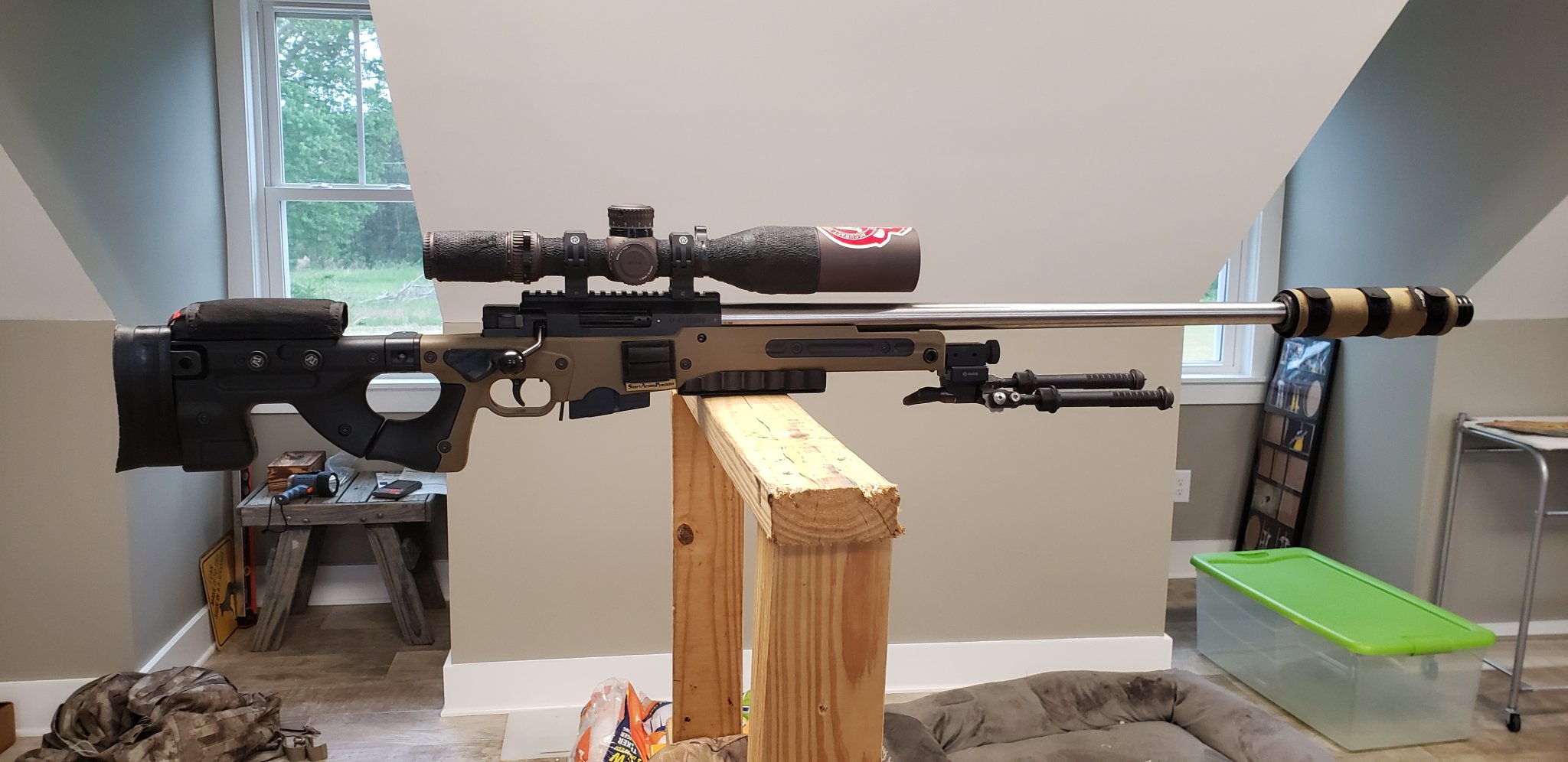

    I have an AT. With my 26" MTU, razor gen2, empty mag, and atlas bipod I came in at 21ish pounds. I think it was close to 22lbs. I had a cold bore shift on my AT until I figured out it was the torque value on the quick change screw. Went up to 60lbs and the shift went away completely. I have an AT and a custom. I like both for shooting matches.

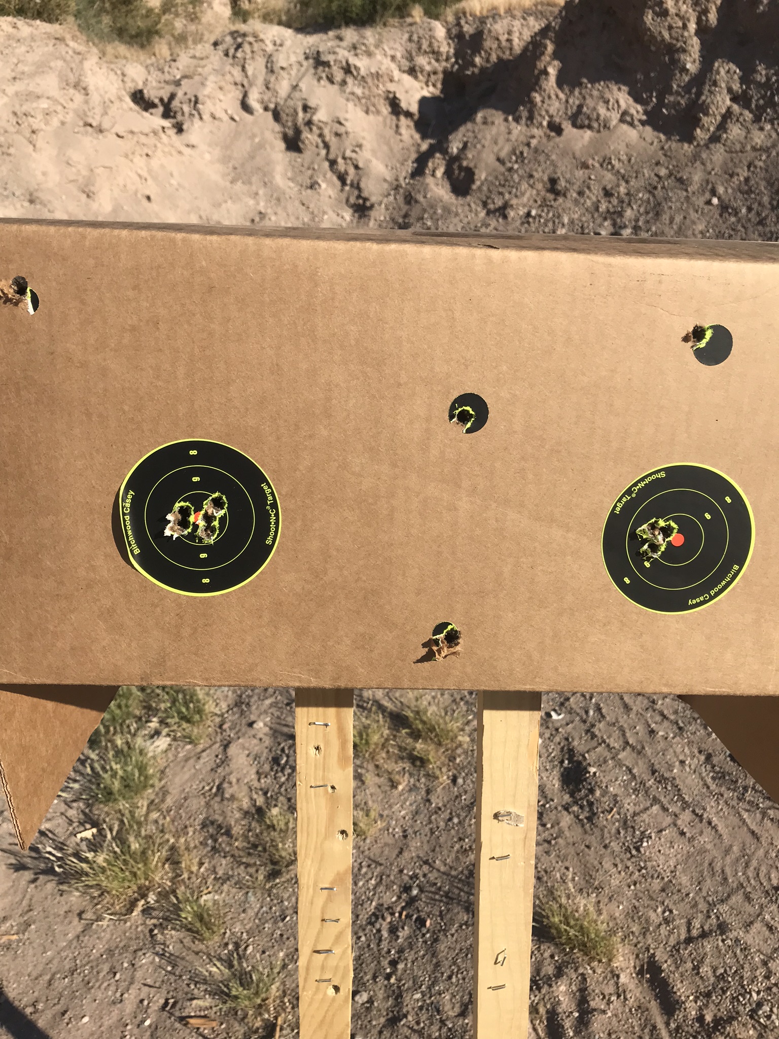

    There is no such thing as a wandering zero with an AI. I’m not the best shot but the pic below also talks to repeatability. I few 11-hours across the Atlantic with the barrel separated from the action. Torqued to 49lbs at the range and no adjustments were needed.

    Getting any AI either AT or AX to 20lbs is really easy, I run a ZCO, Spuhr AX in 223 with 26” marksman barrel...21lbs.

    .3 high
    tightened it to 60lbs and it went away completely.
    I have almost the same problem.... around 0.2mil high with the barrel torqued at 5.5Nm. Can I ask you how you had arrived at this value of 60lbs (6.78 Nm) wich work good and fix the problem?

    Trophyhunter ? "Getting any AI either AT or AX to 20lbs is really easy, I run a ZCO, Spuhr AX in 223 with 26” marksman barrel...21lbs. "
    What bolt or who did your bolt for 223?
    Any feeding issues?
    Thanks
    PS: I had already retorque the barrel at 60 lbs for testing
    Well. 49lbs wasnt working so I just tried 60 and it worked.
    Any feeding issues?
    One that I’ve been working on for a while, have a little over 1300rds on it now, running great.
