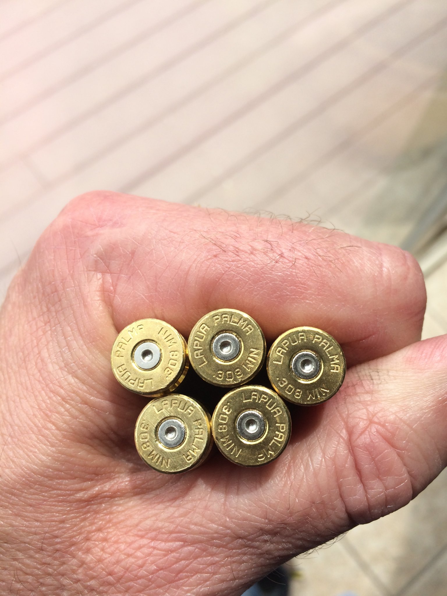

I tryed some Lapua Palma brass in my AW today to see if I might need to have my bolt bushed to shoot small rifle primers. I ran some Palma loads that push a 155 Sierra at about 2800 out of my 20inch AW. I don't see any cratering at all. Does this load produce enough pressure to give an indication as to if I will have problems with a 6.5x47 or creedmoor in this rifle? I'd like to shoot 6.5x47 but don't want to bush my bolt.

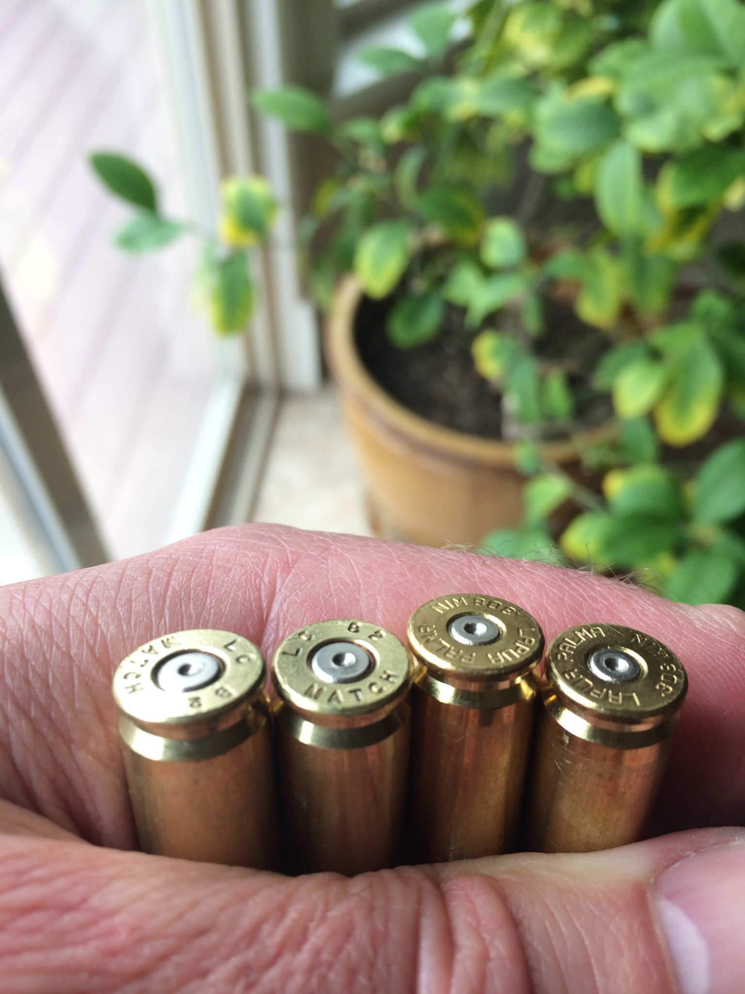

Hard to tell so far away from them and looking straight down on them but it does appear to be mildly cratering a bit. But if youre not blanking primers continue on.
I don't know if this is any better but here's a couple examples of a large rifle primers next to the small I shot today as well.
I don't think you have enough info to know if small primer 6x47 will crater or pierce in your AW. I have a 2008 AW like you that I bought a 6.5 CM barrel for and I have only shot large primer 6.5 CM loads that show mild cratering driving a 140 ELDM at 2750. The only way to know if Lapua small primer brass will be ok is to try out my loads in this rifle and see what happens.
The two on the left are large rifle 308, the two on the right are small. All the cases in the original pic are 308 small rifle primer. Not a very large sample I know.
