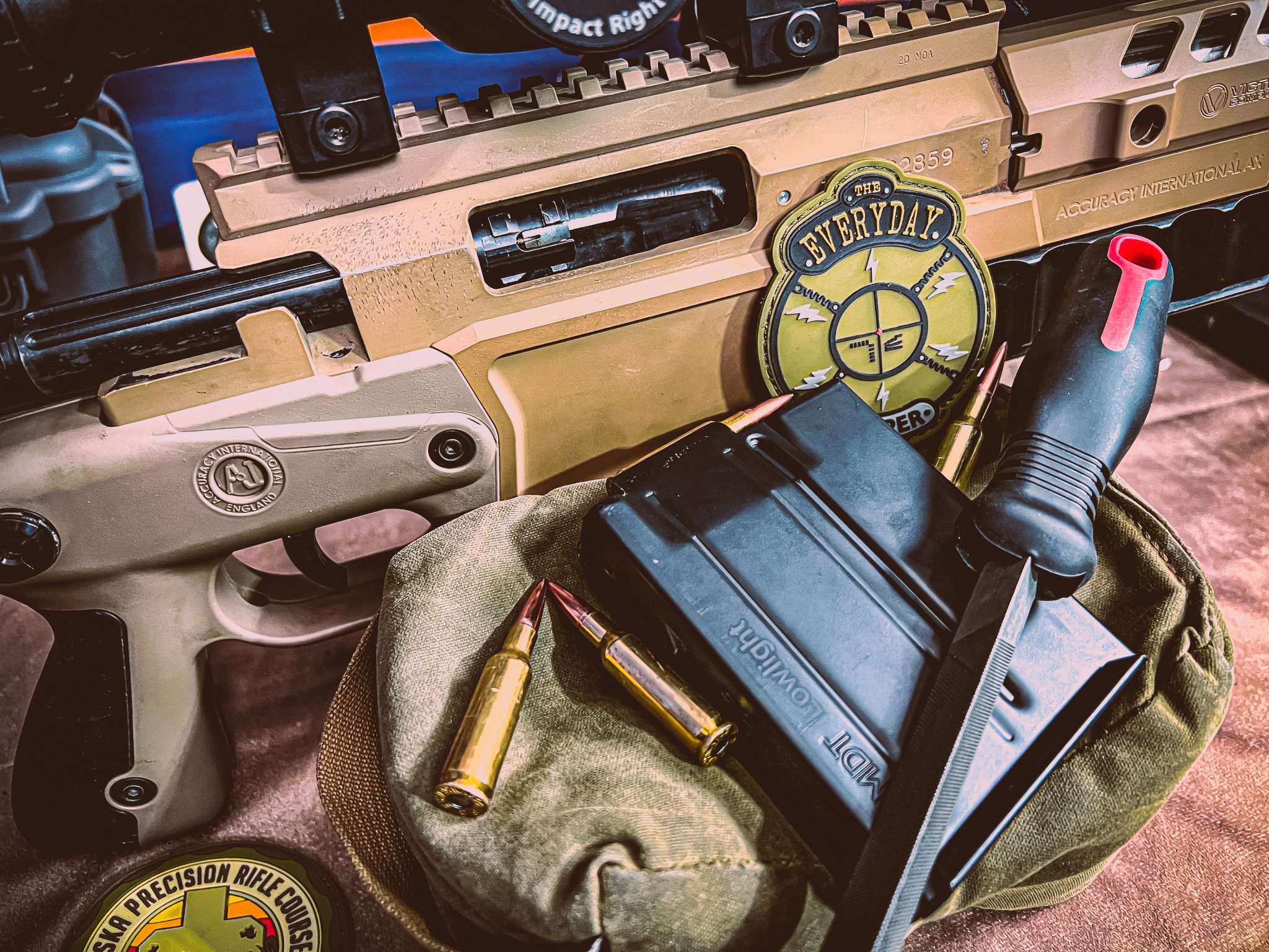

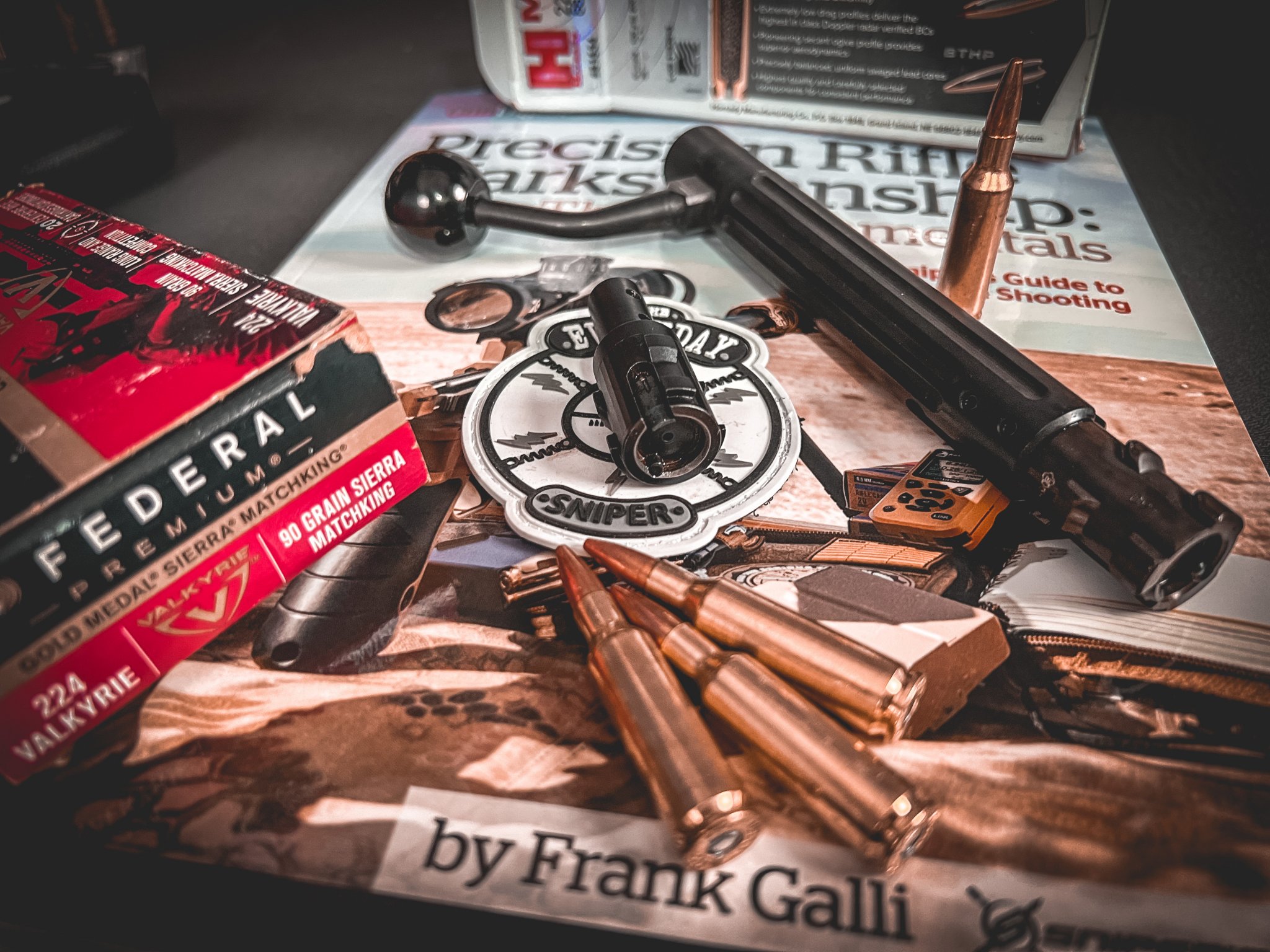

    As noted just a few short weeks ago, I took possession of a 6.8 Bolt Head for an AI Bolt. First job, source the bolt body and then swap the heads out ...
    That complete I grabbed a Proof Steel barrel from MHSA and Adam went to work spinning up everything to fit.
    Took some work, Adam is a craftsman, but Enrique did an awesome job

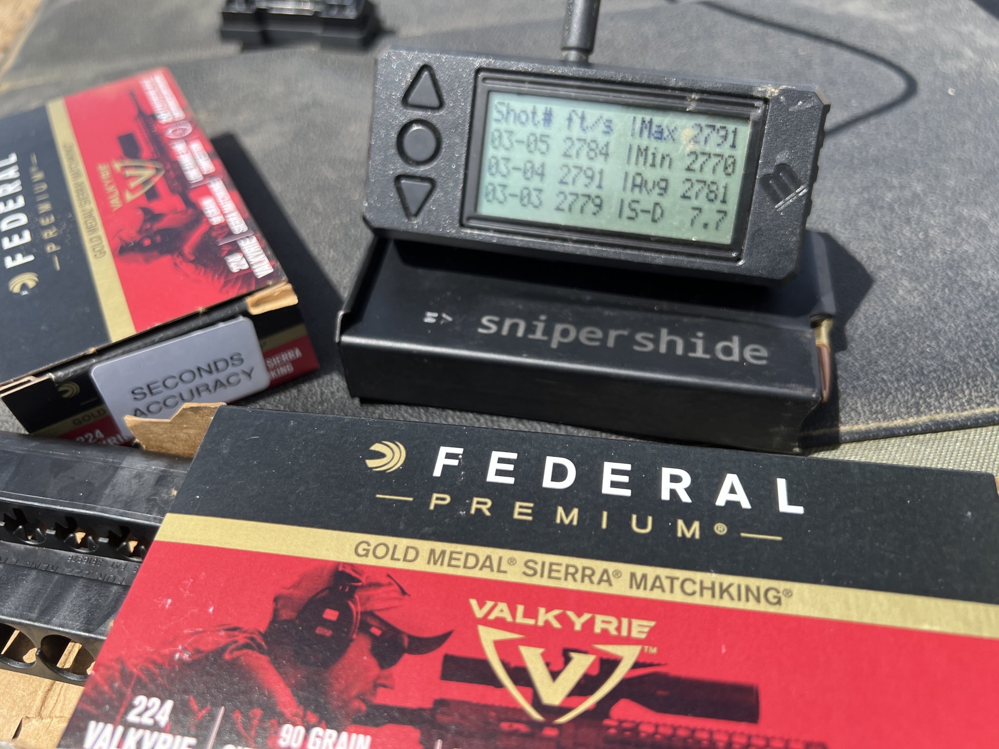

    As I was waiting I found a whole lot of 90gr Federal Ammo for 15 cents a round. 15C !!!! each, yes please I'll take 10... cases.
    The ammo was advertised as Seconds, with a huge warning disclaimer so nobody will buy it but us idiots.
    Now I still have some work to do on the AX, the magazine issue, I need to sort that out, more in a second, but first some numbers from my Shitty Federal Ammo that doesn't work in anyone's rifles and has to be sold at a loss.

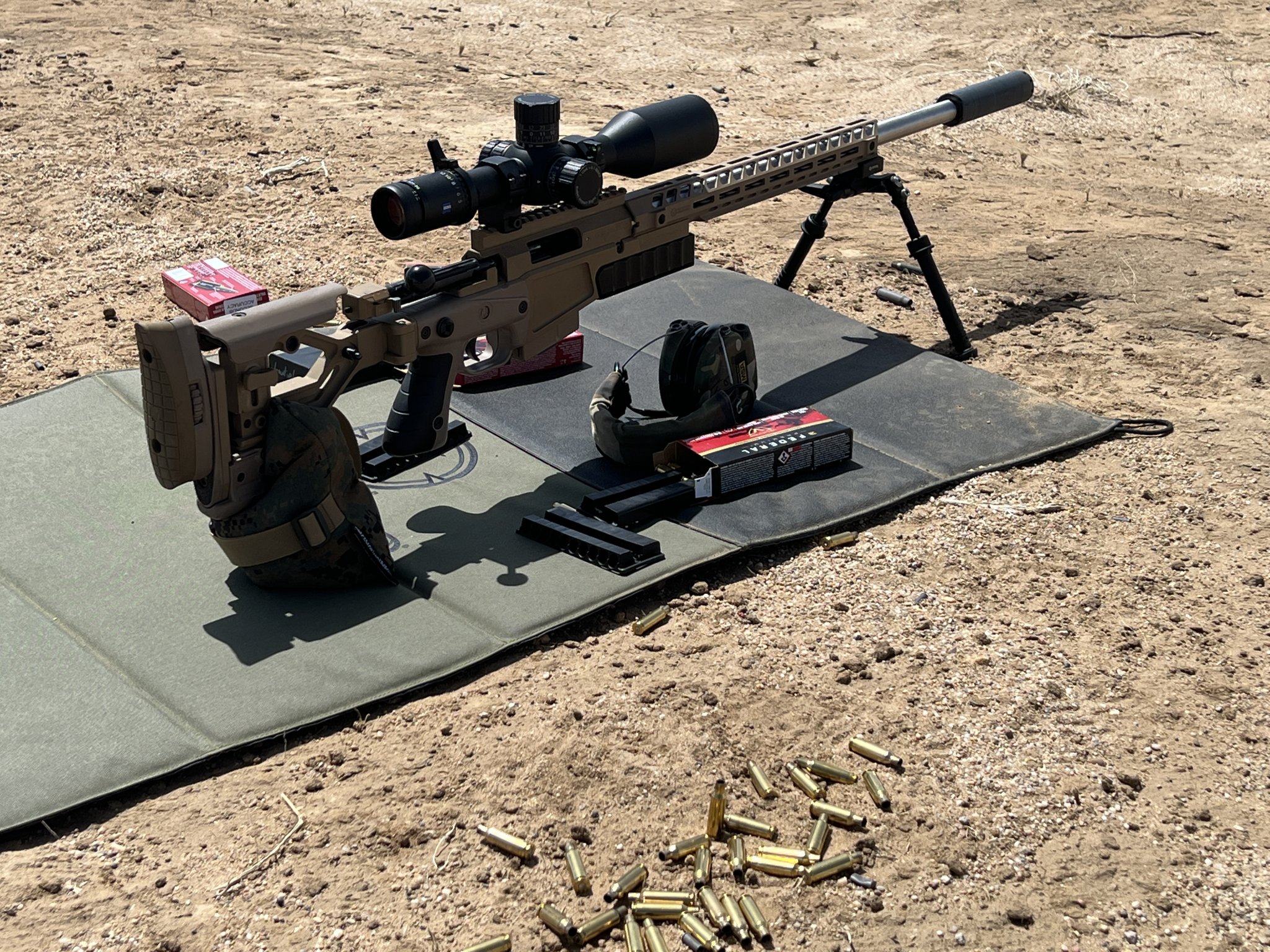

    I have a 224V bolt gun, built on a Bighorn Action, Bartlein LH Gain Twist barrel that is an absolute hammer. these are the numbers from that rifle
    I had a tiny hiccup running the AX Numbers, but I was also trying to get as many rounds through it initially as possible so it was a bit of me. However, this is the Bighorn Action results.
    Accuracy was decent, winds were bad all week, 8 to 12MPH and with a .22 it matters.
    This was my control rifle, the AX was new so using the Control Rifle I was able to gauge it.
    Now to the AX Accuracy
    About the same, not much different, I think I have 8 rounds here and wasn't just sinking them for zero.

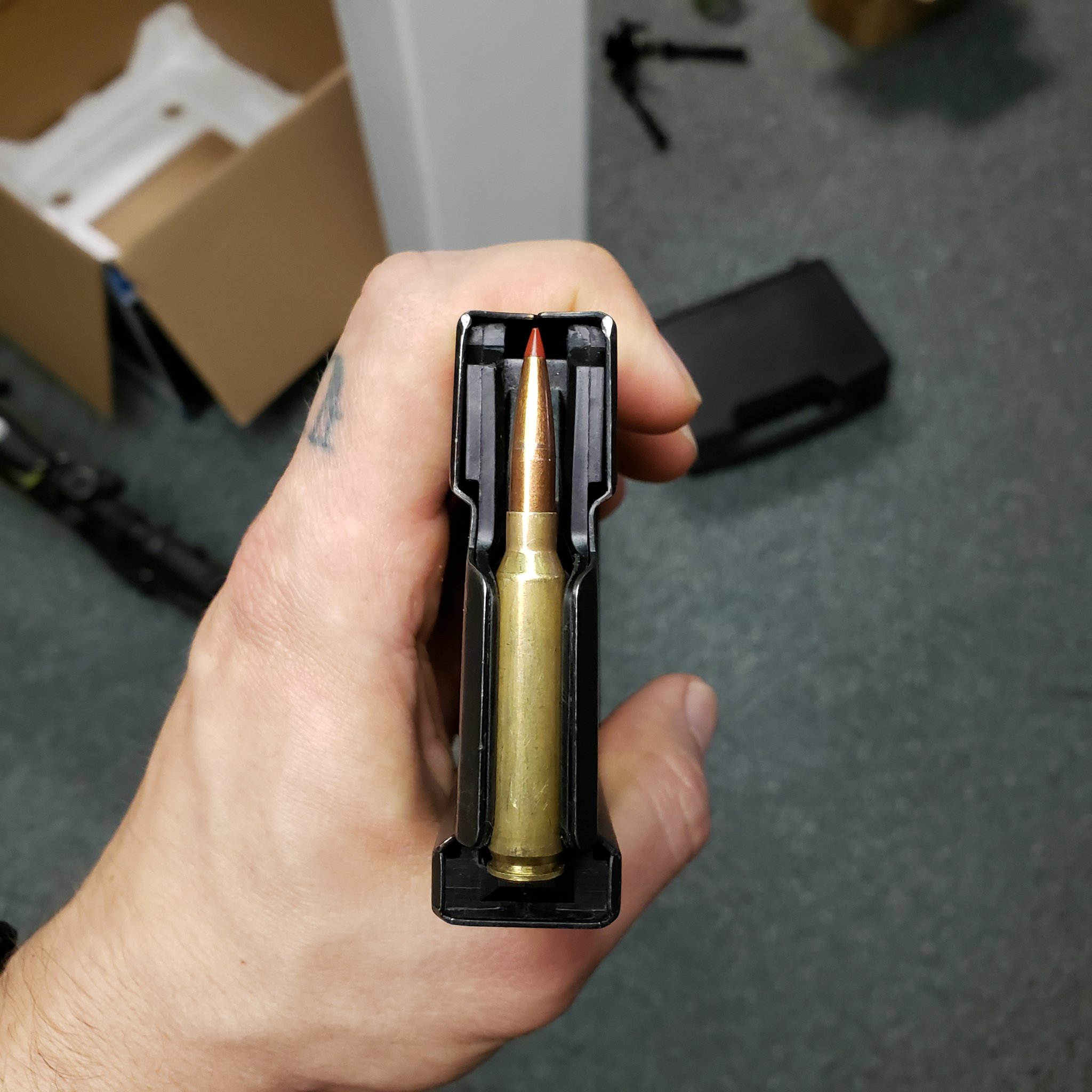

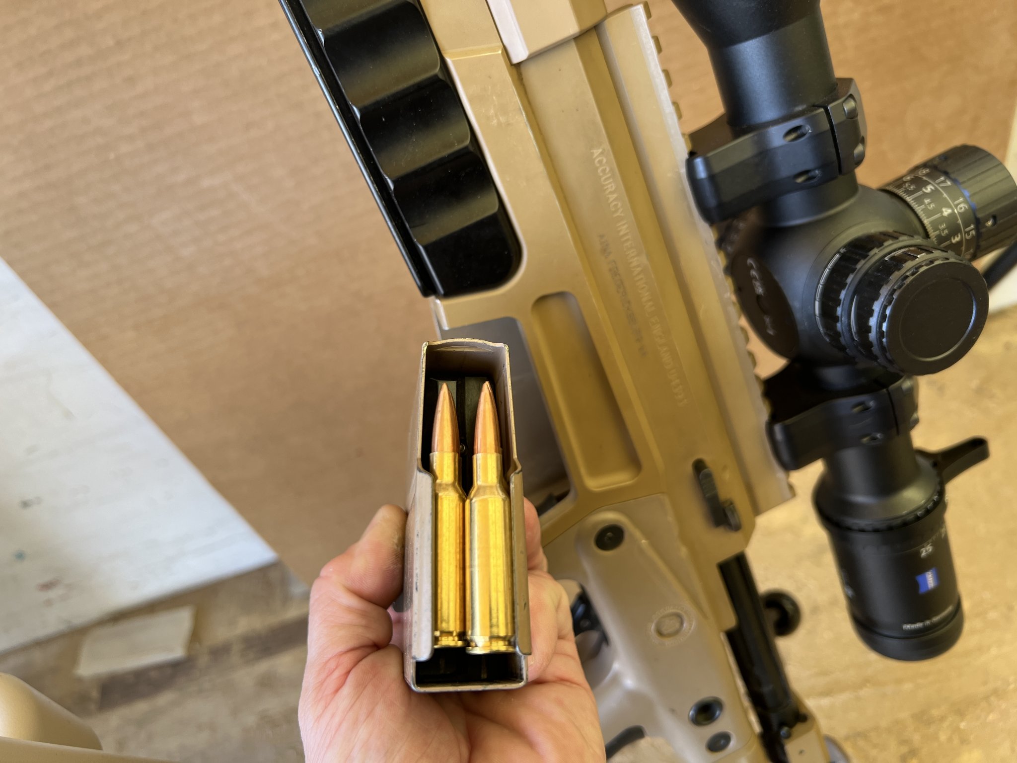

    It was shooting super smooth, I can drop around in the port, and it loads flawlessly. The issue is the magazine, I can get a few AICS Variants to seat but they need to be modified via a Dremel to move some material away from the 3rd Lug.
    You can load a mag, but once the left side releases the whole thing falls apart. A new follower is really all that is needed to hold stuff in place.
    But the single stack magazines from MDT work great and I can lock one in place. I just need to remove the bolt stop area.

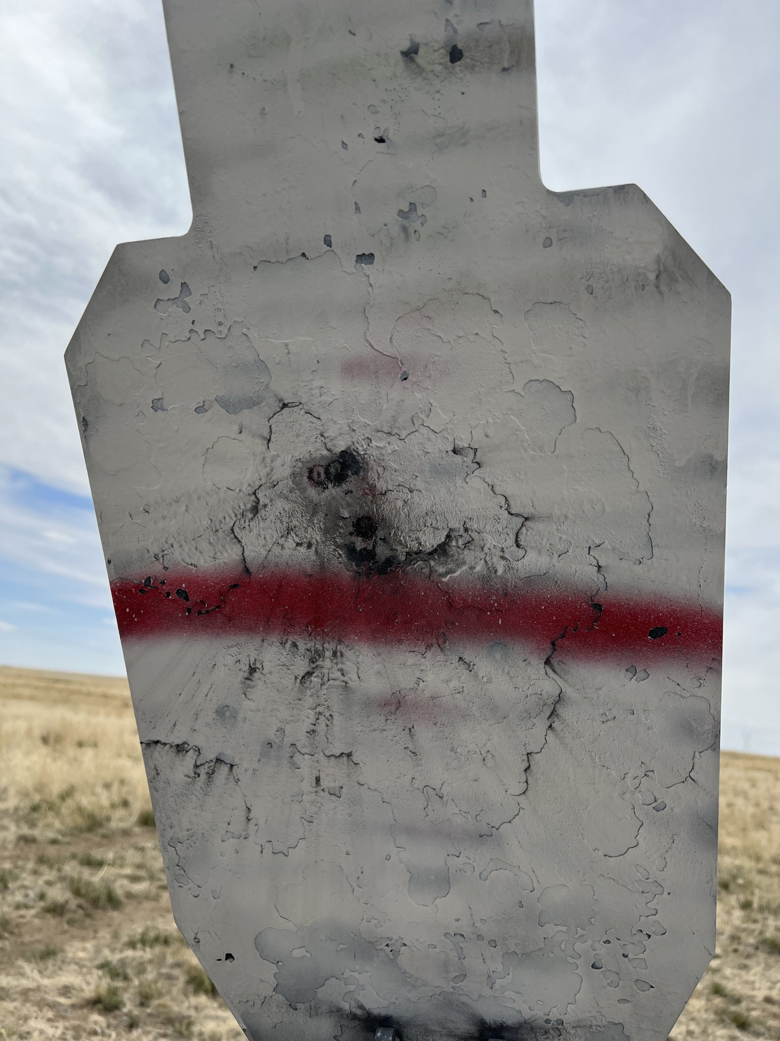

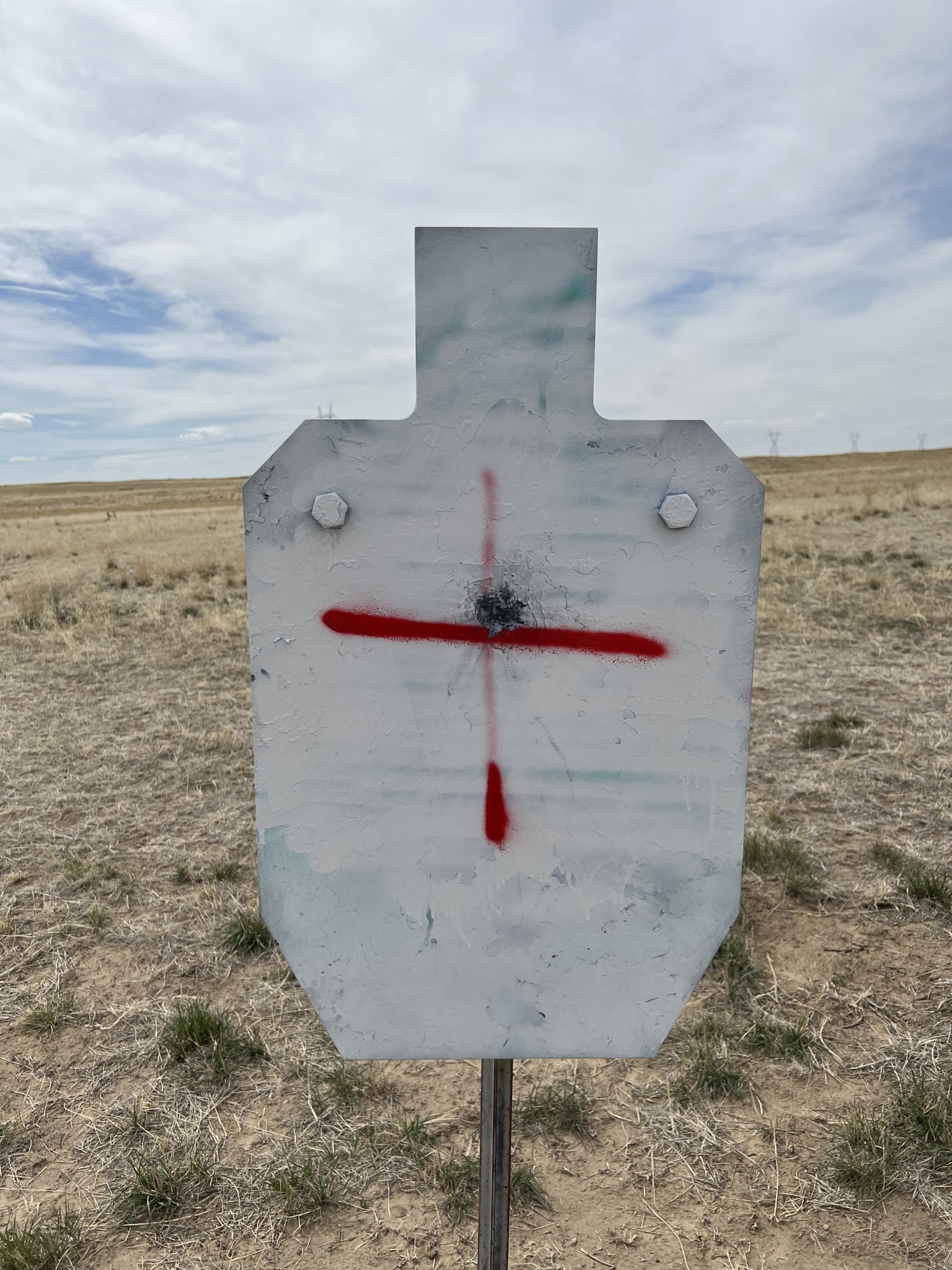

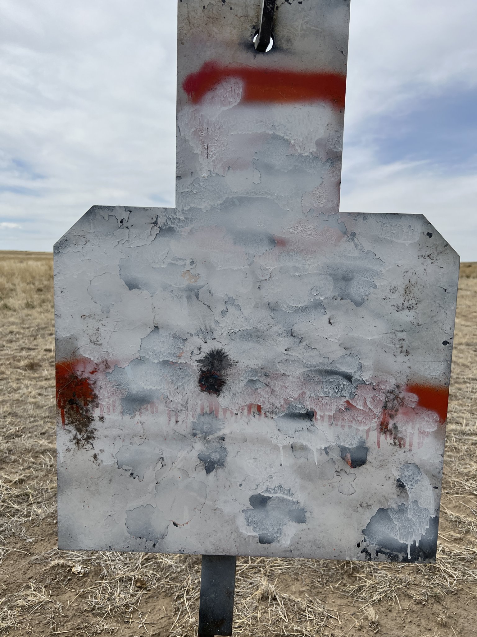

    Now I want to march out to the distance, as I noted the wind was whipping so initially I was pretty Lackadaisical about it until this happened at 400 yards right out of the gate.
    1.8 Mils to 400, held about .5 in the wind, and smack...
    Next, I went to 2.5 and shot at 500 yards,
    At this point, I am giggling, like really giggling because this ammo cost me 15 cents per round.
    Finally, I went to 600 before heading home,
    My jaw dropped laughing ... I am like WTF Over ...
    So I am happy, once I get the magazine issue sorted out I think I have a winner on my hands.
    The Bighorn works have no issue with an MDT Magazine, but that is a 2 lug action, if I can move the material around the 3rd lug I am golden.

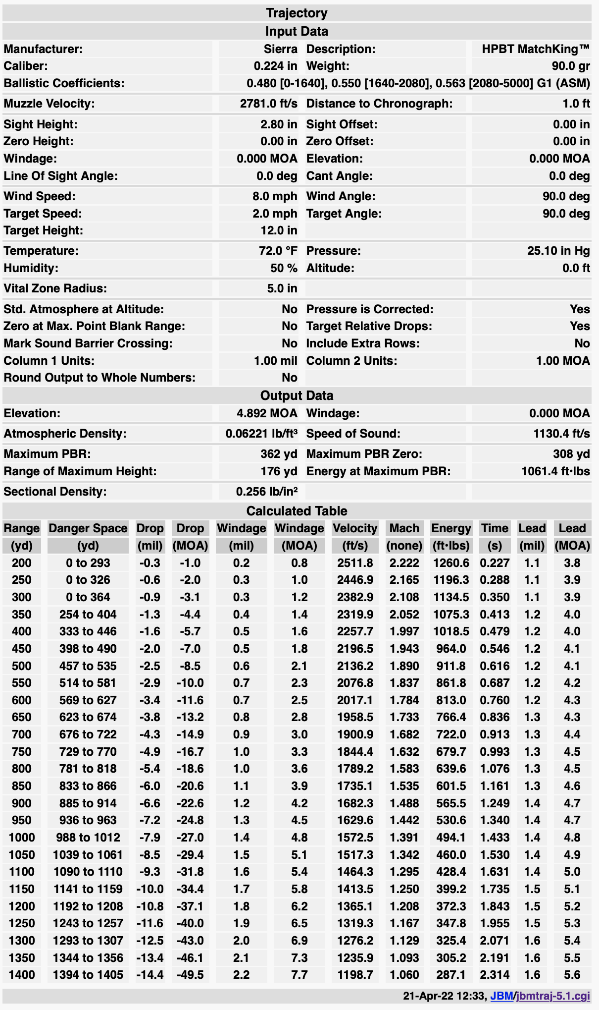

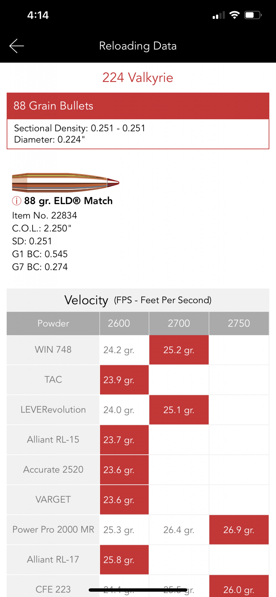

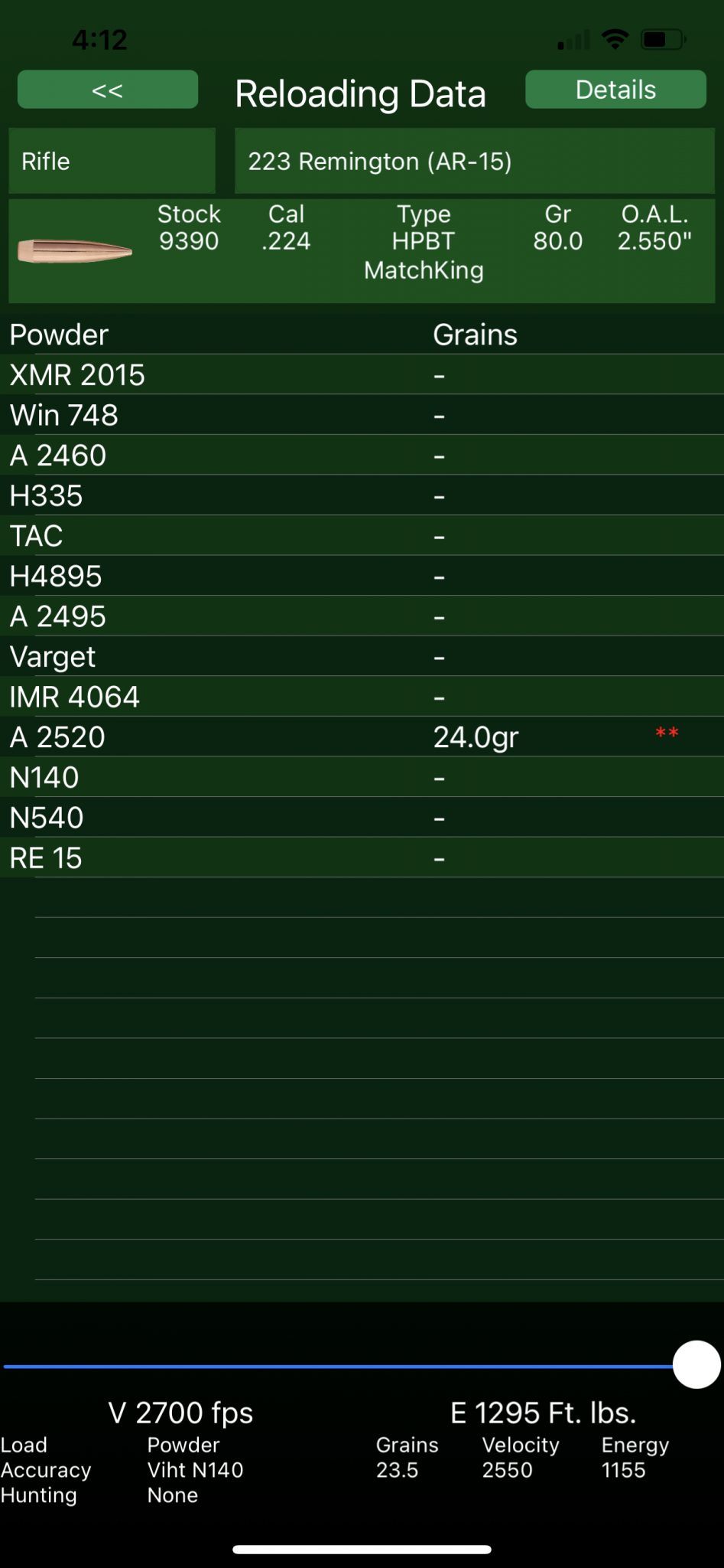

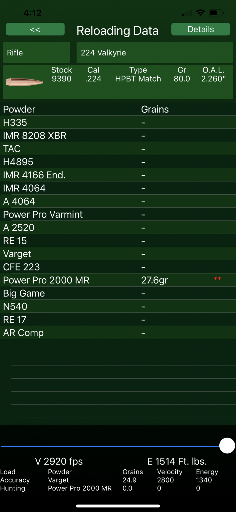

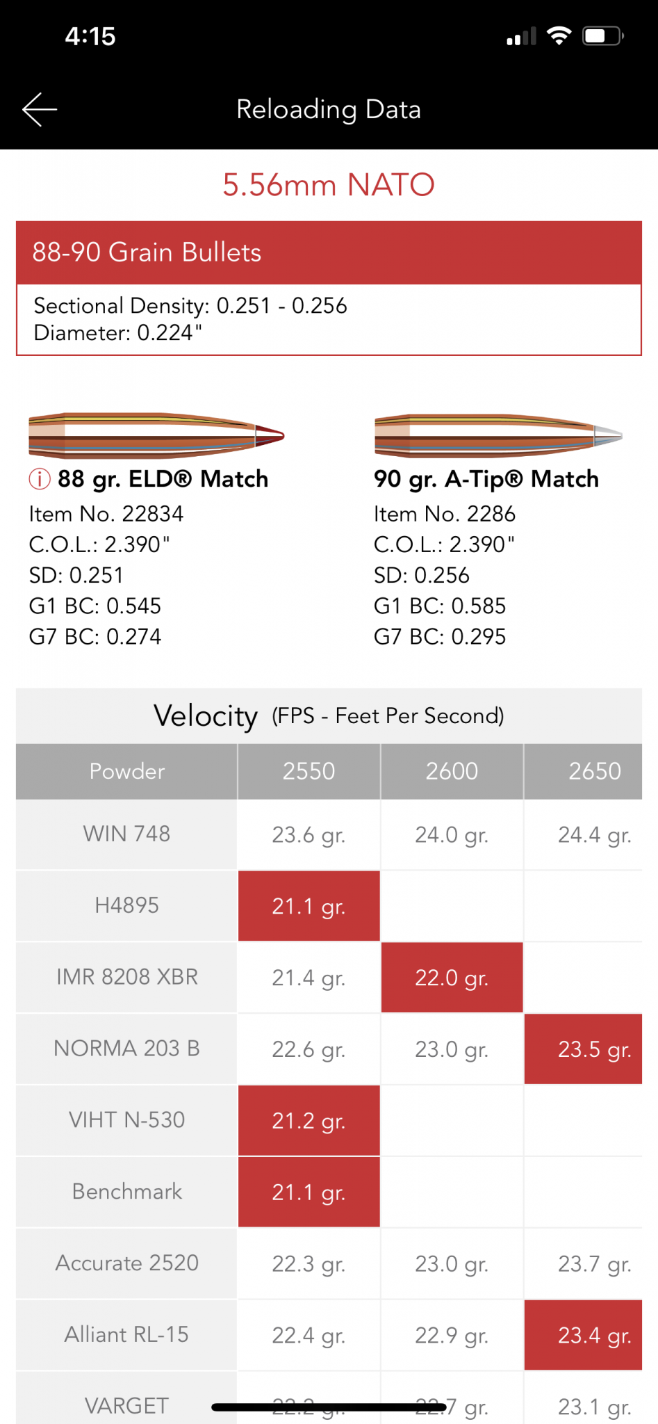

    @jzerfoss Very nice. Now make it fit into an AR15 magazine. The 224 Valkyrie has more case capacity and will push faster with less pressure. I've attached the info from Hornady and Sierra for comparison to SAAMI spec pressures. Obviously guys can and do go faster with bolt guns. As an FYI, Hornady doesn't have load data for 223 and the 88gr bullets, only for the 556.
    ETA: I had to show 80gr bullets for Sierra as they don't have load data for anything heavier for 223
