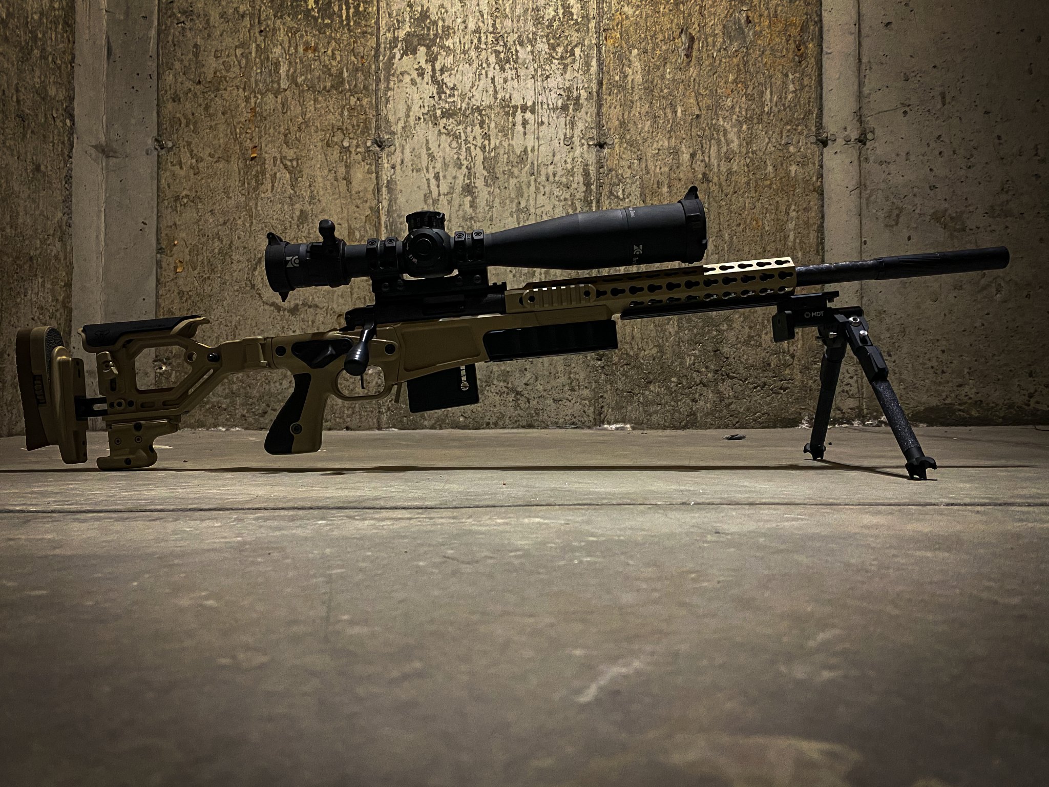

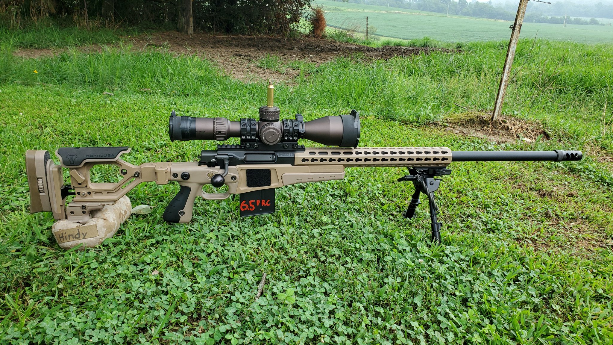

Great chassis, but if the grip doesn't feel right to you then its not gonna feel right. I love mine and also the old school thumbhole, but I rarely wrap my thumb.
View attachment 7431590Great chassis, but if the grip doesn't feel right to you then its not gonna feel right. I love mine and also the old school thumbhole, but I rarely wrap my thumb.View attachment 7431591

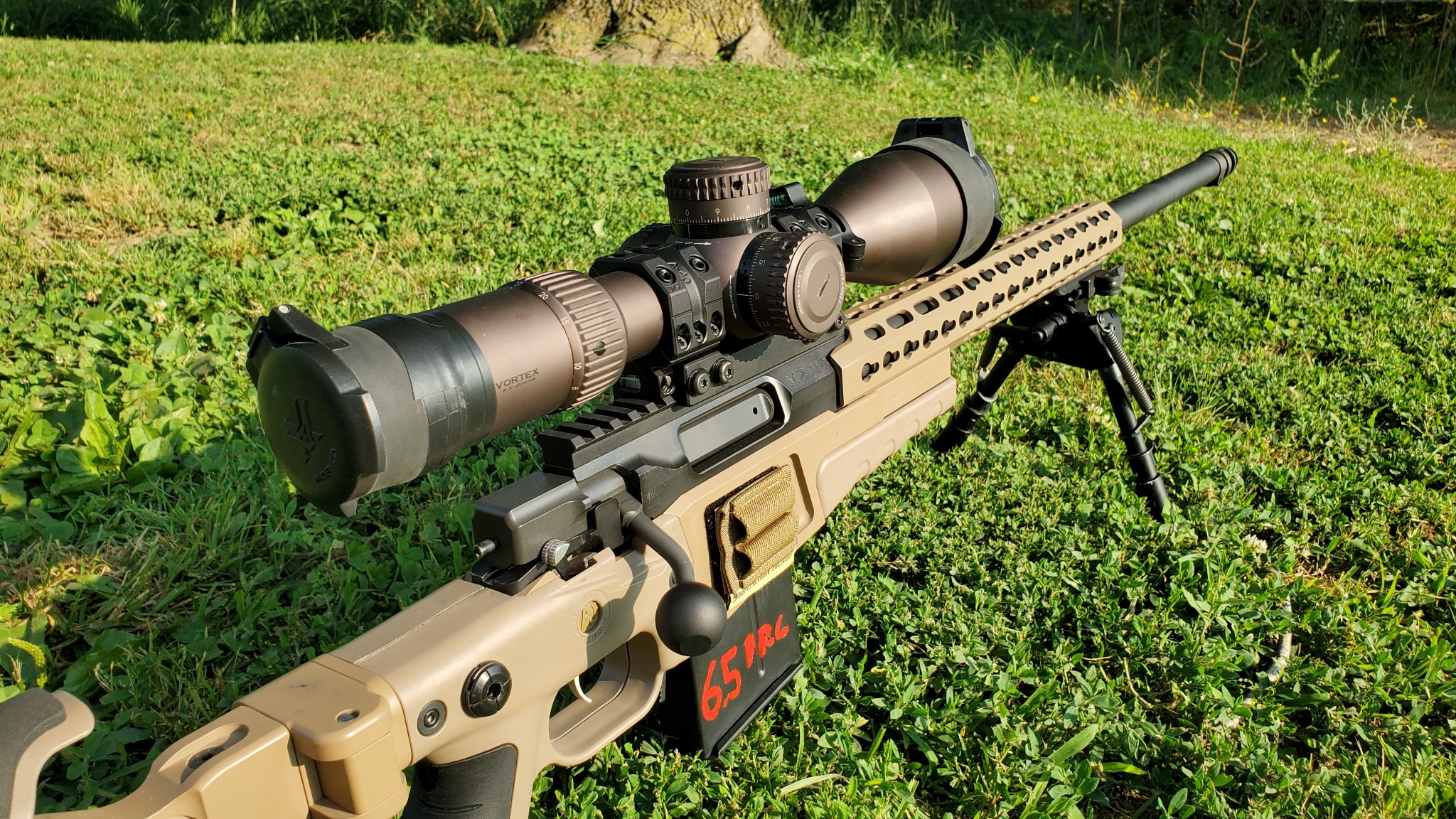

So I have a question on the 6.5 PRC. Are you running the 30WSM mags and how is the fitment in the chassis ? I will be running a 6mm SST II (Sherman Short Mag Tactical).
Thanks James
Yep, 300wsm accurate mag. It works just fine. Im using a badger action, chassis had to be fully inletted for it. Ive got a biddy that has a deadline(700footprint) in an ax, in 6.5prc. It works just fine with the 300wsm mags. He did have to file some of mag catch, but that was due to the oversized deadline bolt.
Gotcha, I would be running an Impact 737 S/A, so I would assume it to be good to go ?
James
Should be. Every action is a smidge different. Origins with 6.5prc, for an example, needs the rear feed lips pinched in to slightly lower top rd. If you don't, when it ejects empty brass, it will catch the empty between ejection port and top rd. With a spring ejector(impact) it will start ejecting case sooner than a mechanical ejector.

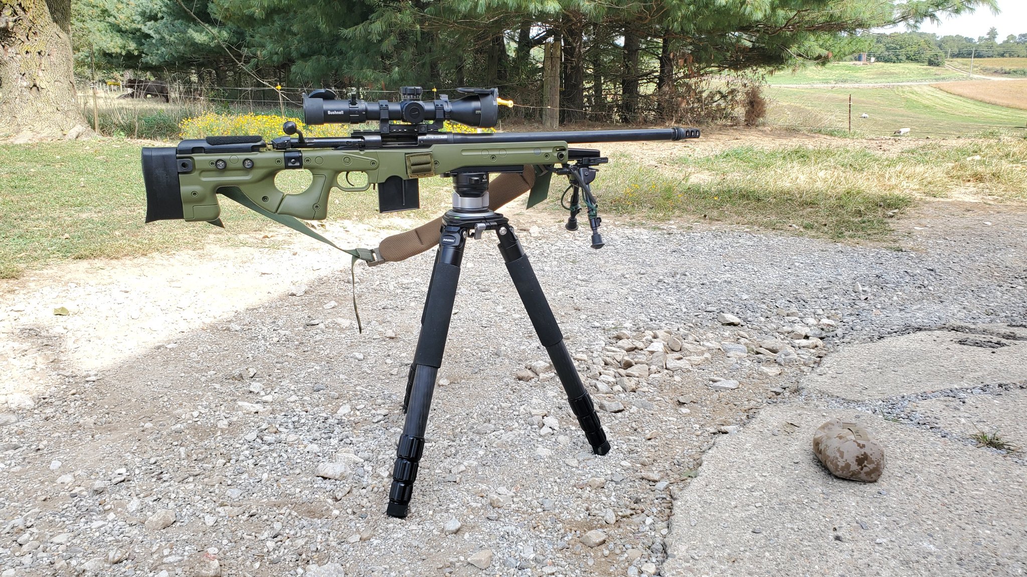

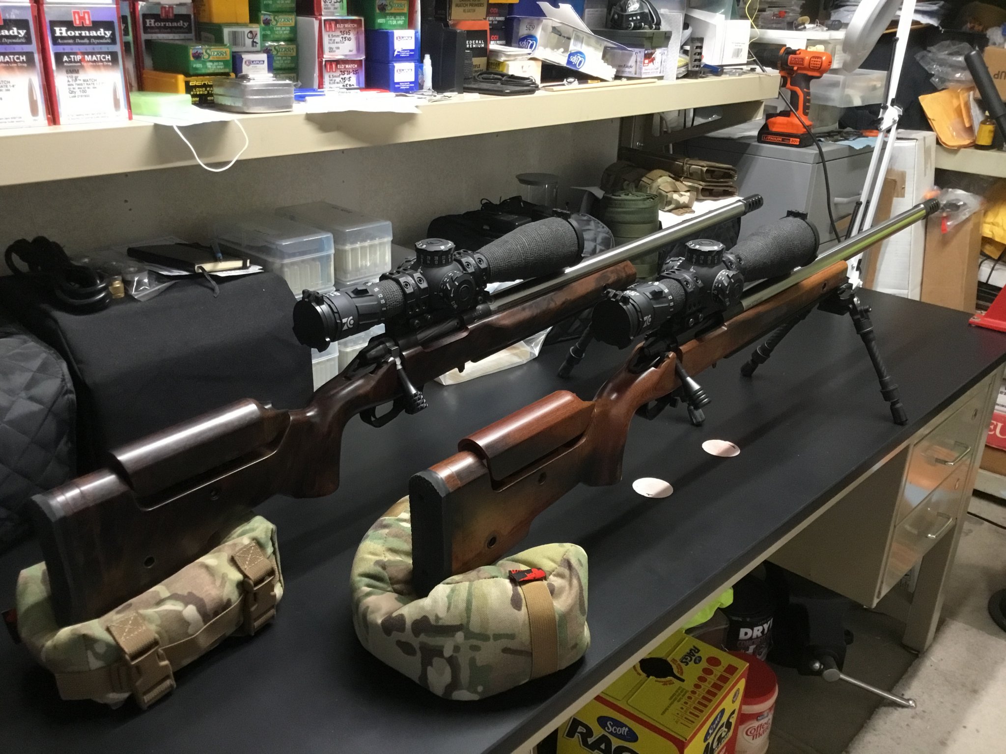

How does the AX shoot ? Any issues with cold bore shots. I run foundations now and are are very accurate.
I've never thought about chassis vs another chassis effecting cold bore....interesting question to make for a good little experiment...will cost some time for someone to test

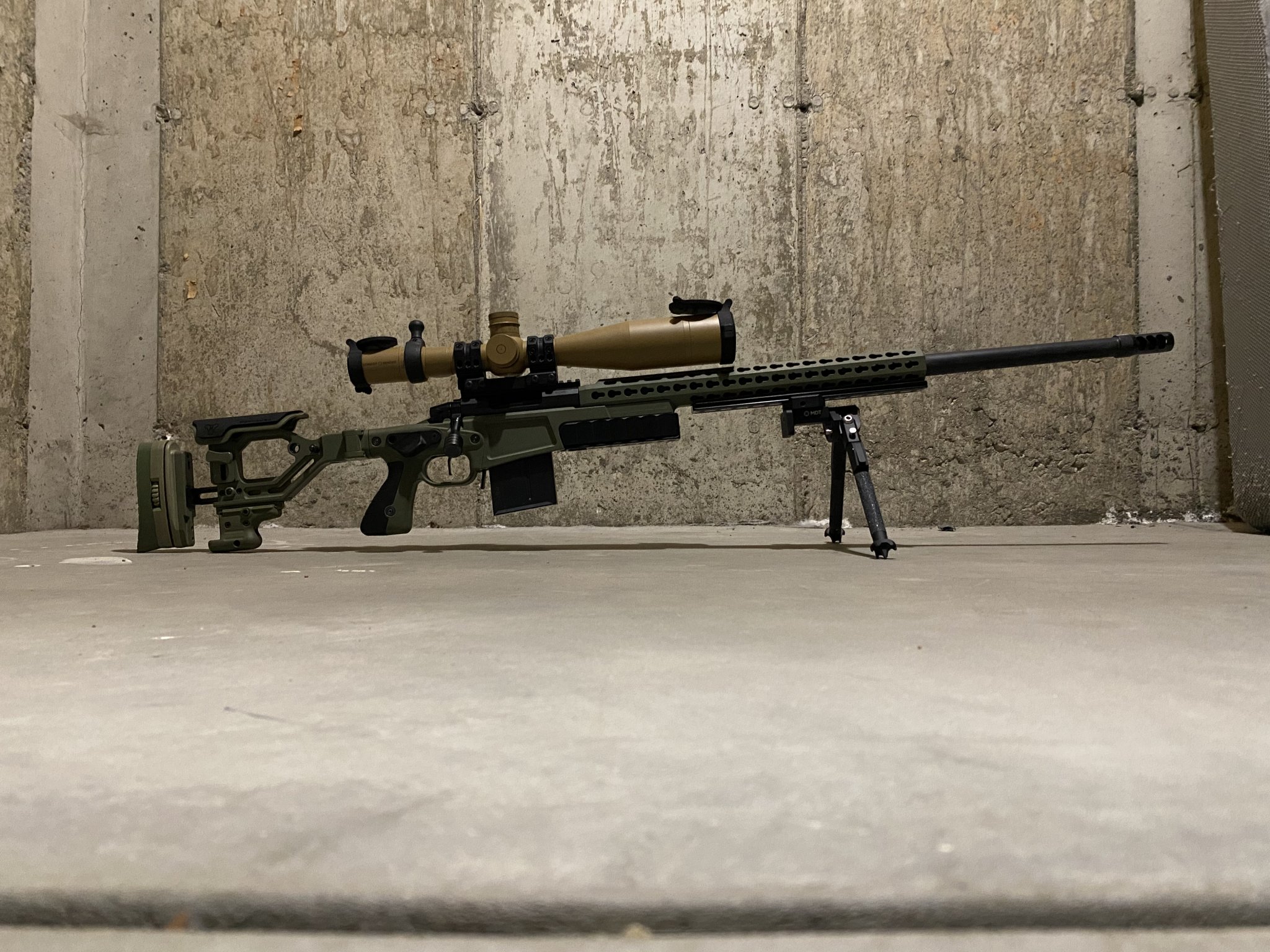

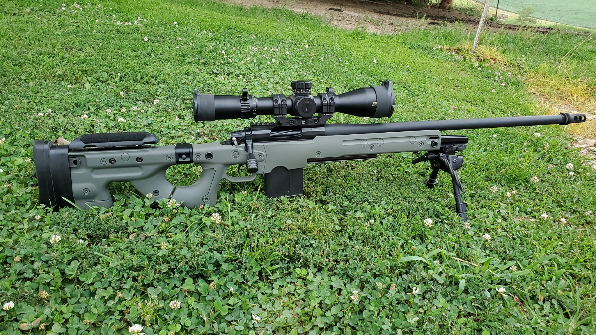

I own two SA post 14 AX chassis’d rifles. The sage green is an Impact 737r with a 6BR barrel and the tan one is a Vudoo V22 with a proof barrel. They both have the Anarchy Outdoors thumb rests and RRS aux plate and full arca rails on the forend. I love the way the feel and look and over all they’re great chassis’s in my opinion. The folding mechanism is nice and tight as you would expect on a premium chassis. I get phenomanal accuracy out of both of my rifles as well.
Note: if you’re going to be running an impact, you’ll have to relieve a little material for the trigger hanger and maybe the recoil lug. Takes 2 minutes with a dremel
