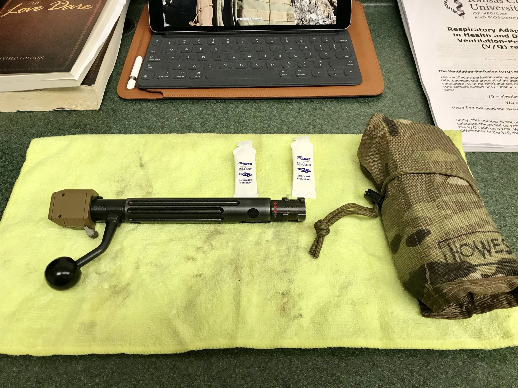

4 month old and About 420 rounds down the pipe, my rifle went down in class today.
Shot two rounds, then “click”, firing pin moved forward only a few millimeters, still protruding from bolt housing back.
Checked primer, no contact with firing pin.
Checked safety, wasn’t on, recocked bolt, moved safety, no problem.
Removed the bolt, inspected it, reinstalled, one more round then click.
Same symptoms.
Took gun out of service.
Some notes:
This happened one time before, ironically at the same firing line, 1,000 yards, but corrected after I cycled the bolt.
The safety has always felt “notchy”, not smooth to put on or off, but being a bolt gun not a big deal.
I’m mechanically inclined, armorer for most SIG products (but no AI).
Any thoughts of where to start?
I could remove the bolt and send it off to Mile High, sure it’s still in warranty, but would like to resolve locally if possible.
Thanks!

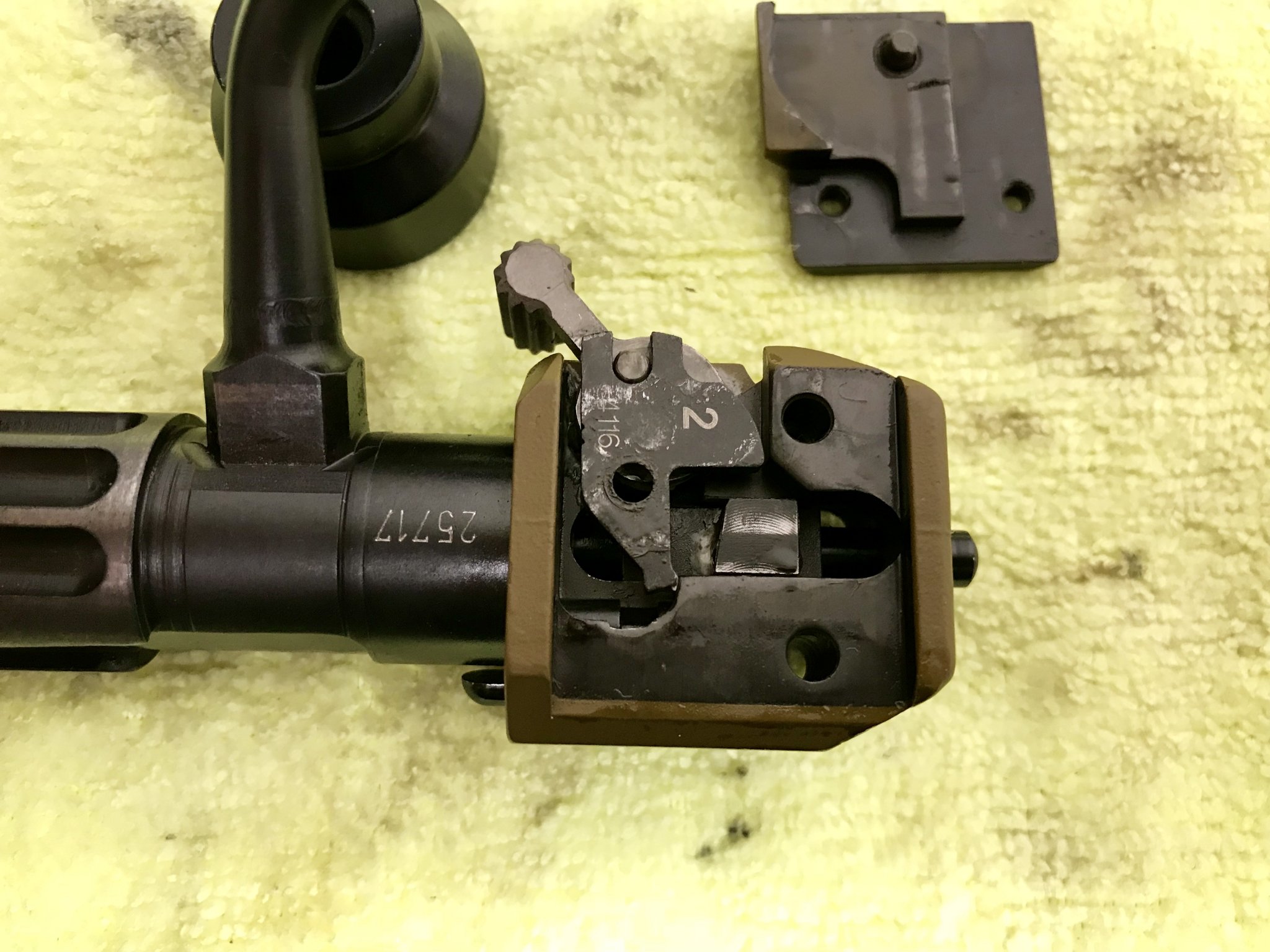

Disassemble the bolt, pull out the firing pin assembly, clean and flush the bolt housing out & then re-assemble.
Most likely a piece of primer flew in the hole & jammed it, or some other piece of debris did.
Happened to me the first couple shots with my AWSM and then never again.
Like W54 said, pull the striker assembly out and inspect closely.
I don’t think mile high would bat an eyelash at fixing it after any duration, warranty period be damned.
Achivement Unlocked.

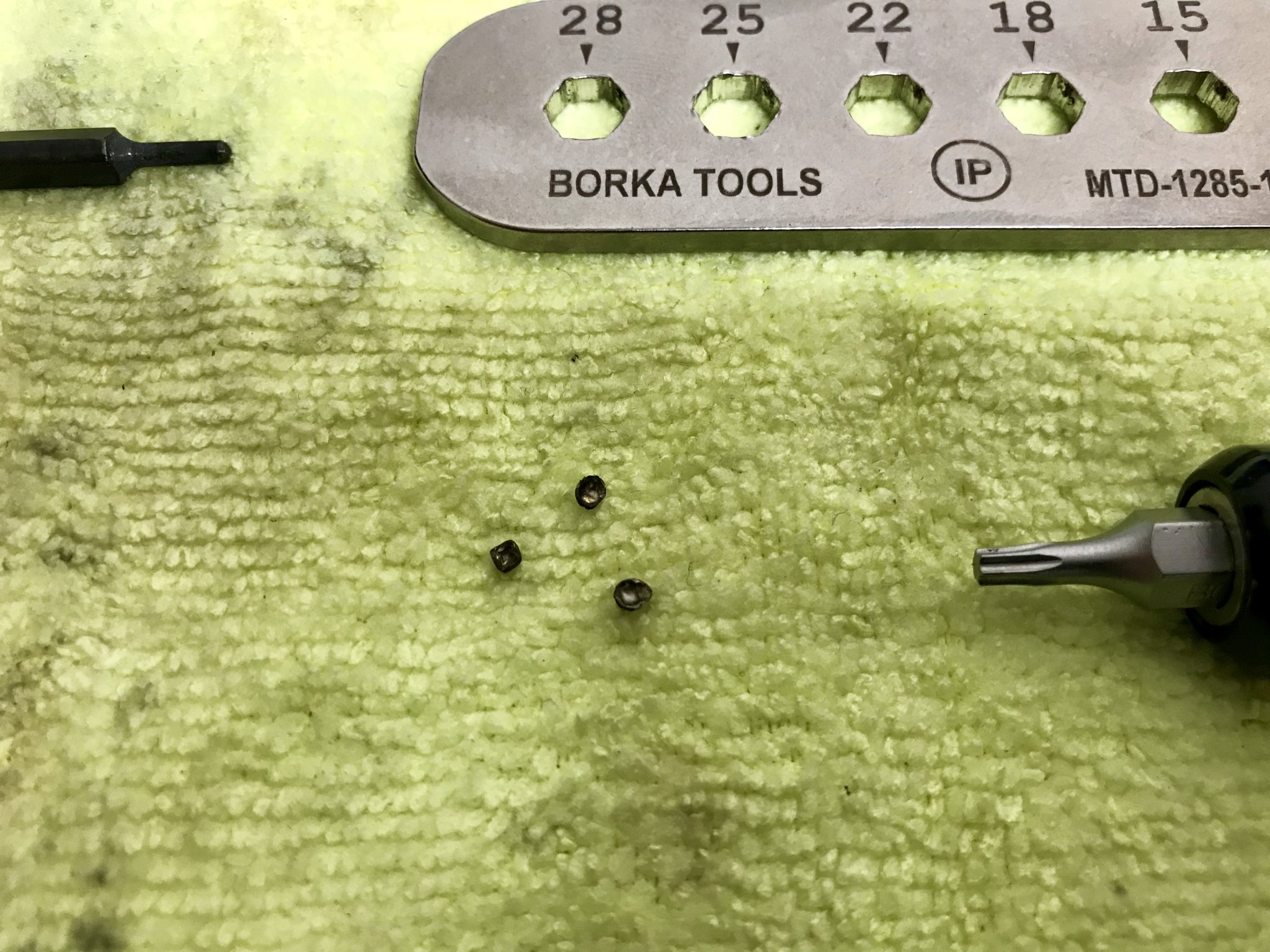

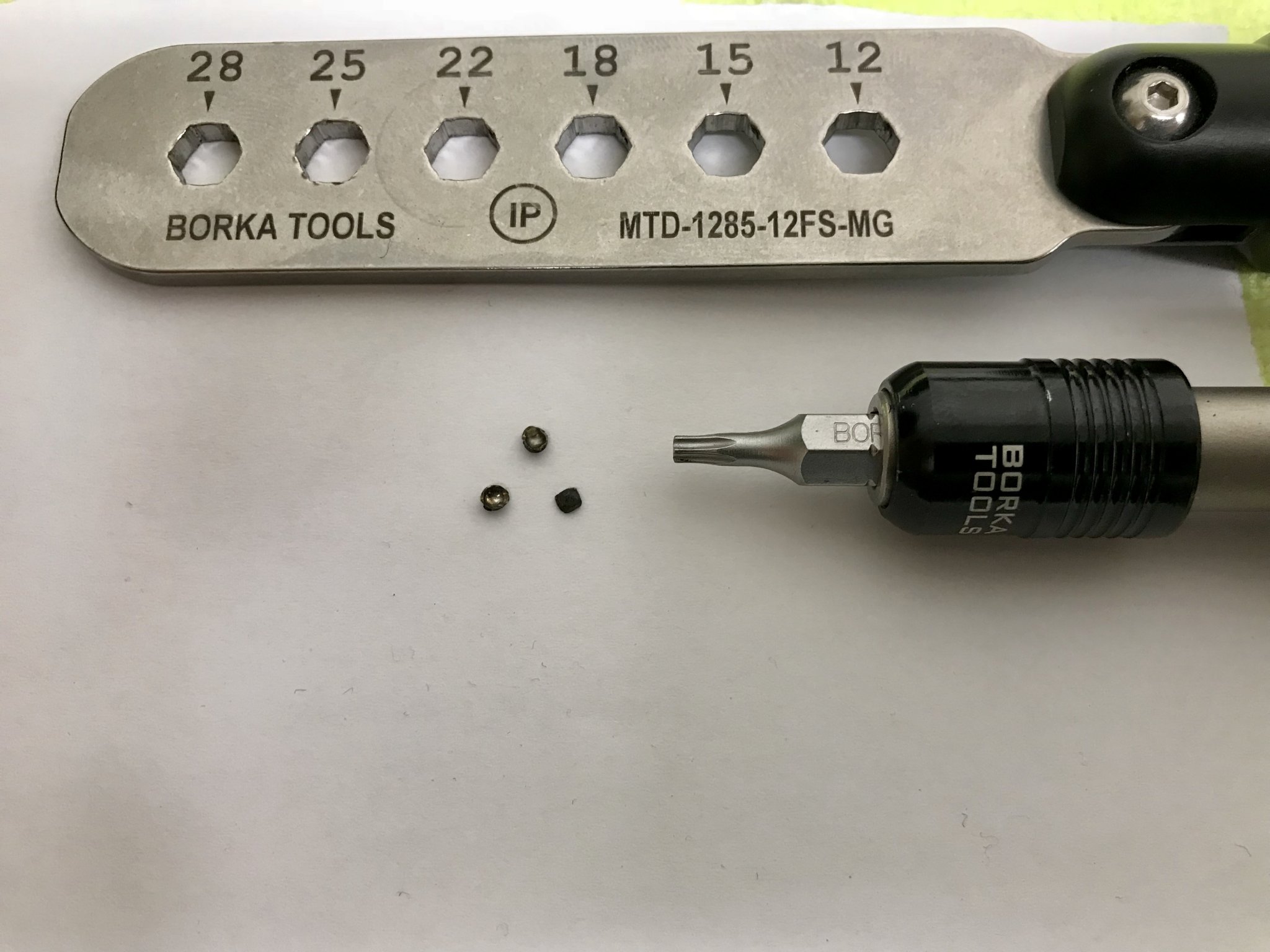

Thanks @Tack425 and others for all the feedback and tips!
Also @W54/XM-388 nailed it, see below.
I’ll share this in case it might help someone else.

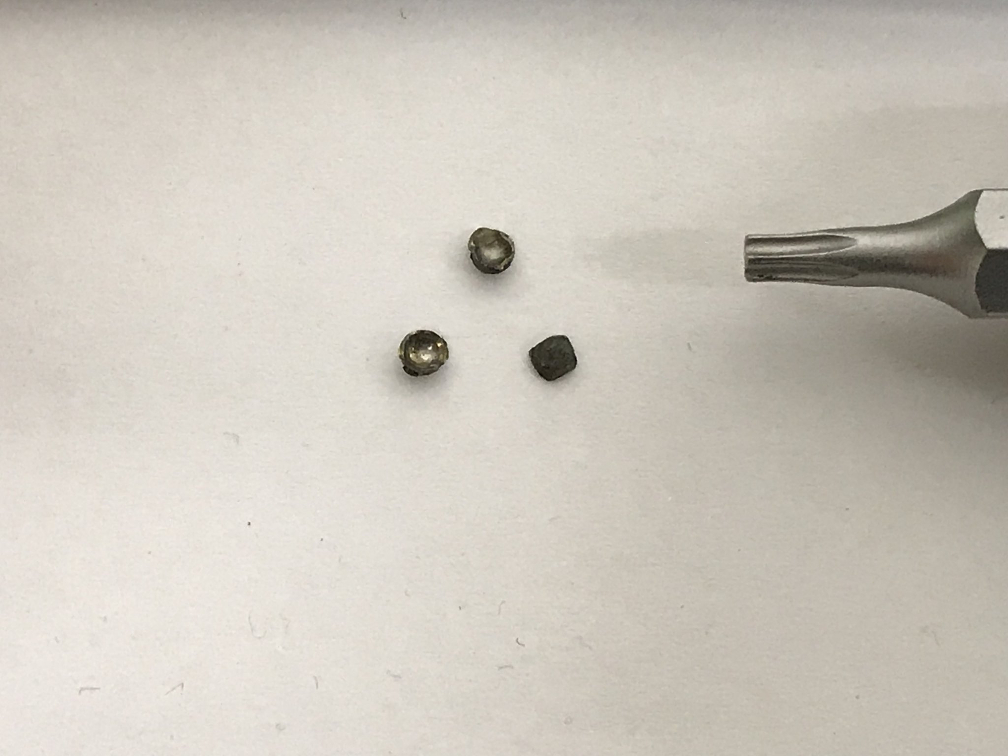

Was able to disassemble the bolt and insect for failure mechanism.
Found 3 primer chips/debris stuck in the bolt housing, preventing the firing pin from going forward. Always have shot factory Lapua Scenar ammo, so surprised to see this.
Appears that some of the primer case must break off, stick to the firing pin and then get pulled back into the bolt body.

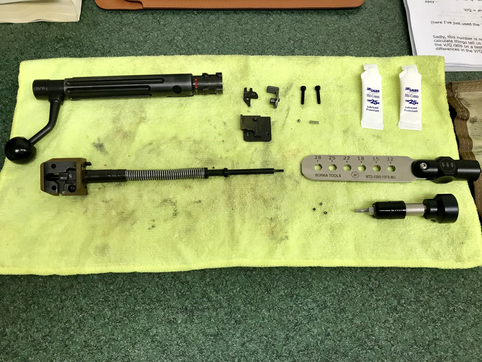

Rather clever design, allows one to field strip and service the bolt very easily with no tools. I also took apart the firing pin safety block, cleaned and lubricated that. It’s been “notchy” and hard to move, a little Milcom TW25 did the trick, like glass now.
I’m going to monitor this, since the failure occurred right around 400 rounds, think a good service protocol would be disassembly of the bolt every 200-250 rounds or so to check for debris.
Cheers.

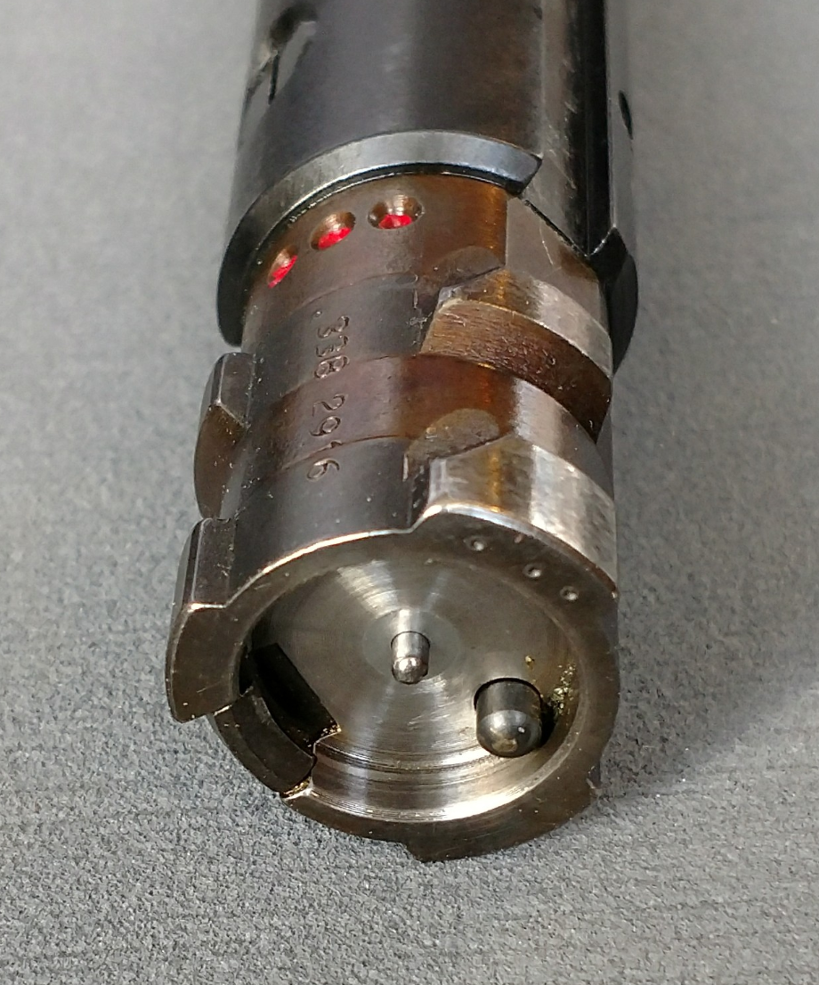

I had the same problem with mine. It's called primer flow. The problem is that on the AXMC with the hotter magnum calibers, the firing pin clearance hole is too big and let's small shards of primer thru the opening. After a few pieces get in there, they start jamming things up. LRI has a service where they will turn your firing pin head diameter down to the small firing pin dia. and install a bushing in the bolt face where the pin comes thru. The tolerance of the new clearance hole is way tighter than factory. This process eliminates primer flow. It is not that expensive and turn around time is two weeks or sooner.

I would call the guys at Mile High tomorrow. If you send your bolt assy. to them for this problem, they will send it to LRI as well. I don't think you'll get AI to admit that there's a problem if that's what you're asking.

Range Report: Ran 50 rounds through the rifle after the bolt cleaning and service.
Thought I'd check the bolt and see what I find.
Removed and disassembled on the bench while still at the range, easy peezy now, takes less than a minute.
One primer flow "cup", at least that's what they look like, little cups, broken off the primer, and captured inside bolt body.
Rifle did not malf, but thinking that's only a matter of time.
