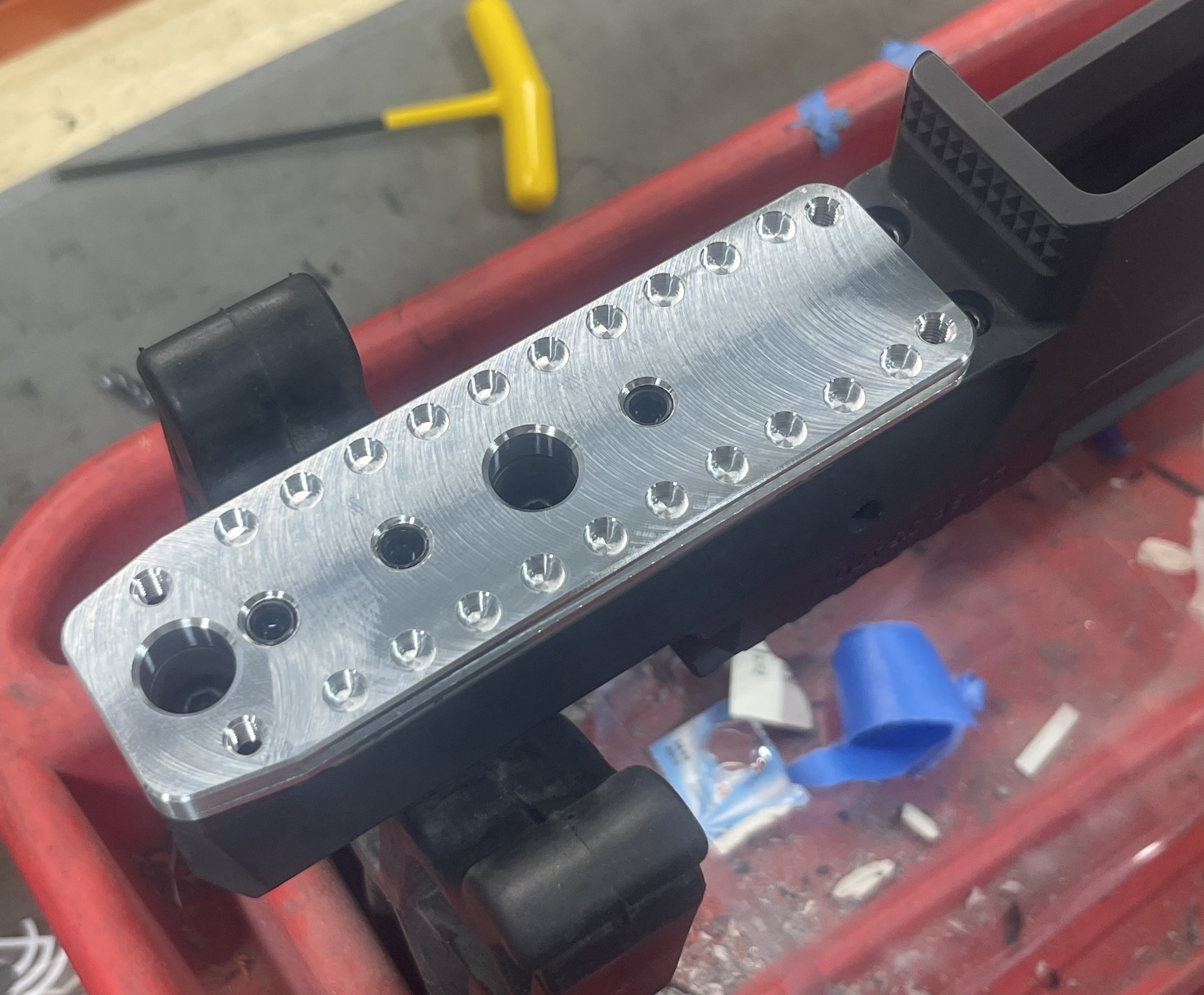

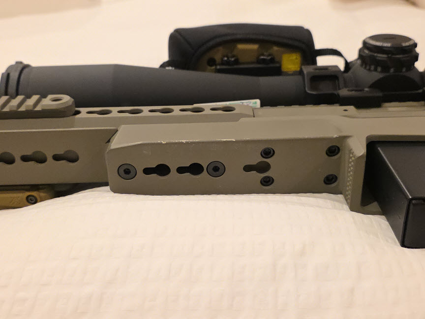

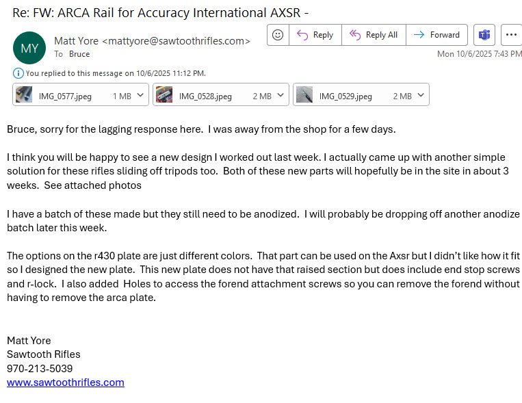

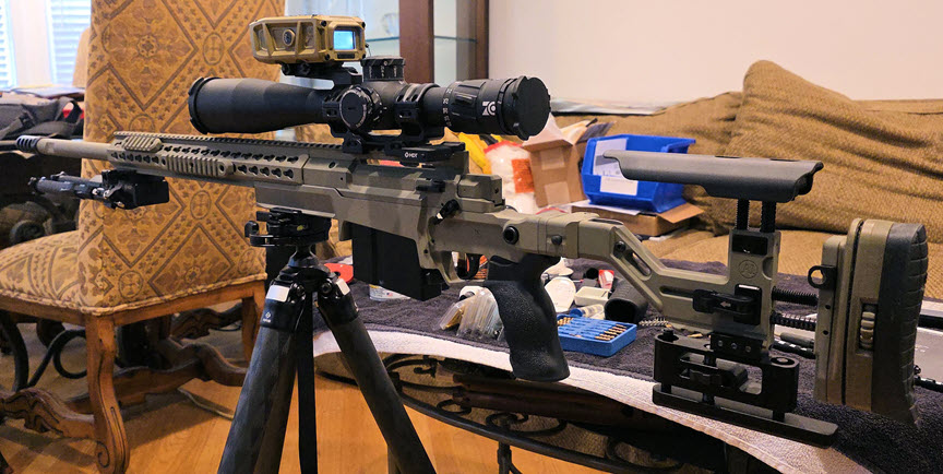

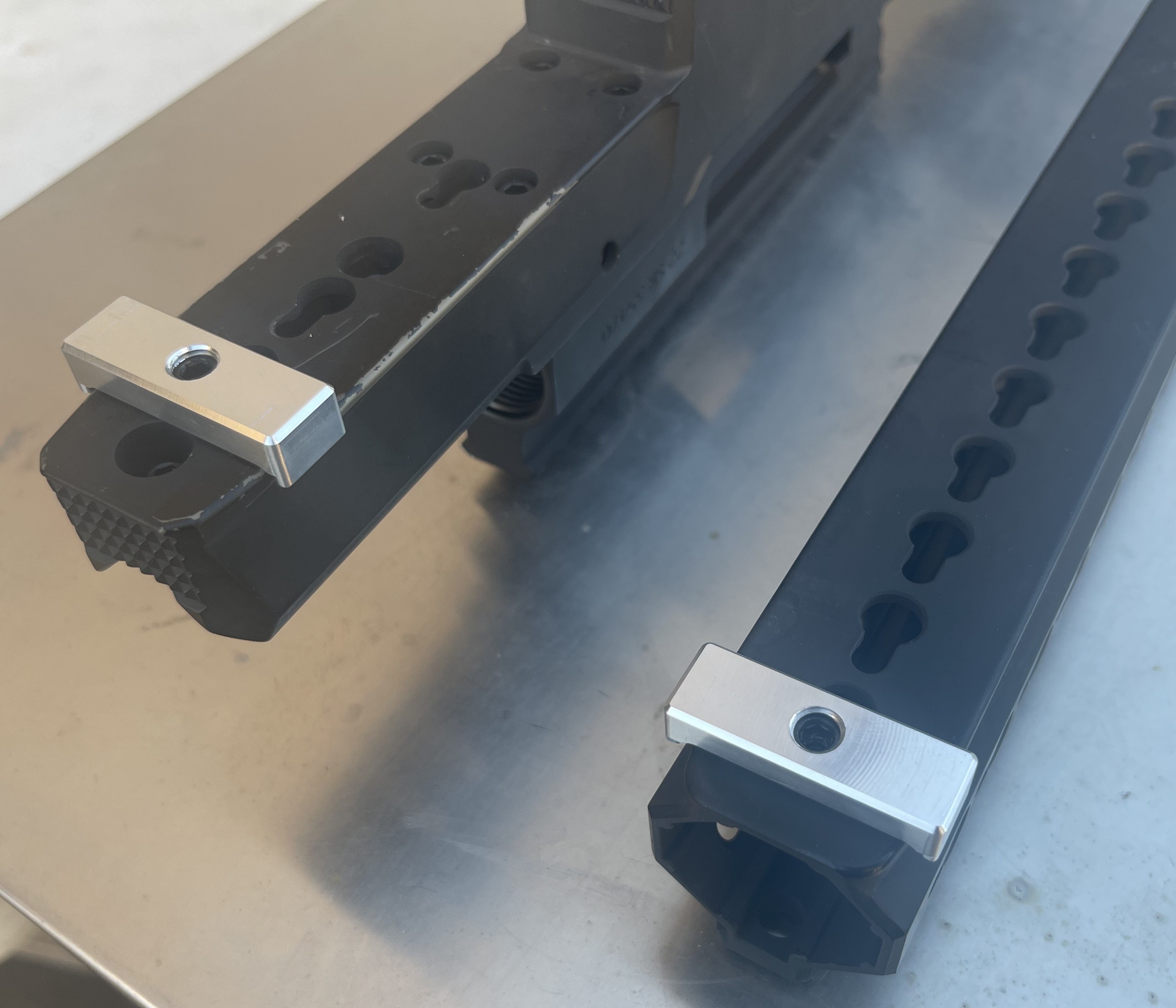

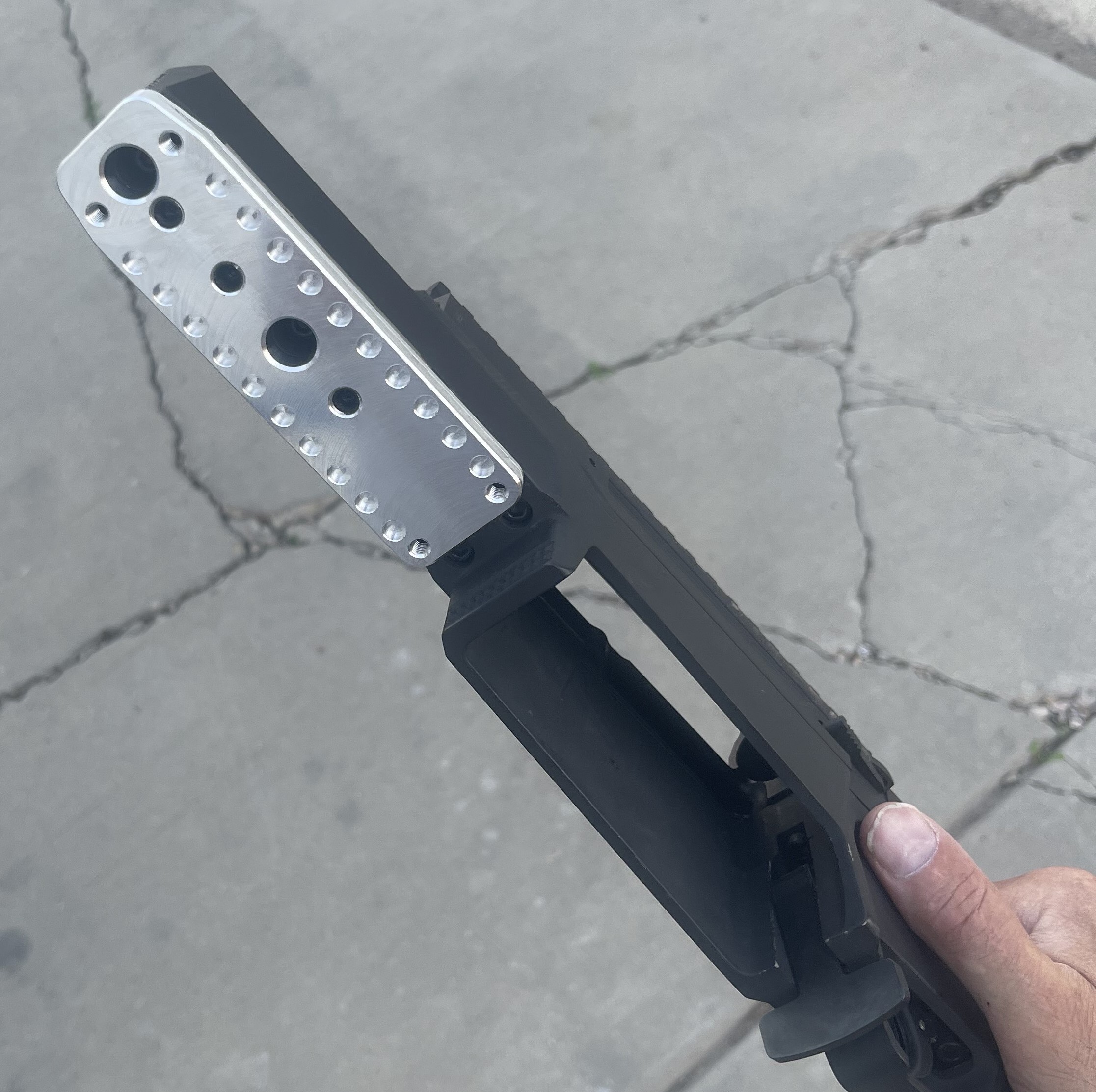

What do precision rifles have in common with cars and motorcycles? Owners always want to add or upgrade things and my Accuracy International AXSR is no exception. I’ve noticed mounting the rifle in my Really Right Stuff carbon fiber tripod and Anvil 30 ballhead, the Cerakoting was rubbing off the chassis where it was clamped into the ballhead.
I sent out two dozen emails to gunsmiths and vendors looking for a solution. My thought was to mount an ARCA plate to the rifle’s chassis which had a built in ARCA rail, but the constant clamping of the rifle into the tripod ballhead was scratching the Cerakote finish from the rifle.
Gunsmiths and vendors were responding with no direct solution, so I managed to find an ARCA plate that was close, but then having to purchase four small proprietary fasteners for Accuracy Internationals keyslot mounting system. Four tiny screws cost almost a Franklin.
Why not a transparent plastic solution or tape, because it isn’t a great solution and looks tacky. Also, the anodized finish is more durable than Cerakote.
If you’re persistent enough you’ll eventually succeed. Matt Yore of Sawtooth Rifles responded just after I ordered my workaround solution with a part that is exactly what I was looking for. He makes an ARCA rail that fits perfectly on my AI AXSR rifle with his ARCA rail coming with the necessary proprietary fasteners. The parts are being finished and sent out to be anodized, I’ve asked if I can get “Sage Green” to match my rifle.
So, like my motorcycle and car enthusiasts, I’ll have a few more things to add to my shelf of ideas that were close or sounded good at the time, but looking forward to getting the perfect part. Matt’s ARCA rail also has stops to prevent the rifle from sliding out of the tripod mount, cool!

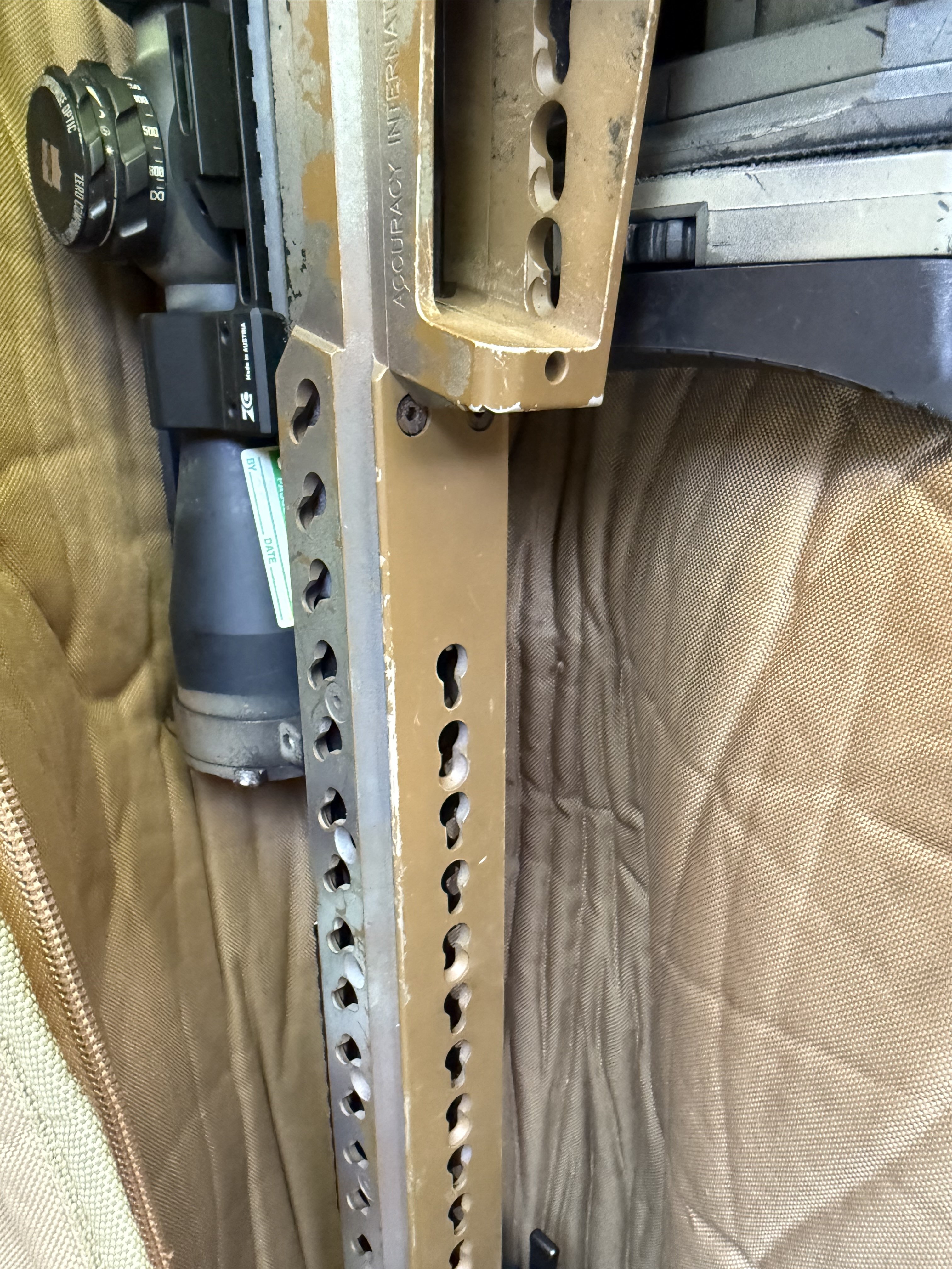

I’ve noticed . . . . . . , the Cerakoting was rubbing off the chassis where it was clamped into the ballhead.
. . . . . . but the constant clamping of the rifle into the tripod ballhead was scratching the Cerakote finish from the rifle.

We don't give a shit about finish and coatings. As long as they still sell Krylon, we good.
It's just that it's a bit inconvenient when a rail is so fucked up shit won't even even function properly on it.
BTW, I think the sexiest rifle is one that has a lot of the finish rubbed off from actual use but still works. Your pic is schweeeet.

Does the manufacturing of a part to reduce or eliminate wear on a chassis rifle make the manufacturer a poser as well? Does finding a solution to an issue that reduces damage to a rifle and solves a design flaw make someone a poser?
One of my dear friends who owns a security company and spent most of his adult life in the military with six tours of duty in Navy keeps his guns and hotrods in pristine condition. No one would mistake him for a “poseur.”
Having an anodized ARCA rail attached to my chassis will not eliminate scratches, but it will be more resistance than a Cerakote finish over what is likely a softer aluminum chassis.

Understand, in long range shooting, typically gear is used and abused. It is most definitely not like ATA Trap, shooting with $27k Perazzi shotguns with gold inlay in the engraving.
To answer you main questions; no. The ARCA specs that AI use is the RRS spec (with the finish thickness factored in), so adding something (like an additional clear coat) to it will increase the width and possibly cause issues with the ARCA clamp closing all the way.
AI's are built, and intended, to take a lot of abuse. They are most definitely not intended to be safe queens, or look pristine. ARCA rails will get dinged, scratched and scraped. It's just part of using ARCA as a clamping system.

Just a comment about the RRS Anvil-30 ARC Lever-Lock Ball Head, it has a user adjustable screw on the newer models that allow you to adjust the tension of the clamp.

The problem with adjusting the Anvil (which I also own), is now your other non-worn ARCA plates won't lock into place. They're adjustable to account for all the (then) cheap Chinese ARCA bases that were not all the same spec (there basically wasn't a true spec until RRS published theirs).

The AI chassis on your rifle is 7000 series aluminum. The Sawtooth rail is 6000 series aluminum. The aluminum alloy of your chassis is harder and stronger.
And it’s not that you are attaching an ARCA rail to your chassis…. It’s that you are attaching an ARCA rail to your ARCA rail. Doing so doesn’t make you a poser, but it is objectively gay.

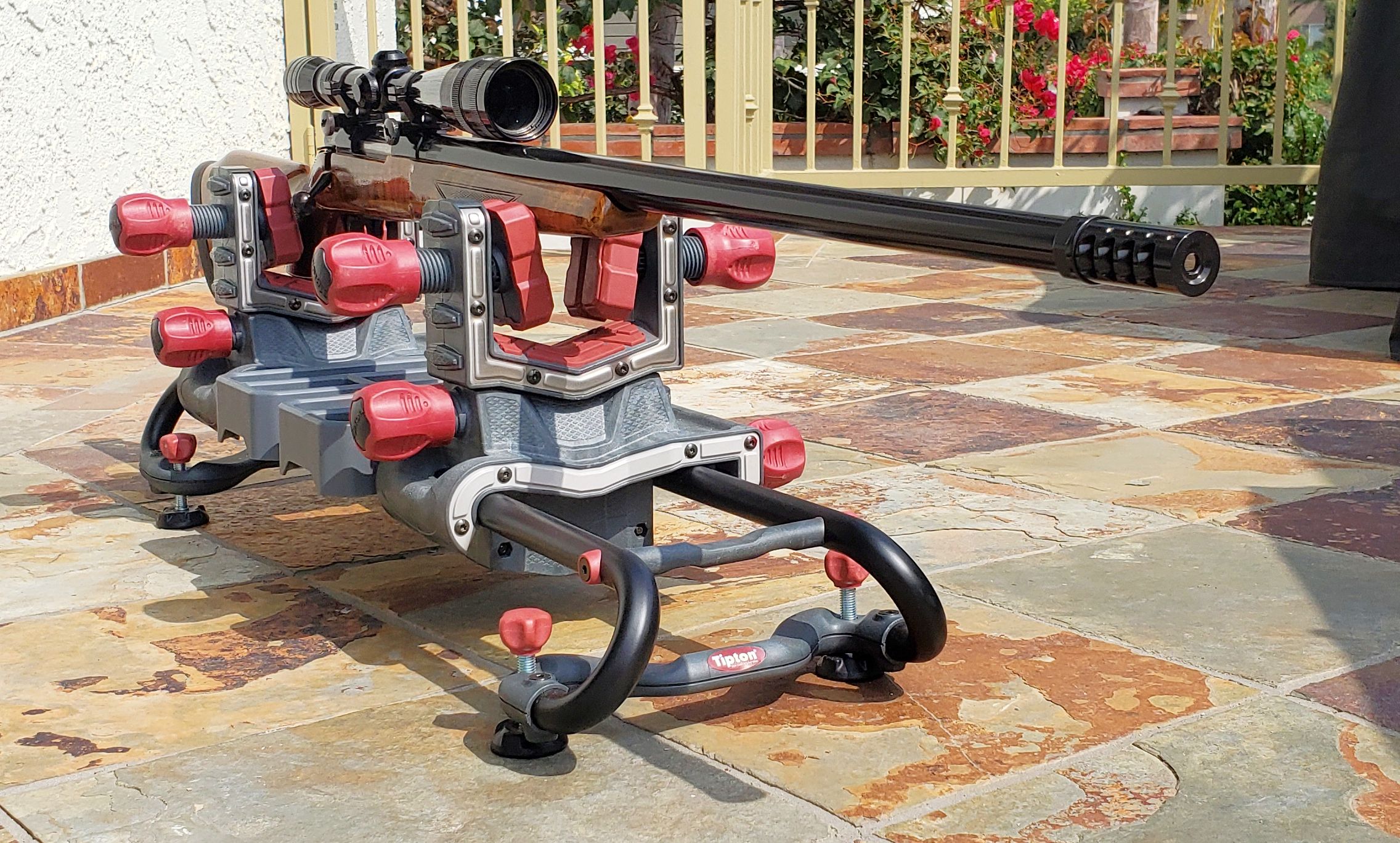

If you like Sako's, you might also like my father's L579 I had restored at Blue Mountain Precision.
It was originaly an L579 in .243 Winchester. He shot the barrel out and replaced it when a Shilen in .243 Ackly Improved. His friend was a benchrest competitor and this rilfe was glassed bed with Devcon, the barrel free floating, the trigger replaced with a Canjar set trigger releasing at around two ounces set.
I had Eric Anderson, owner of Blue Mountain Precision rebarrel it with a custom 26" Hawk Hill barrel, cut rifling with a 1 in 7.5 twist rate, heavy contour in 6mm Creedmoor with a custom chamber to shoot the 105 grain Hybrid Target bullet. The freebore was reduced from the SAAMI spec of .183 to .135, the neck .275. Barrel was fitted with an APA Gen III Little Bastard muzzle brake and barrel was Cerakoted with high gloss clear. I asked Eric to check the action and blue print it if necessary. He checked it and said like most Sako actions, they are straight and this one did not need a thing.
Eric is a known PRS shooter and gunsmith frequently competing in national PRS events time permitting.
I haven't had time to change the Sako mounts and rings to accept 30mm or 34mm optics yet, nor have I developed a final handload yet. But on a warm afternoon I shot this five shot group at 100 yards with a fifty plus year old optic with no parallax adjustment.

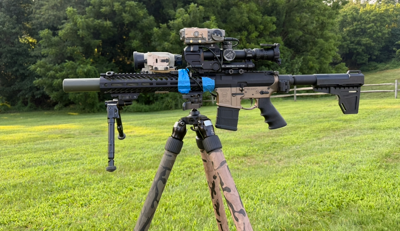

To be fair. More serious people do that with hnt26 so they don’t have to worry about damaging the cf arca

I think some of their chassis components are 7075 and some are 6061.
If that is true, they would probably not elect to do any anodizing unless they kept everything black.
It is damned near impossible to get anodized color matches between the two alloy types. Black is manageable but any other colors are a MF'r.
Anodizers will not guarantee a match and will usually try to dissuade attempting it if they figure out that is your goal.

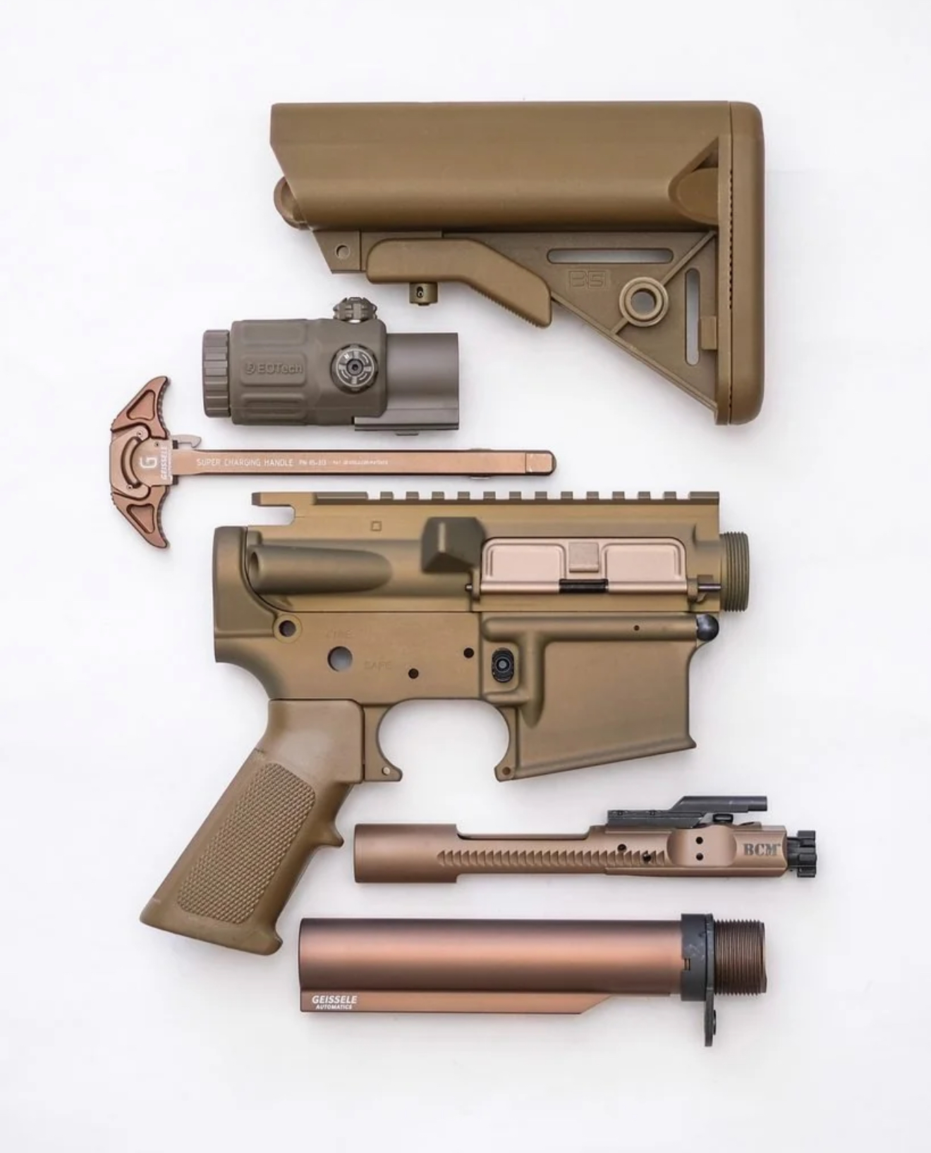

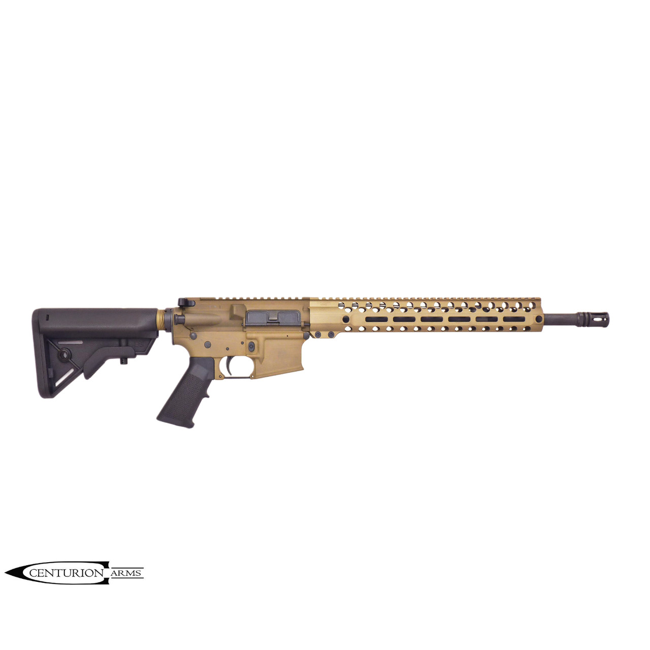

I think some of their chassis components are 7075 and some is 6061.
I'm prolly talking out of my ass here but hey, usual day.
I mean, people have grown to like the 50 shades FDE SCARs.
I'm in the camp of AI should have anodized the aluminum bits like they did in the PSR. Cerakote is such a cheap finish, it scratches and peels too easily.
