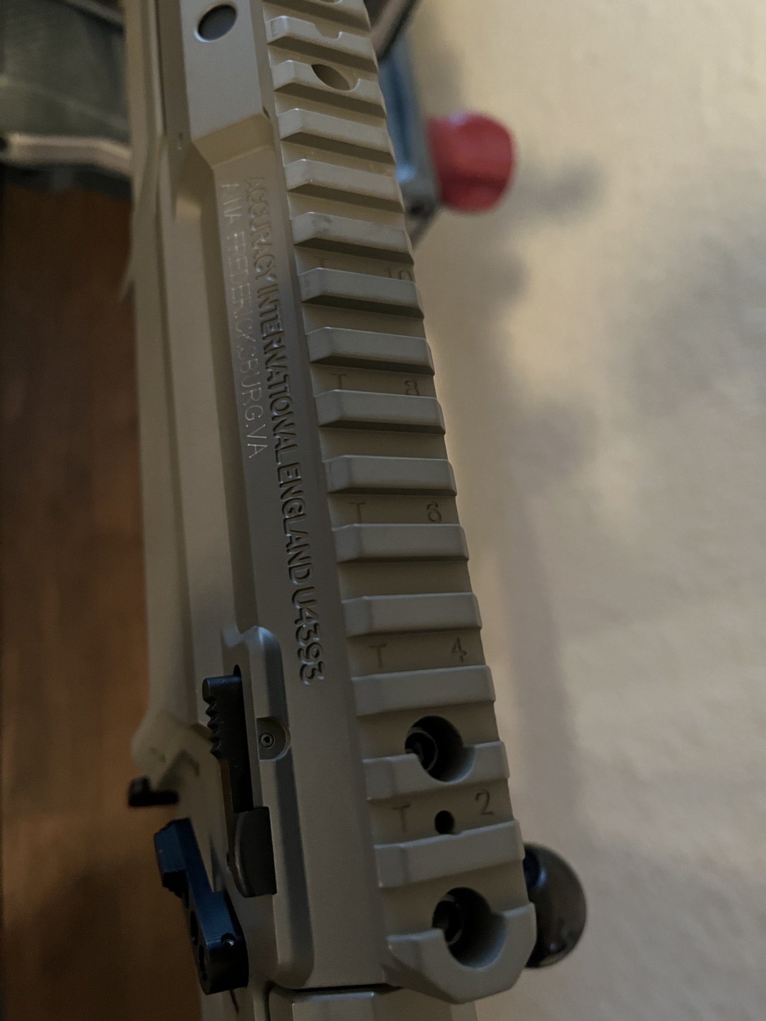

Are handling marks, cycling wear and scope mount gouges common in new AI? Not a huge deal on my end, but was just curious to hear what other AXSR owners’ experience was.

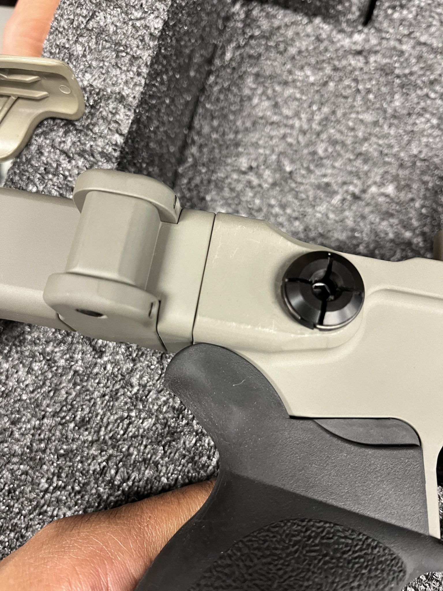

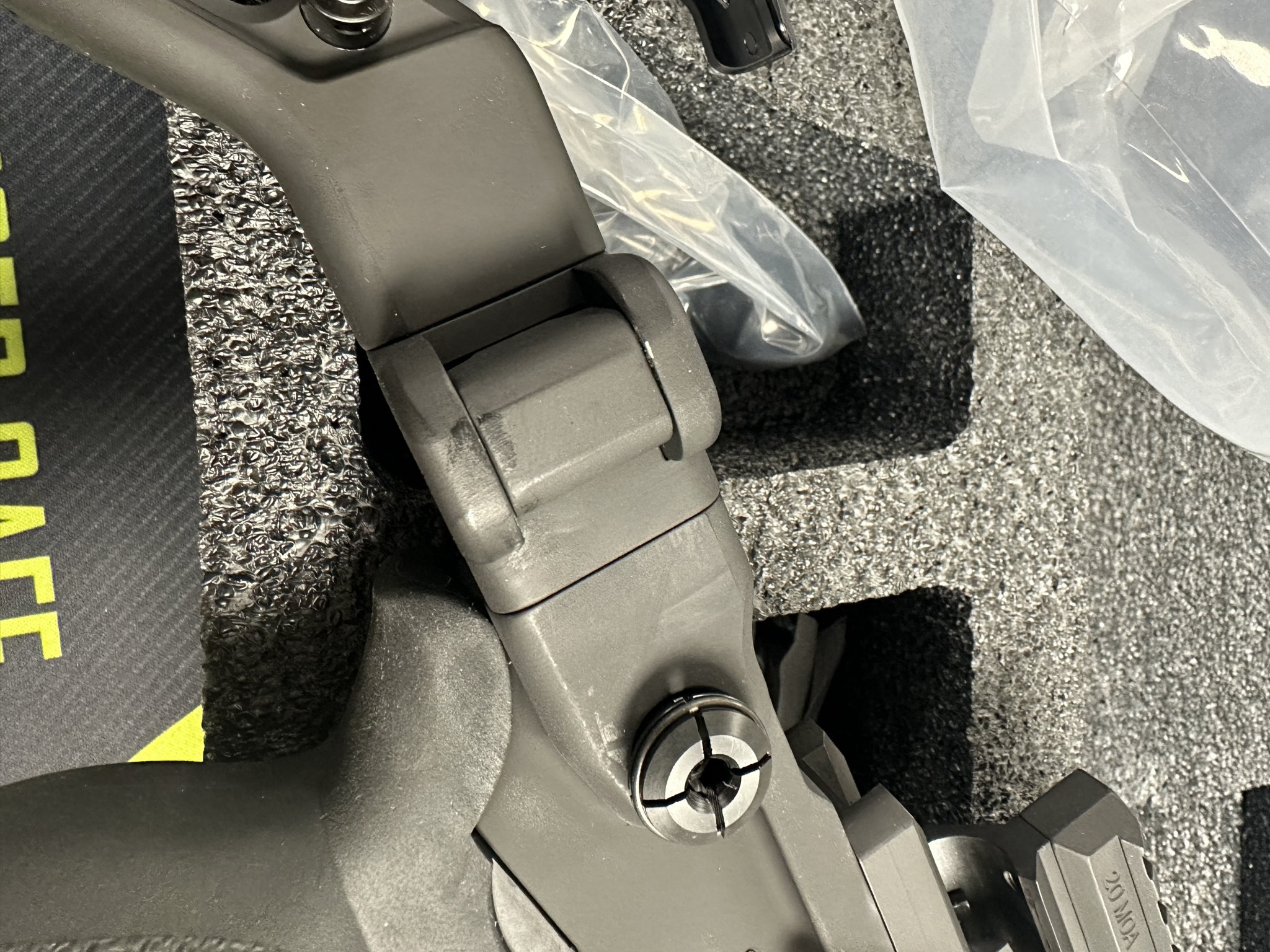

Lastly, and most importantly, in looking at pictures of AXSR online, I noticed that the relief vent for gas escape has an orange indicator whereas mine does not. I am not sure what to make of this.
For reference I am very new to the bolt action platform and this is my first AI, and second bolt gun.
I appreciate your patience and kindness. Thanks in advance.

I am more concerned about those relief ports more than anything else.

AI changed the blowout port covers from red to black in 2021 at some point, no issue there.
If you bought that as a new rifle though I would be calling whoever sold it to you. The wear on that gun is nothing that would’ve happened at the factory.
Thanks, I’ve reached out to the dealer see what he is going to do about it. Relieved to hear that info about the relief ports.
Yea the black plug is normal now. My ES (#TheOneTrueModernColor) came with a black plug.

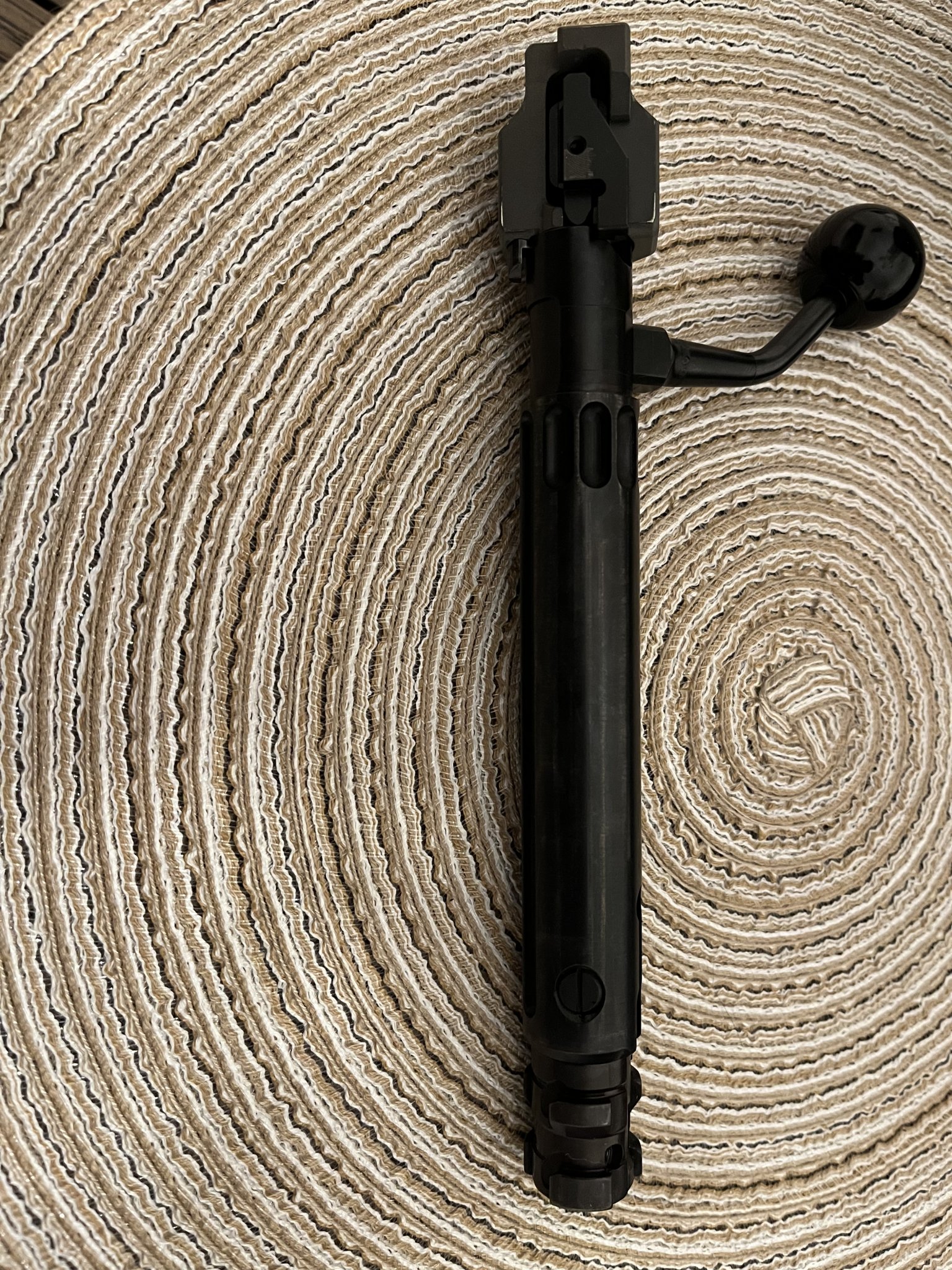

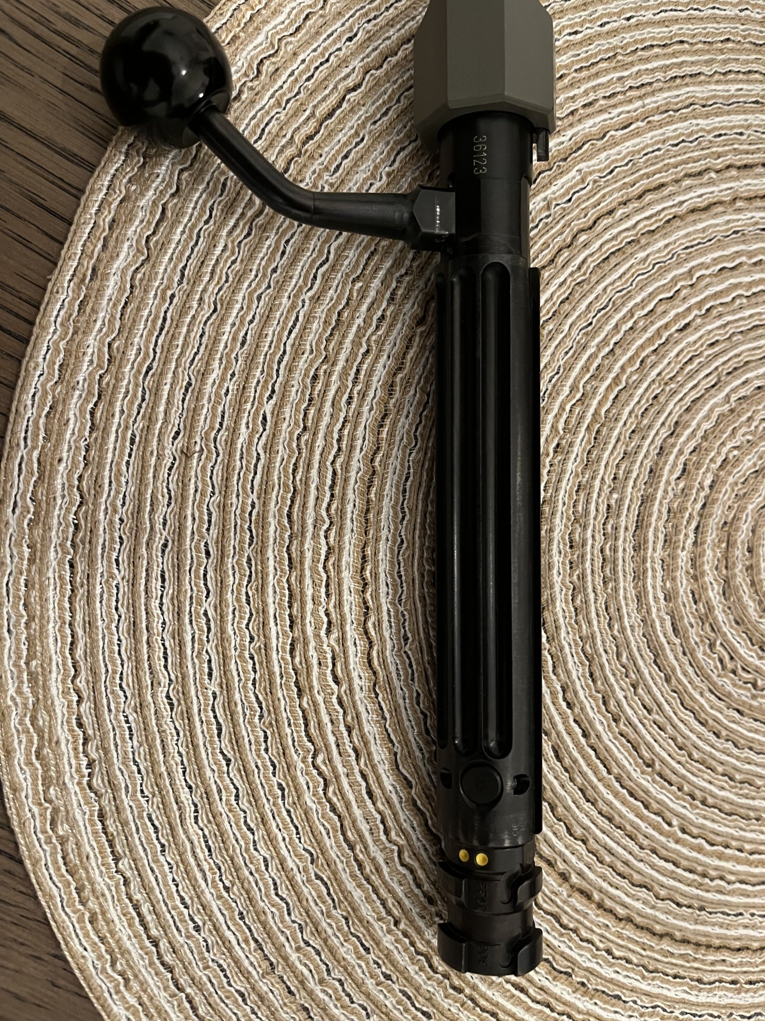

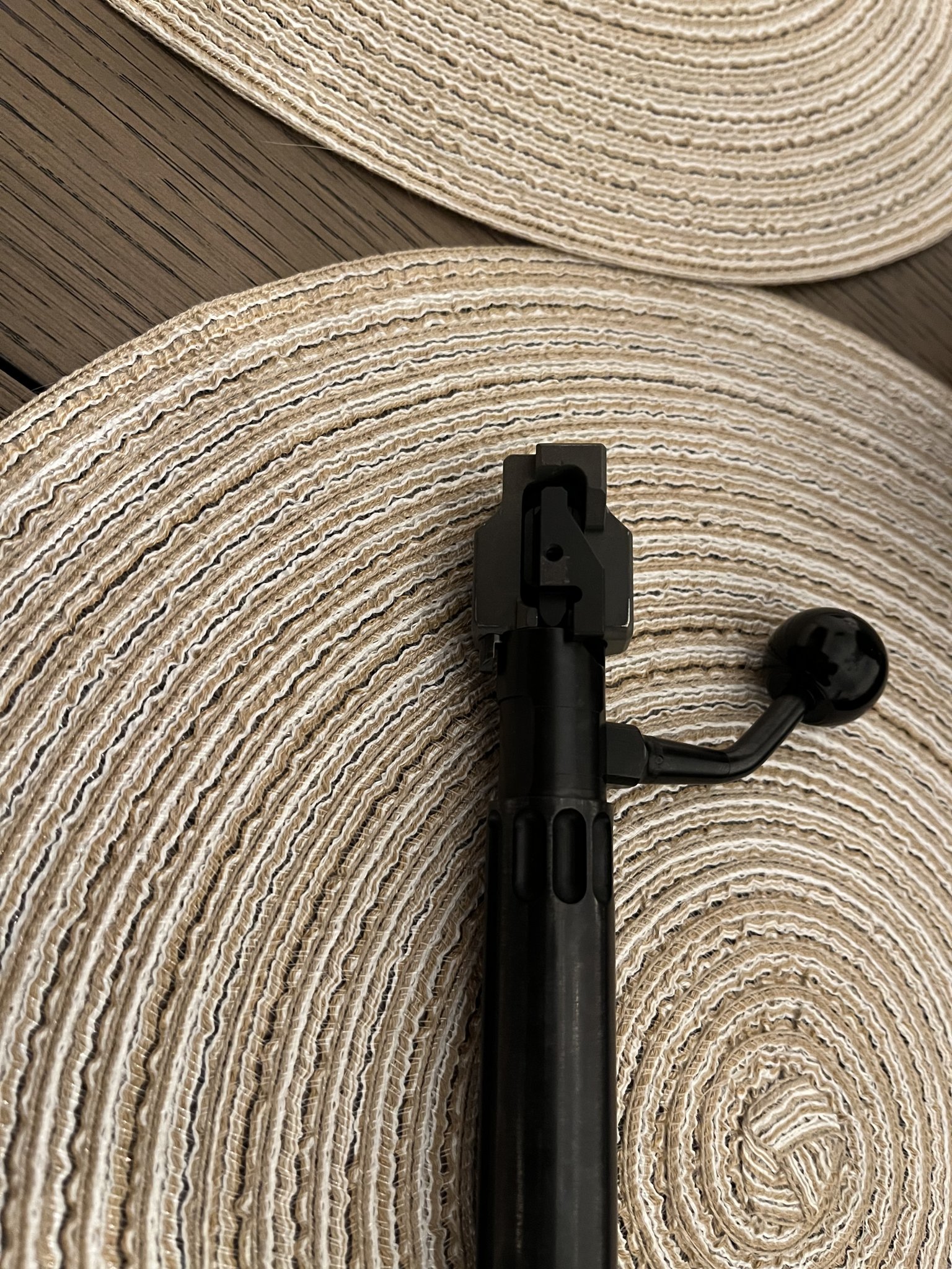

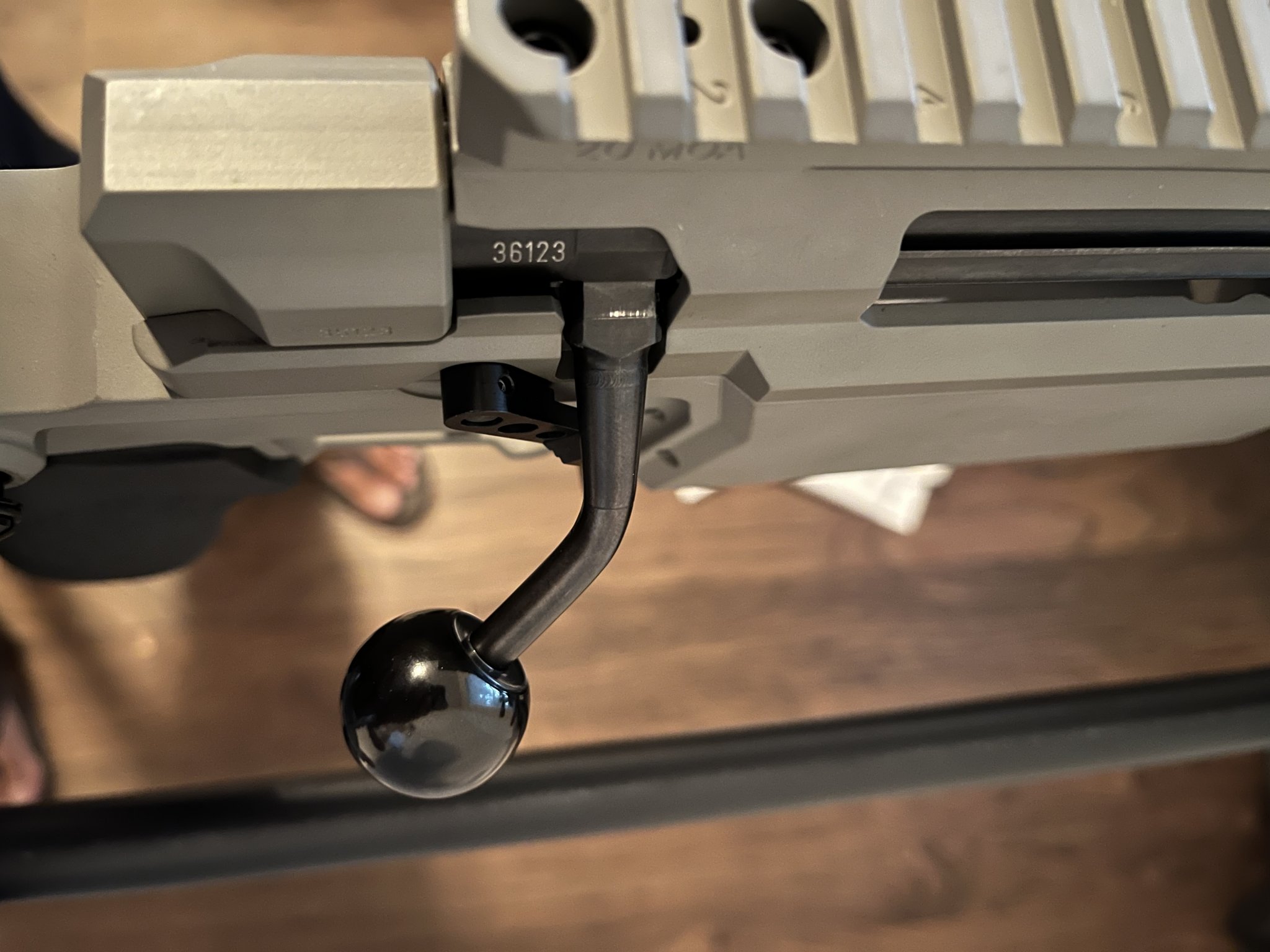

How’s the action? Does it have scratches on the bolt? And does the bolt move smoothly or not? Those scratches on the bolt handle could be from potential customers handling it at their retail store. I mean we all do open the action when we wanna see and handle a weapon at a lgs. I honestly think it’s new, and hasn’t been shot.

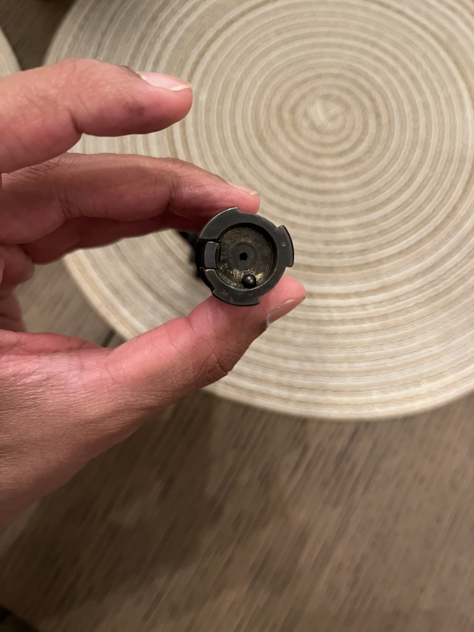

Action seems smooth. Bolt has light drag marks. Face has wear that could be from factory firing, or maybe they fired it. Chamber/bore look OK. This is definitely a demo, may be unfired, but definitely handled.
Maybe post some pics of the bolt. Others here may chime in after as well.
Don’t want to jump into any accusations, but it does look like something going on by the looks of that bolt face.
Maybe send those pictures to EO. Hopefully they’ll help you out.

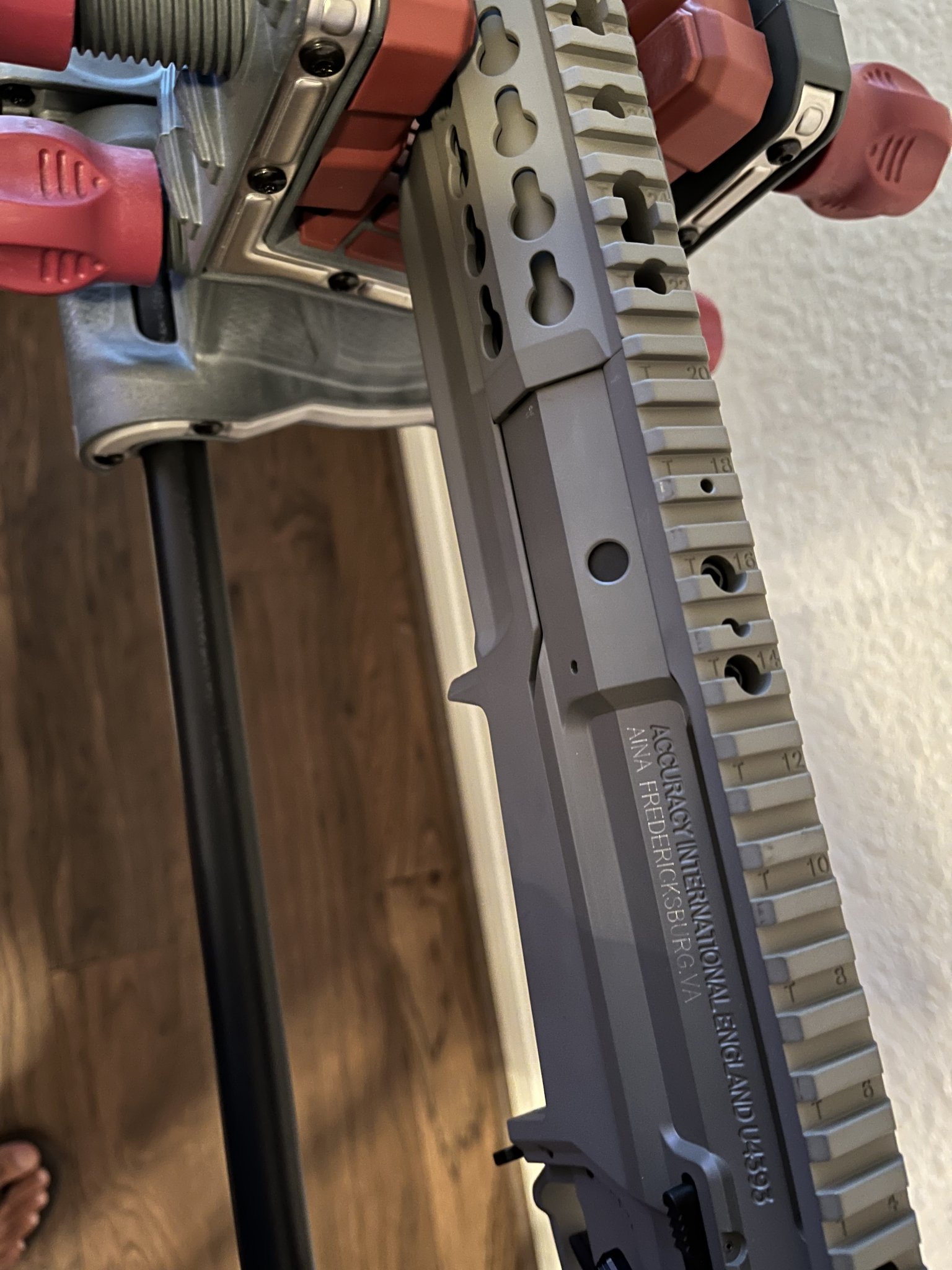

Well I would have been upset if mine had showed up like that... I agree with @Rhed on the boltface.

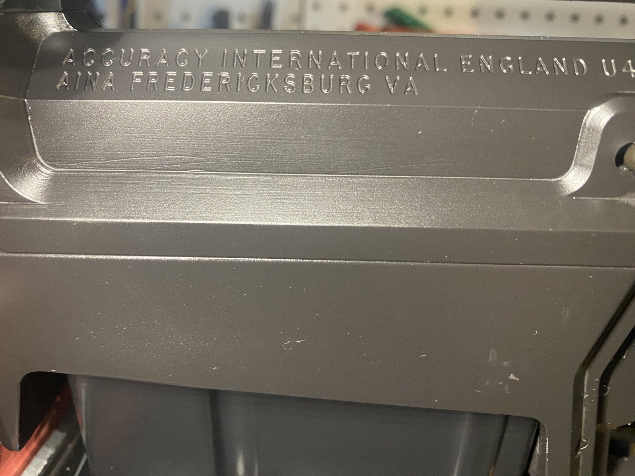

And wtf is up with the "Ana Fredericksburg" lettering looking like it wasnt cerakoted???

Every rifle is test fired before it leaves AI, so some slight wear present is normal. Some are test fired more than others. That bolt is used but doesn’t look like it was cycled more than maybe 30-40 times though. The wear on the bottom of the cocking piece is pretty typical of that.
You might raise a question on the amount of brass the ejector is shaving but it’s not uncommon for new ones to have to break in. My .308 bolt ejector scarred the shit out of brass for the first 200 rounds or so.
The AINA engraving is an import mark which gets applied post-cerakote here in the states. All are like that.

Pretty typical to have markings on these. Mostly from shipping. Some better, some worse. Brass shavings on the bolt face and carbon on crown of barrel and in bore are always there. They shoot this guns at least 10 rounds before leaving. I've seen little things like the Allen wrenches in the trigger package come out and lodge in the foam having the rifle rub against it. Thread protectors off and rattling around in the box. You name it, but most of this stuff is from shipping.
Mile High takes them out now, puts it in a tripod or on a bench with ARCA clamp and is visually inspecting every gun now. So if you have marks on ARCA rails like someone had used it, that's what it's from.
The small scratches and superficial marks in cerakote in a lot of places is usually because the cerakote is so flat now. Referencing the area in the OPs pics above the grip. That is very minimal from what I've seen. Mostly DE guns and newer ES guns is where I see it. That foam is a little course and after riding and rubbing in the back of a UPS truck for a total of weeks will leave those marks.
The very latest guns are now shipping in plastic bags inside the foam cutouts like they used to do.
Bolt is 100% normal. Only thing that I see here on three top of the action rail that may be out of the typical items I see. Ports went from red to black as early as 2020 guns pending caliber and timing. I've had 20s with Red and also black.
I get folks are very picky when spending this kind of coin, as I am also. But assembling and testing these with function checking after the cerakote is done, always shows some wear.
Pretty typical to have markings on these. Mostly from shipping. Some better, some worse. Brass shavings on the bolt face and carbon on crown of barrel and in chamber are always there. They shoot this guns at least 10 rounds before leaving. I've seen little things like the Allen wrenches in the trigger package come out and lodge in the foam having the rifle rub against it. Thread protectors off and rattling around in the box. You name it, but most of this stuff is from shipping.
Are they now mounting scopes for test firing? I guess it could just be marks from shipping, but given the totality of the condition, it is very suspect.
Not that I'm aware of. Most of the black anodized action rails you won't ever be able to tell of they did. On the AX and SR rifles typically any clamping force on the cerakote will leave some sort of mark, even if it's mounted at 10 inch pounds. EO isn't opening all these guns and messing with them either. Unless it's a DEMO and stated as such, these guns are not touched or boxes even opened since they left AI.

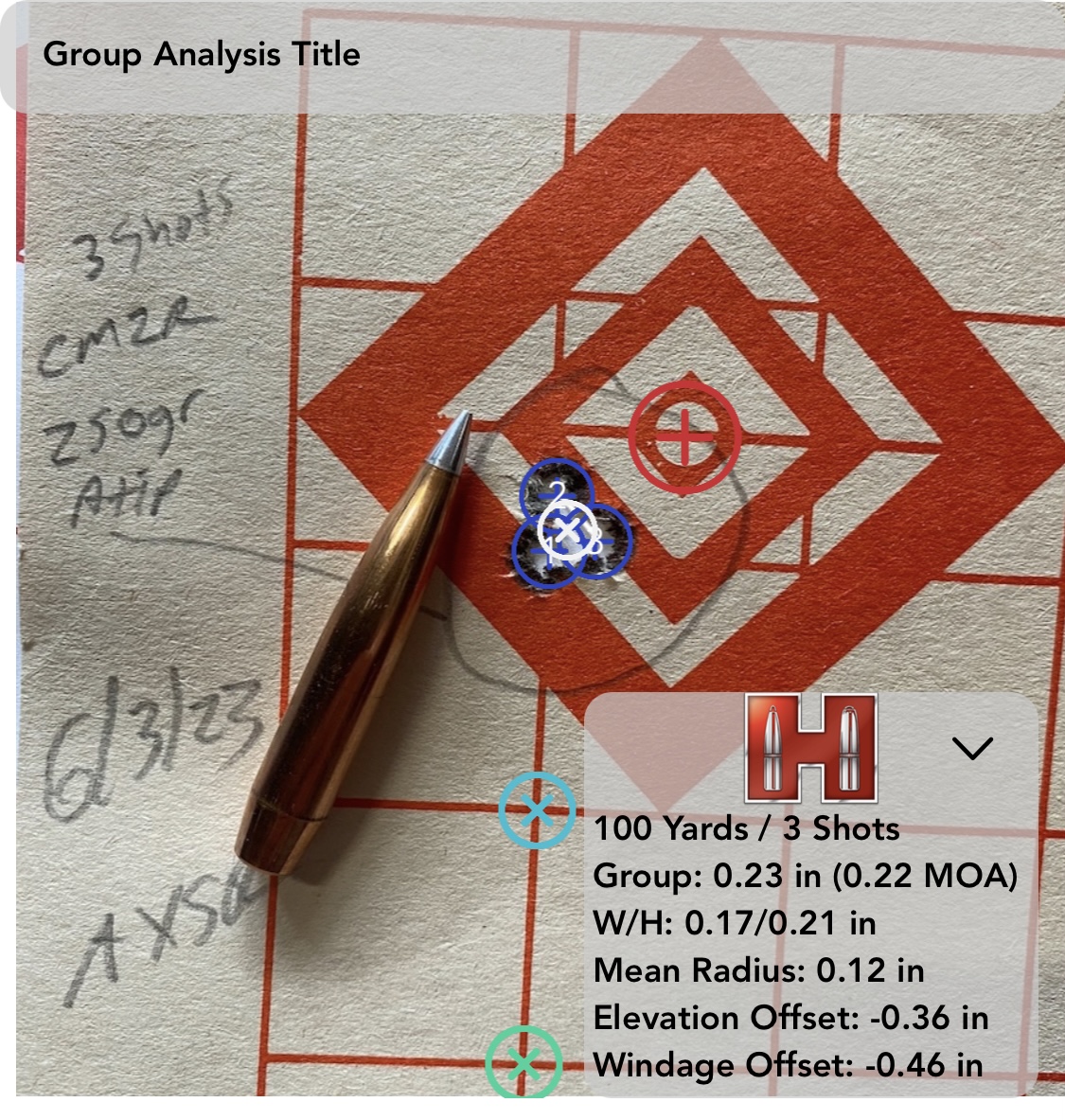

For further transparency to the OP and clarity to those thinking we like to ship used guns as new:
The rifle in question arrived from AI on 5/22/23 and left our warehouse on 6/2/23 and was indeed never on display in the showroom.
Additionally, AINA does have to mount scopes on these to test-fire for group, so there will always be evidence of this if you rifle has a pic rail on it.

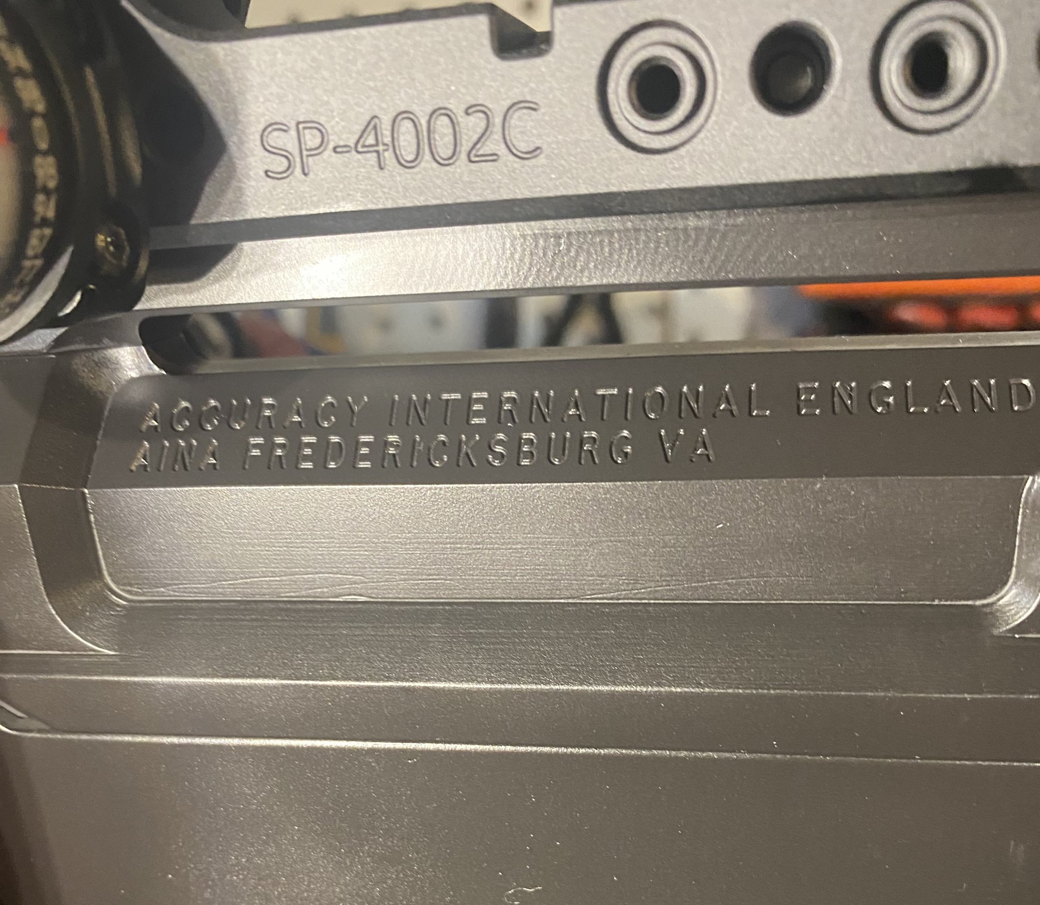

I've bought several items from europtic that were "like new demo" models including my axsa and a schmidt and bender pmii and they both looked brand new. My axsa arrived in better condition than the ops photos. If I was better at life and had more money I'd grab the axsr they have as a like new demo in 338 right now.

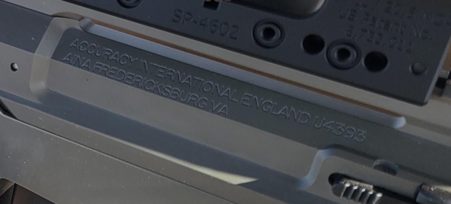

Is that something that began recently? Because that is not the case with mine.
The vast majority of AI’s are etched like OP’s. My AXSA and AXMC were marked that way too.
Pretty sure the first year or two of SR’s are like yours but they switched back. Mines actually marked the same as yours lol. Sorry, should’ve been more clear

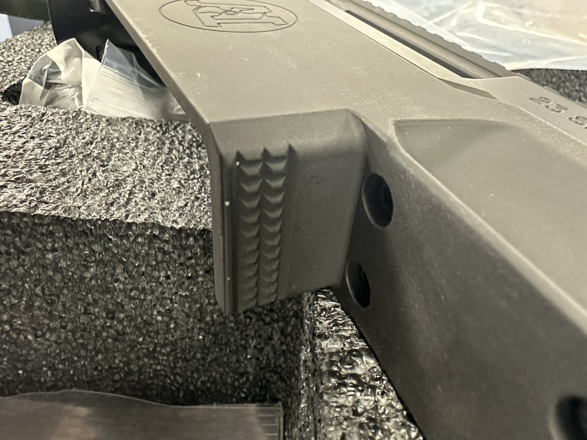

I cut mine out of the sealed bag it was shipped in from the UK to Canada (AXMC) and was able to pick the rifle apart. The quick lock tensioning screw head was stripped. Looked like someone had an Allen key in only about 1/16” and tried to torque it and stripped the hex head. Looks more like a smeared circle than a hex. That’s okay, send it on to the customer. I’ve been trying to get a replacement screw for years now but keep getting nowhere. A few other flaws in the fitment of the components too but it just makes it easier to shoot the thing and add some wear and tear of my own. For the price none of the flaws should be there. It’s the world we live in though.
Let me add to this... I've owned a AXSR from I think 2021 or 2022. I recently bought another one and the finish is completely different. I got it from EO. Rifles came with some dings too, I'm getting a replacement, if the new rifles are all in that condition I might just completely take a different route... I know it's a gun a bla bla bla, but I expect more from product on this price range. I was considering a second ELR but if this is the theme from AI I probably skip it too and venture somewhere else...
Got a SR recently also has marks all over it. The flat cerakote scratches very easily. Other AI's I've purchased from EO AT&SA, also have flaws throughout including replacement barrels and mags.

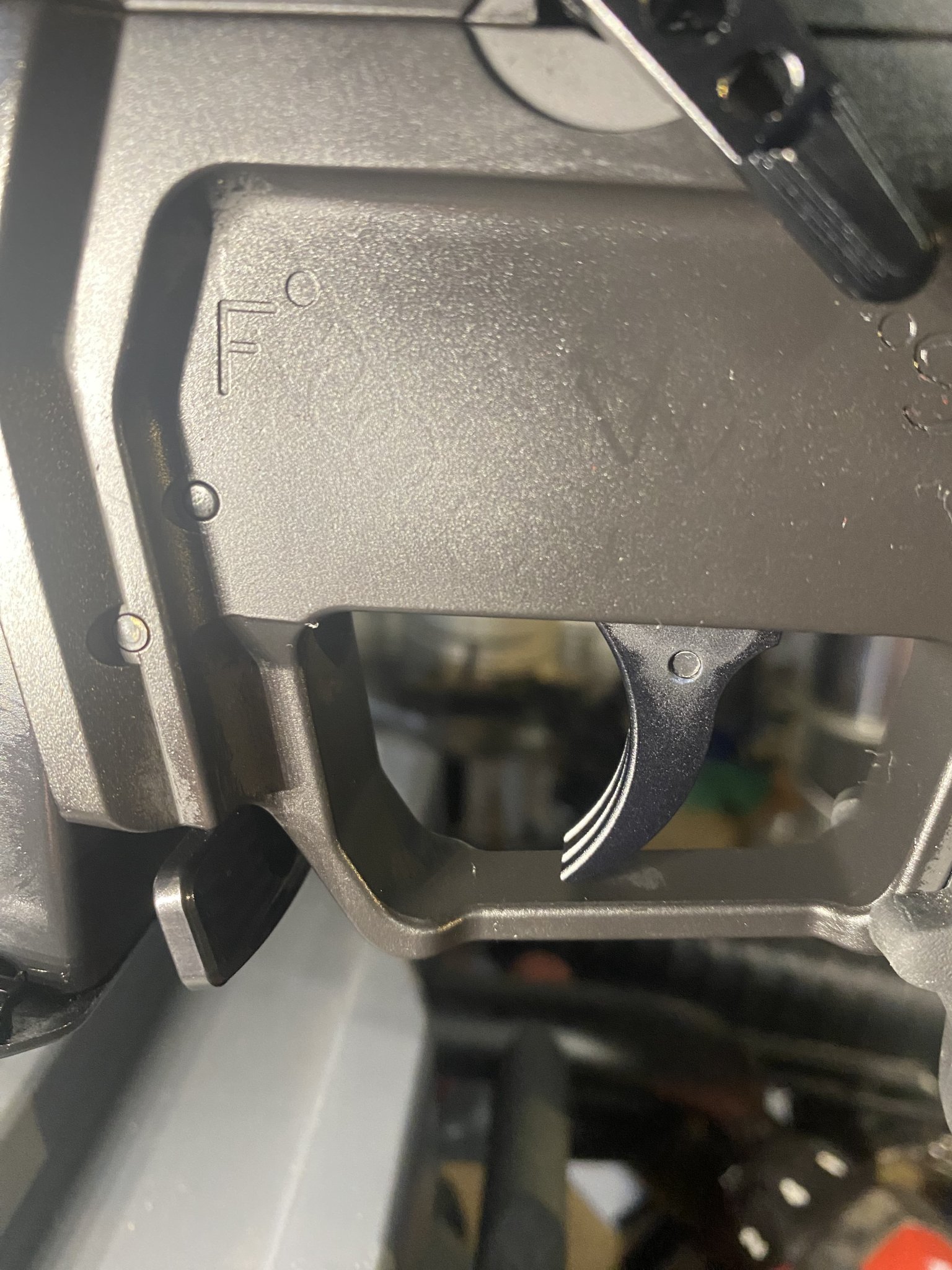

Not to hijack a thread but since we are talking about it. I Have an AXSR made in 22, purchased from an authorized distributor new. I noticed what seem to be slight tooling marks (?) under the cerakote on the left side of the receiver. I only picked it up in the right light, curse my ocd. Additionally, noticed these little circles on the left side of the frame. I have never seen another axsr in the wild so idk what is normal or not. Thanks for listening.
